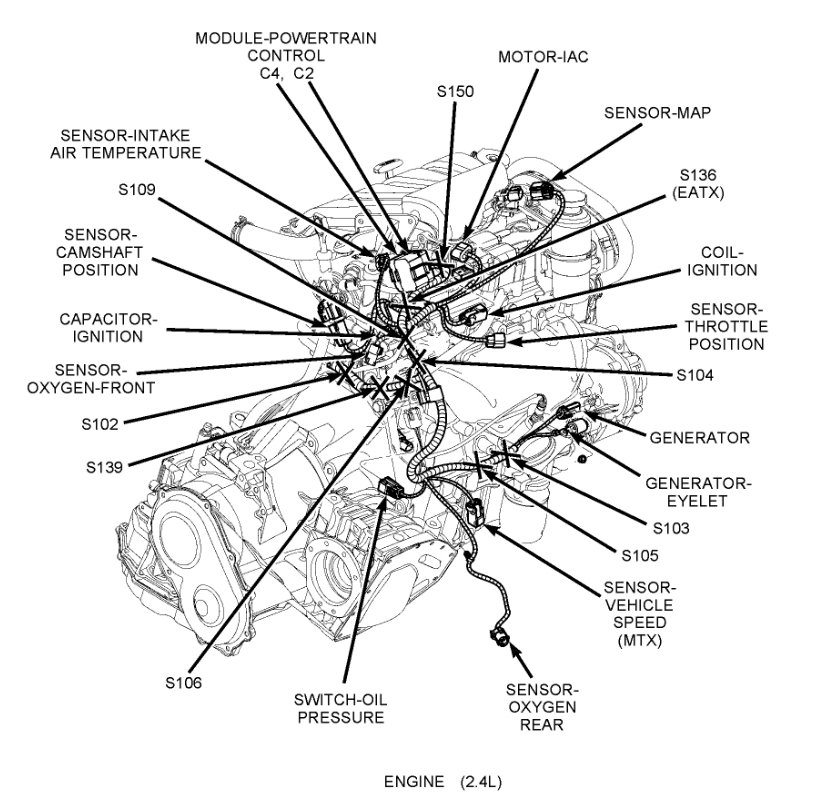

What is the brand name of the pump you bought? Cheap fuel pumps do not supply the pressure needed for good starts and acceleration. But to be sure we can check the fuel pump pressure by following this guide and you can rent a pressure gauge from the auto part store for cheap.
Fuel System Pressure
400 kpa ± 34 kpa (58 psi ± 5 PSI)
Also, we should run the codes even if there is no check engine light on.
I have seen a MAP sensor that is a little off cause this issue as well. Make sure the air filter is clean as well.
Check out the images (below). Please let us know what you find. We are interested to see what it is.
