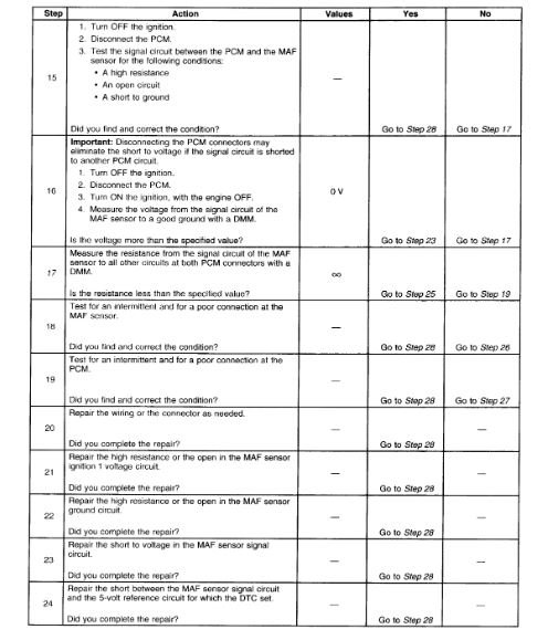

In park at idle and at stop signs or stop lights. Po102, 108, 102 history, 108 history, 300, 620 history, 1106 interm (po108 mil.req.). other codes doesn't have mil req.
Oct 20, 2019 at 8:28 PM
Good morning,

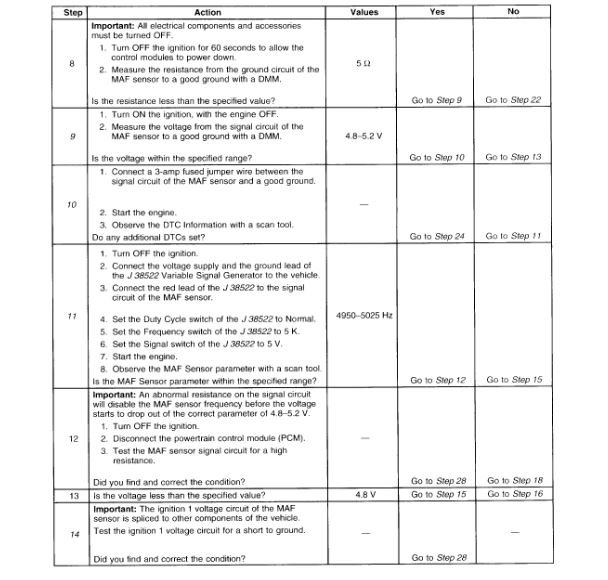

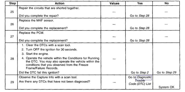

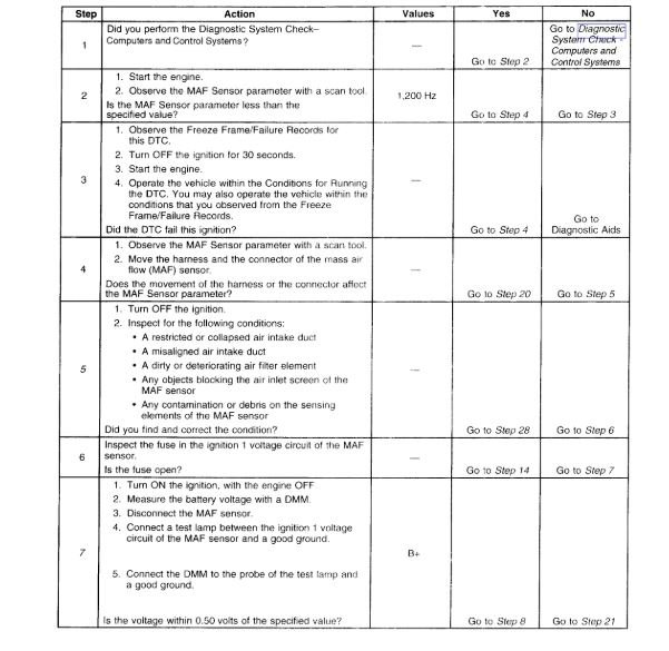

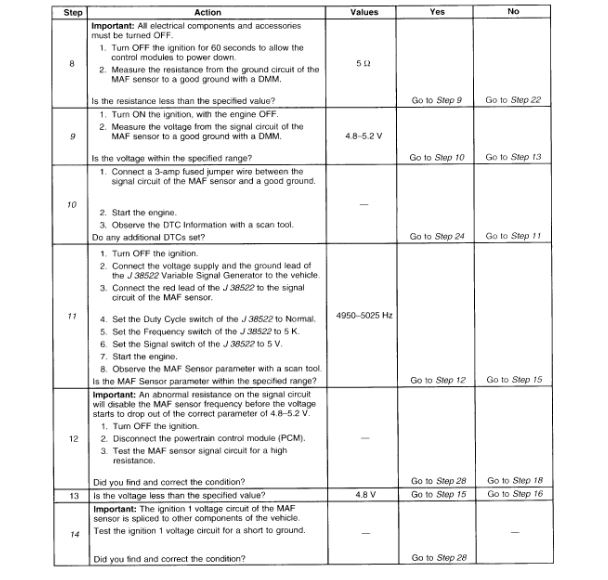

The 102 is based around the mass airflow sensor. Make sure the connector is tight and there are no air leaks to the throttle body.

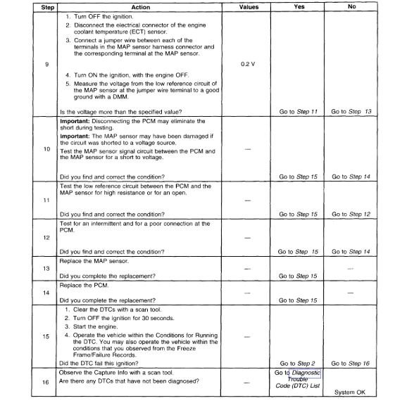

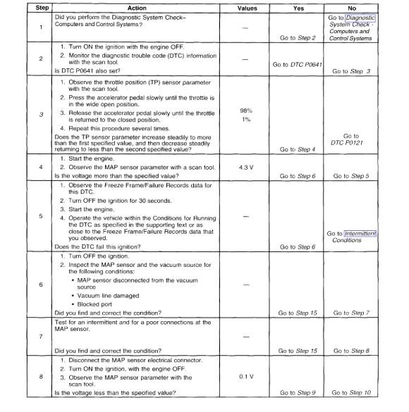

The 108 is for the MAP sensor. This could be a vacuum leak to the sensor. Make sure all the lines are in good shape and not cracked or broken.
The 620 is for PCM controlling the generator circuit of the alternator. I posted information below about that one.
The 300 is a misfire code. I attached a guide for you for that. Make sure the plugs and wires are in good condition and make sure the fuel pressure is correct.
