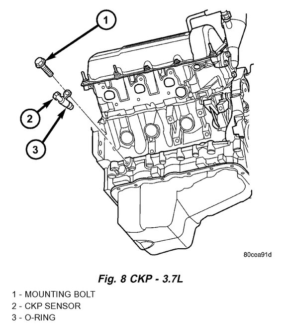

I drive approx 10 minutes to work and about the time I get to a parking space it stalls. It doesn't restart at this point. After work (10 hours) it starts right up and gets me home.
Check engine light doesn't come on or any other warning lights. It isn't all the time, just here and there. I took it to the shop to get a diagnostic and they said it does have a small intake leak but they aren't confident that this is the issue as they couldn't get it to stall.
Today after work I went to the store, was in there maybe 10 minutes. It started and stalled but finally started in neutral and I was able to drive home.
Help please!

It sounds like a bad crankshaft position sensor. When they get hot, they can fail. Take a look at these links:

Here are the directions specific to your vehicle:
__________________________________________
2003 Jeep Truck Liberty 2WD V6-3.7L VIN K
Procedures
Vehicle Powertrain Management Sensors and Switches - Powertrain Management Sensors and Switches - Computers and Control Systems Crankshaft Position Sensor Service and Repair Procedures
PROCEDURES
REMOVAL
Fig.8 CKP - 3.7L
pic 1
The Crankshaft Position (CKP) sensor is mounted into the right rear side of the cylinder block. It is positioned and bolted into a machined hole.
1. Raise vehicle.
2. Disconnect sensor electrical connector.
3. Remove sensor mounting bolt.
4. Carefully remove sensor from cylinder block in a rocking and twisting action.
5. Check condition of sensor O-ring.
INSTALLATION
1. Clean out machined hole in engine block.
2. Apply a small amount of engine oil to sensor O-ring.
3. Install sensor into engine block with a slight rocking and twisting action.
CAUTION: Before tightening sensor mounting bolt, be sure sensor is completely flush to cylinder block. If sensor is not flush, damage to sensor mounting tang may result.
4. Install mounting bolt and tighten to 28 Nm (21 ft. lbs.) torque.
5. Connect electrical connector to sensor.
6. Lower vehicle.

Honestly, in most cases the engine light would come on. However, there are conditions related to a bad crankshaft sensor that will prevent it from turning on. The best thing to do is this. If you have a live data scanner, check to see if there is an RPM signal when it won't start. Or, check to see if there is spark to the plugs when this happens.
If there is no spark or no rpm signal, my first suspect would be the sensor I mentioned.
Here is a link that explains how to check for spark:
Now, the coolant issue is a concern. Also, if the intake is leaking, you should be able to see it along where it mounts to the engine. Also, if it has a rough idle there could be a vacuum leak. Check that too,

How important is the torque for this sensor bolt? I'm having one heck of a time getting a torque wrench up in there.

Just make sure it is tight. If it isn't exactly 21 ft/lbs don't worry.

Thank you! It's all good, I so appreciate your help! It was the crankshaft position sensor! Got it changed yesturday and not even a slight hesitation since!

So yesterday on my way home from work my vehicle stalled again just like before. This was the first time since I changed the crankshaft sensor. This morning it seems to be fine but that is how all of this started a couple weeks before I posted on here. I have read that most change the camshaft sensor at the same time. Could that need to be done or is there a reason the crankshaft sensor could go bad in two weeks time? I actually have tomorrow off work so I have time to work on this tonight/tomorrow before things get worse again. Any help on this is greatly appreciated!
