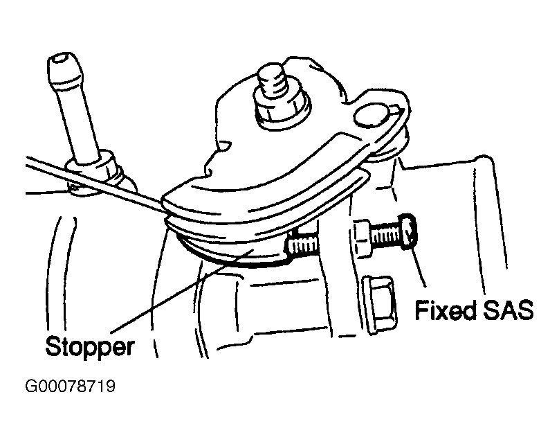

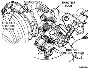

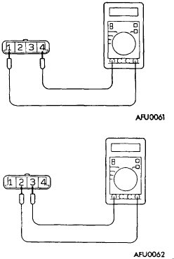

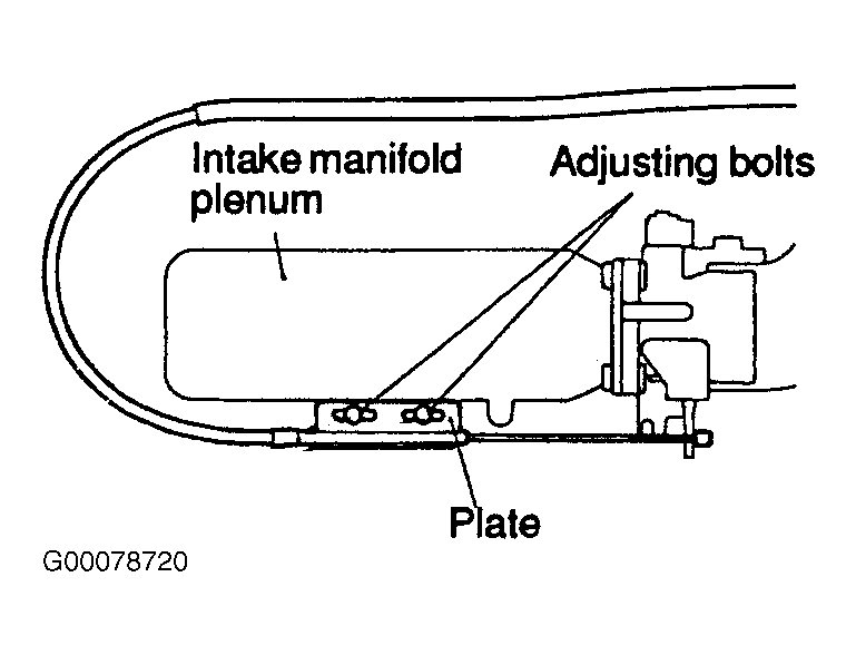

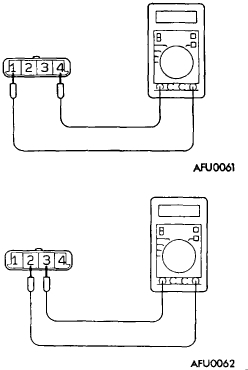

Here are the directions for checking the IAC / see pic 1. Also, the IAC is located on the throttle body. See Pic 2.
Disconnect the idle air control motor connector.
Measure the resistance between terminal 1 and terminal 4 of the connector at the idle air control motor side. Standard value: 38-52 ohms [at 2O°C (68°F)]
Measure the resistance between terminal 2 and terminal 3 of the connector at the idle air control motor side. Standard value: 38-52 ohms [at 2O°C (68°F)]

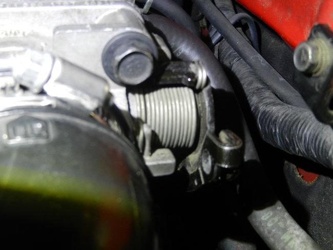

Thanks for the information. I was going to either try to clean or replace the IAC but with one of the screws buried behind the IAC I was afraid that if I did get it removed I would have a very difficult time putting it back in. I also tried to take off the throttle body but had a difficult time trying to remove the accelerator cable. If you have any tricks to getting either of these done please let me know. Also, when the vehicle is still cold and after I get going upon acceleration the vehicle with surge badly at times. I am not sure if it is the same problem or if it the transmission getting ready to go. I changed the fluid recently and the transmission is shifting smoothly and not slipping but like I said when it is cold it will surge at times.

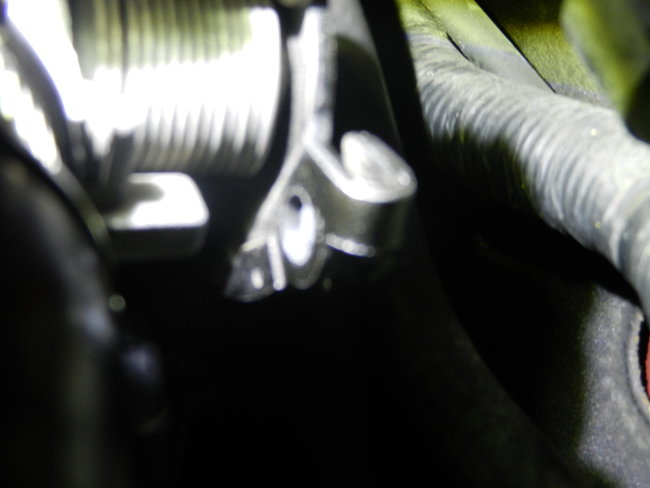

If the transmission is not slipping and is shifting properly, I do not think that is the problem. Have you checked the items I originally mentioned? As far as the screws you are having trouble with, can you upload a picture so I can see what you are dealing with? I do not recall having any issues in the past, so you have me stumped. LOL

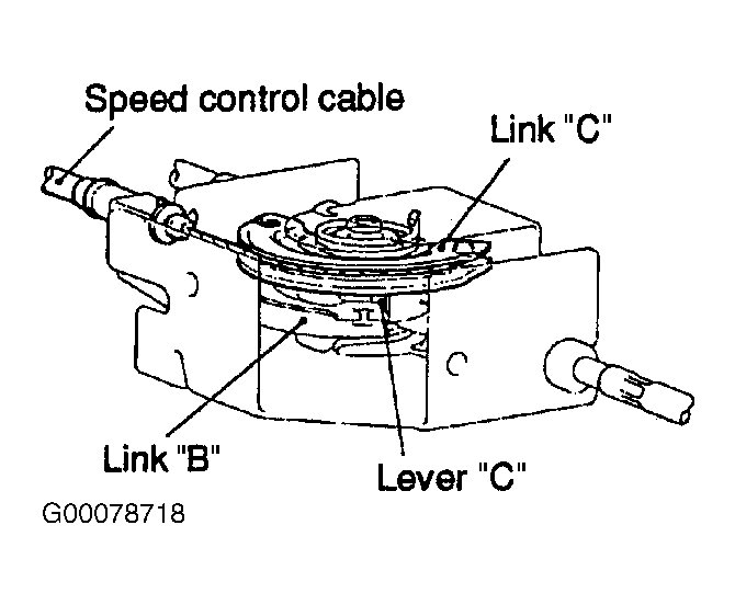

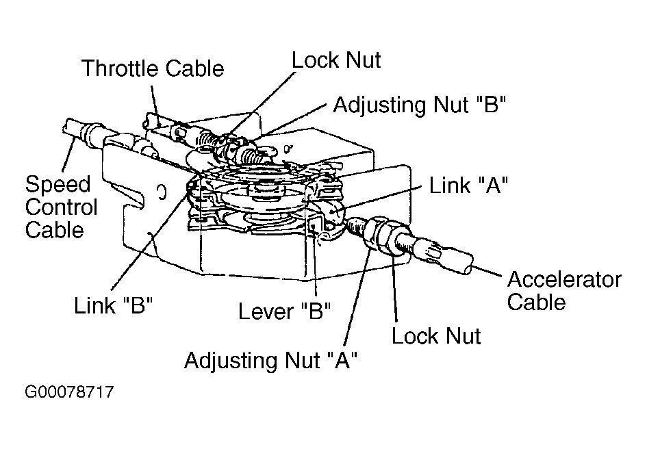

As far as the throttle cable, I have attached all the pics I have for you to review. There is a throttle cable, and if the car has cruise control, there is a cable. To remove the cable, with the engine off, manually open the throttle the entire way. Swing the cable downward toward the opening on the throttle and slid the retainer out. See pictures:

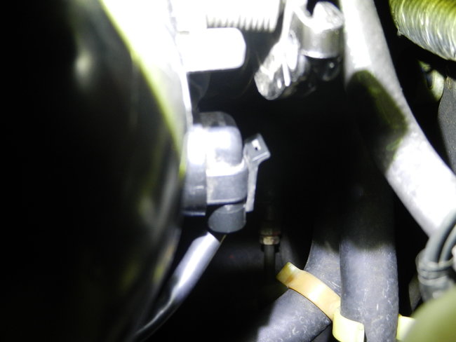

I do not think it is the timing belt as I had that replaced a while back. I did replace the TPS switch but that did not help. The vehicle does have cruise control on it but I only see one cable attached to the throttle body, but since the throttle body is real close to the firewall I may be missing it. Just like when I was going to try to flush my heater core and found that the hoses are lower on the firewall I decided to wait on that until it gets cold again. Anyhow, I have attached some pictures of my throttle body. If you have any other information please let me know.

First I would remove the throttle body to clean it because it is the backside of the throttle plate that needs to be spotless. We need to run the code to see what comes up as well.
