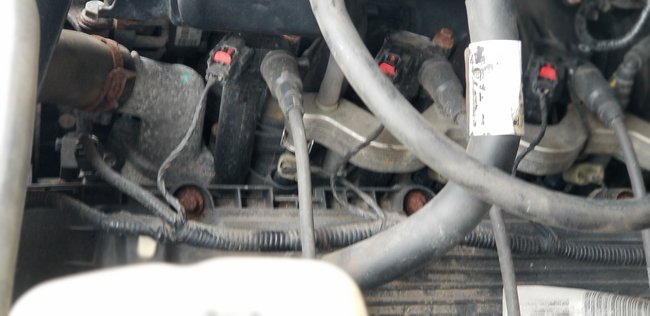

neither of the pictures you sent me are my engine.

The engine in the pic doesn't look like it. VIN: 1ft7w2b62ceb19234
Apr 21, 2020 at 4:32 AM
Okay, that is the engine I have been working with.
Can you post some pictures for me to view of the engine?
