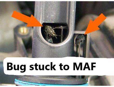

Also check the mass airflow sensor for contaminants, I've had several come in on the hook like this and had a bug stuck to the mass airflow sensor. Also bad intake gaskets can do that, just pour a little water over the intake and listen for the slurping sound, this only works when the leak is huge though.

I have cleaned the throttle body and MAF. no change. no intake leak. it runs fine until 165 degrees. temperature sensor seems okay, it showed 46 today and 51 on the dash. once the truck has worked it runs fine and will not stall again. vapor purge valve doesn't seem to open until it is warmed up and only shows 48 percent.

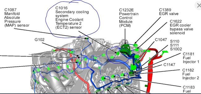

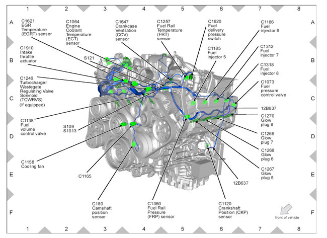

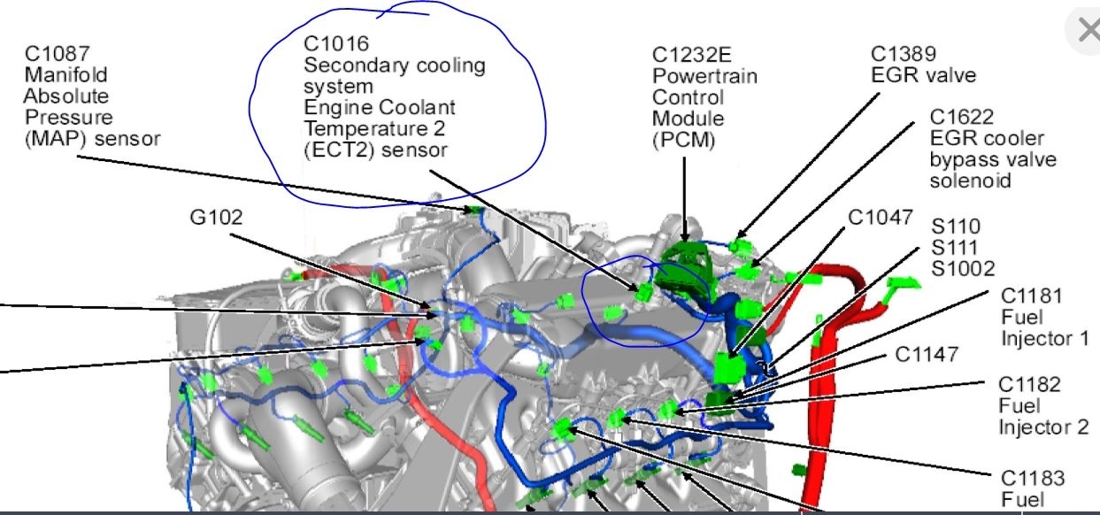

I agree with ASEMASTER6371. This sounds like the engine coolant temperature sensor needs to be replaced. What happens is when it gets warm it can short out/false readings. Lets put it on a scanner to confirm the readings. This guide will help:
Here is the coolant sensor location so you can check it out. Check out the diagrams (below). Please let us know what you find. We are interested to see what it is.
Apr 20, 2020 at 3:28 AM

that is for a diesel. I have a 6.2 has engine.

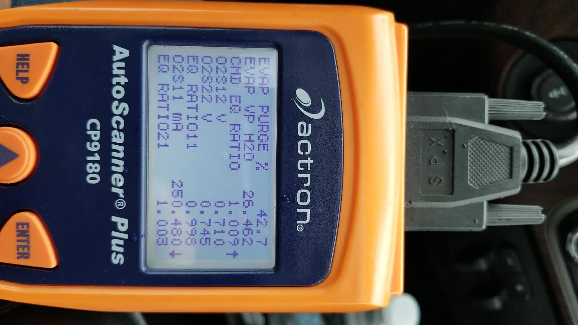

I'll have to recheck tomorrow. it's warmed up now . I don't know if it shows voltage just temperature. It's crazy I am going to change all the o2 sensors and MAF this week. Okay, today I ran it and it stalled at 165. I started it again and the idle was jerky and idled really rough. It stalled again. Restarted again but smooth and stalled. Fourth start it stayed running like nothing was wrong. This time I got a pending code p0365. No check engine light. This time I saw purge valve opening earlier then I have seen before.

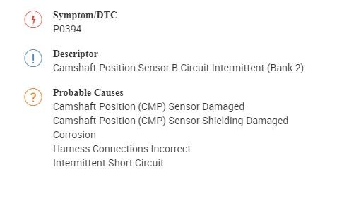

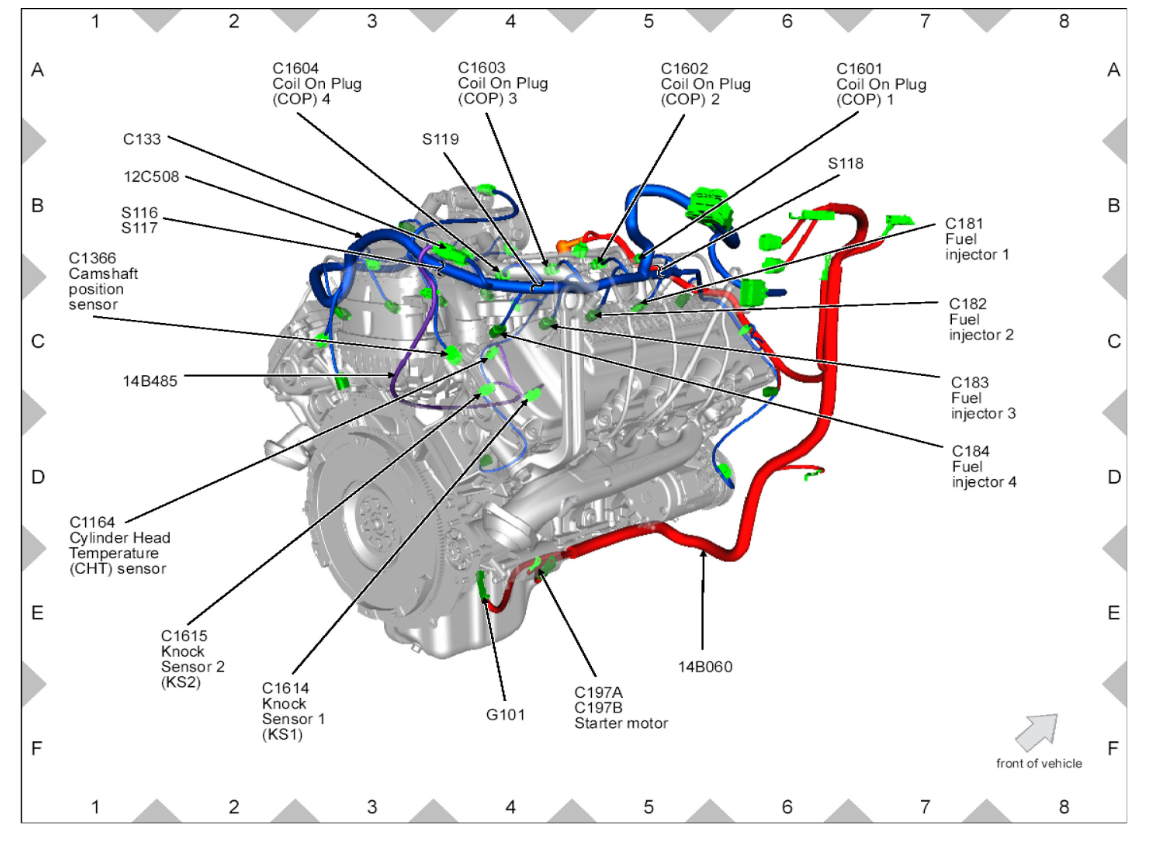

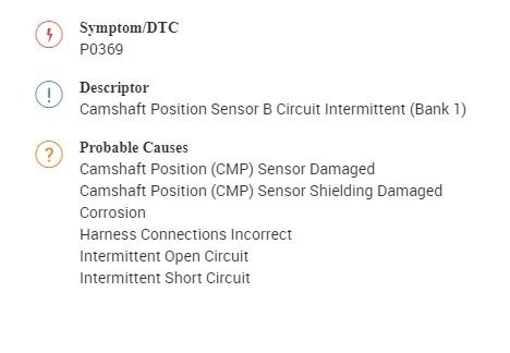

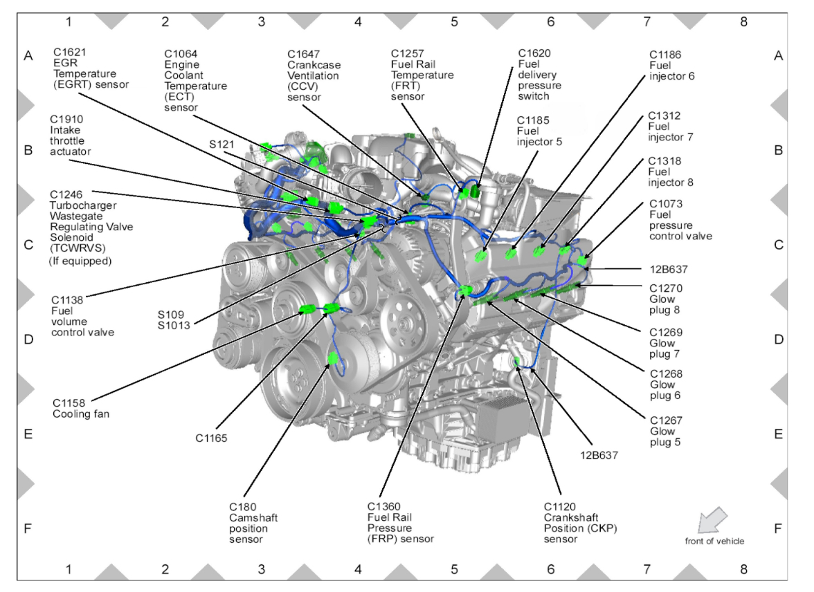

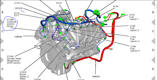

P0365 Camshaft Position Sensor B Circuit Bank 1 - This may cause the issue. Have you replaced the coolant sensor? Here is the camshaft sensor location so you can check it out and replace it if needed. Check out the diagrams (below). Please let us know what you find.

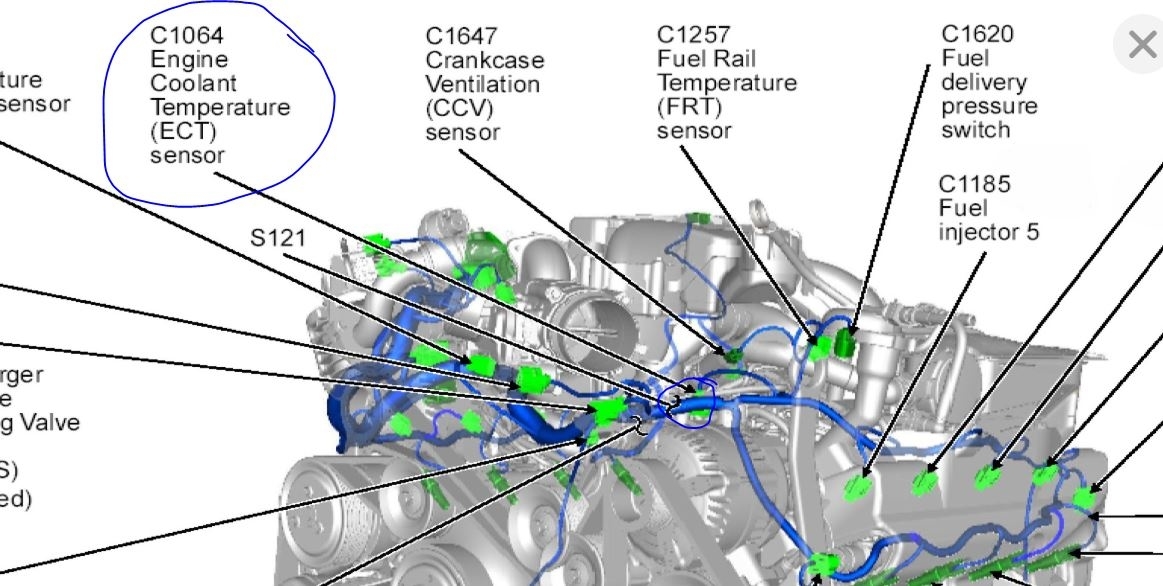

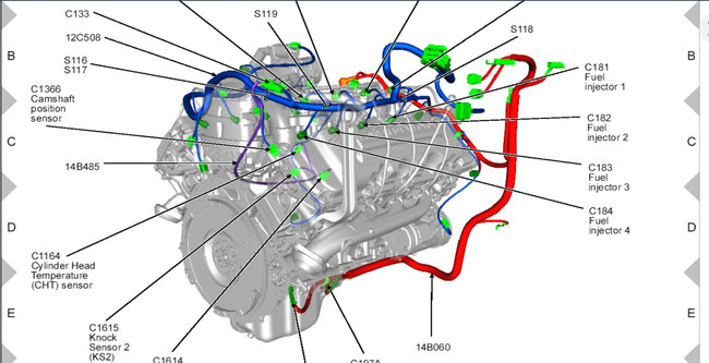

I don't believe I have a coolant sensor. I have a cht sensor under the intake. I just realized there were 4 pending codes a p0369, p0390 and a p0394.
Apr 21, 2020 at 3:44 AM
MRT1963
  • 28 POSTS

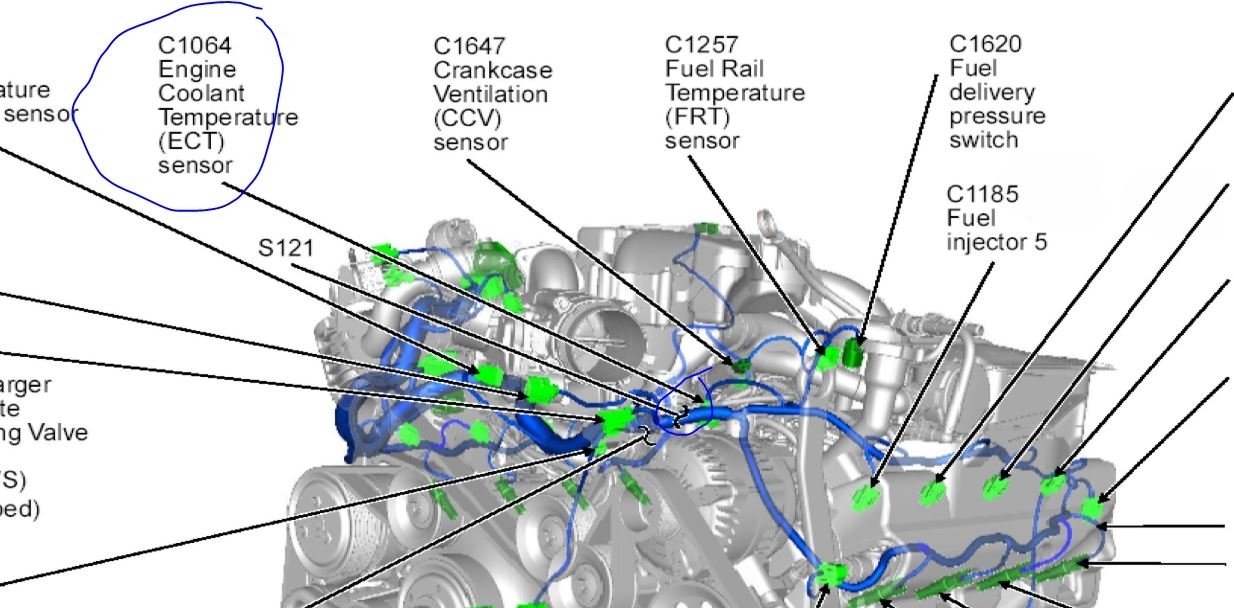

neither of the pictures you sent me are my engine.
Apr 21, 2020 at 3:46 AM

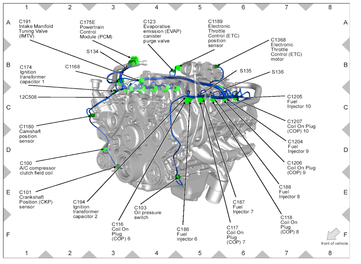

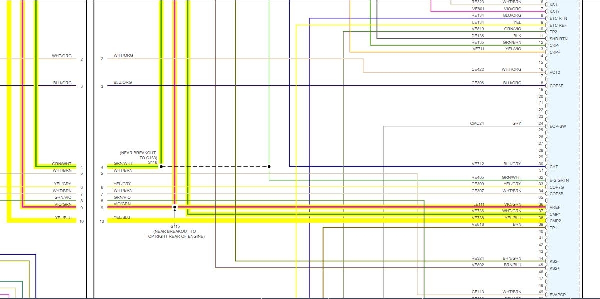

Okay, I attached the coolant sensor locations for you. There are 2 on your engine. I attached locations of both.
I need the information from the scan tool when the issue happens, not when it is running good.'

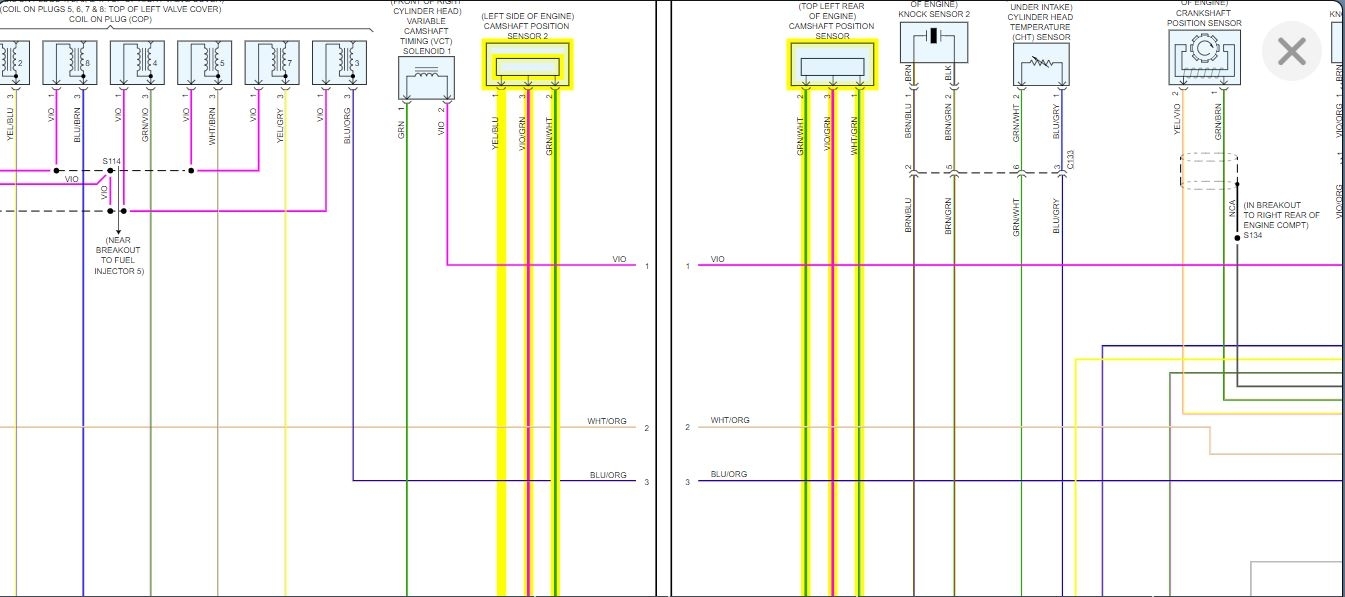

The 369 is for the cam sensor circuit malfunction.
The 390 is for the other cam sensor.
The 394 is another cam circuit code.

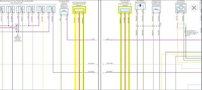

These are circuit codes and the wiring and voltages need to be checked to the sensors.

That is not my engine. I have a 6.2. I just restarted it all codes are gone. I did notice something with my o2 sensor voltage I will send a video. ma voltage is jumping from low to really high.
Apr 21, 2020 at 4:18 AM
All that information is for the 6.2 engine.

  • 28 POSTS
The engine in the pic doesn't look like it. VIN: 1ft7w2b62ceb19234
Apr 21, 2020 at 4:32 AM

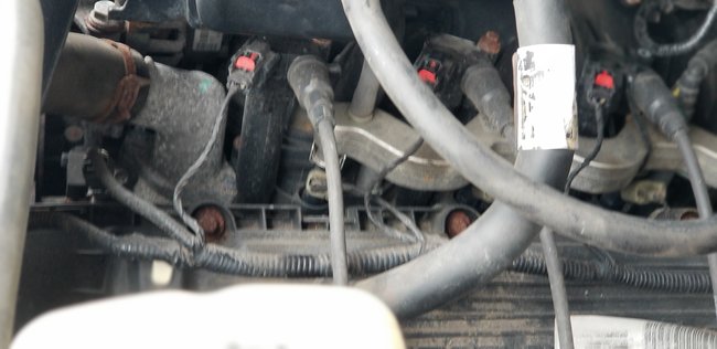

Okay, that is the engine I have been working with.
Can you post some pictures for me to view of the engine?

Did you see the video I sent you of the o2 sensor fluctuating? this only happens after the trucks overnight. once it has warmed up it seems to be fine for the rest of the day.
Apr 21, 2020 at 4:56 AM
Sorry, could barely see the scan tool and could not see any information at all.

the man's were jumping from .625 to 253.457.
Apr 21, 2020 at 5:39 AM

I resent video.
Apr 21, 2020 at 5:40 AM
MRT1963
  • 28 POSTS
I meant Ma's were fluctuating.
Apr 21, 2020 at 5:41 AM
That was the same video that I cannot see any readings at all.
What were the voltages? That is what I requested from you 2 times.
I need all the readings not just the O2 sensor readings.
Apr 21, 2020 at 5:43 AM

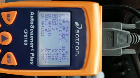

MRT1963
  • 28 POSTS
lower o2 sensor volts .805 to o2s12.090 o2s22 .165then both back to .835. o2s11 ma 26.497 o2s12 ma 61.486 jumping to o2s11 ma 250.480 and o2s11 251.479.one if the uppers will be 246.480 and the other will be 2.499.

I only have coolant temperature not voltage. maf flow gr/se 6.60.

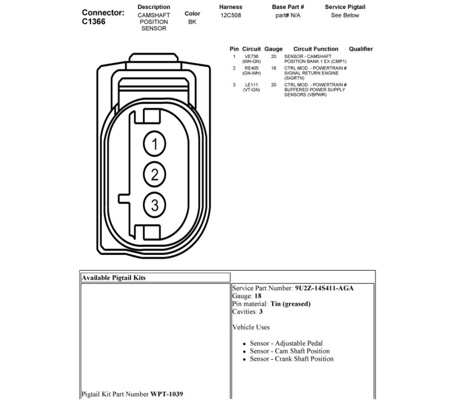

A cam sensor dropping out will cause this issue.
You need to go to the connector on each side and verify 5 volt reference and the signal voltage.

if i keep my foot on the gas pedal it will stay running it is only at idle the RPM's drop. it's like it was shut off. we will check the wiring. thank you.
