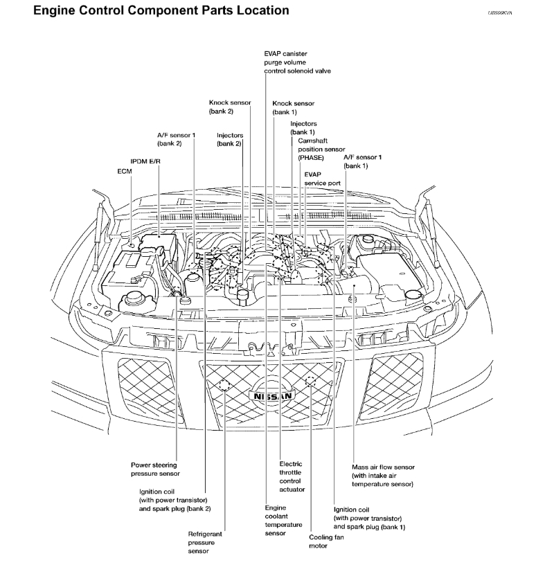

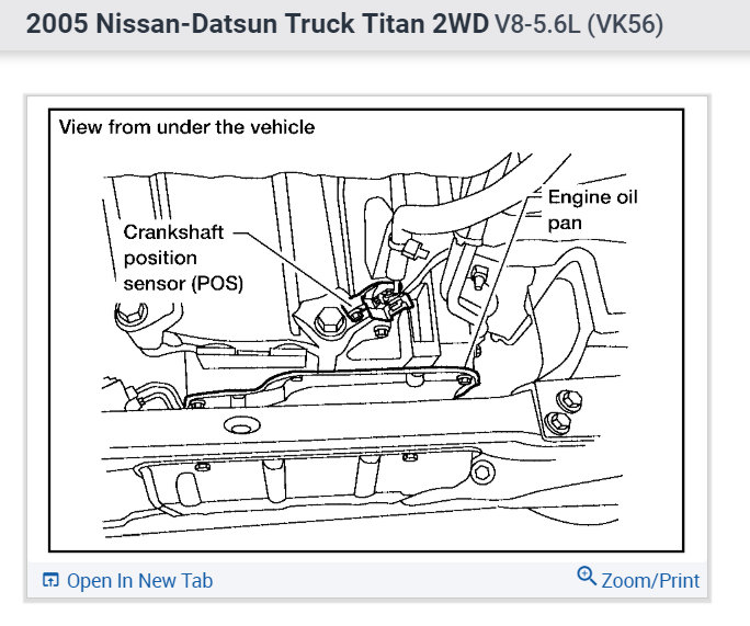

This sounds like you have a crankshaft position sensor that is not working correctly, but we should run the codes to see what comes up. here is a guide:
Here is the crankshaft position sensor location. Check out the diagrams (below). Please let us know what you find. We are interested to see what it is.
