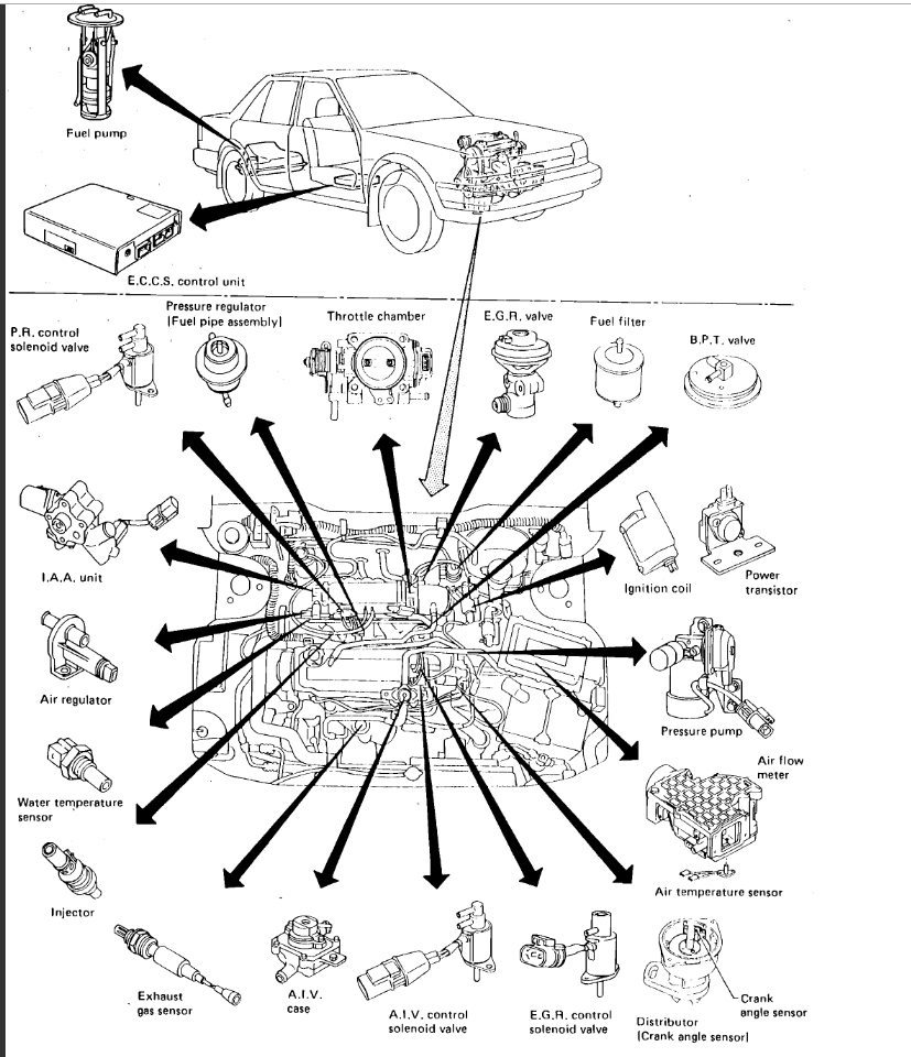

Checked for vacuum, did the squeeze test and sprayed carburetor cleaner on all vacuum connections. aAll checked out good. Where is the coolant temperature sensor ?

Here is the engine coolant temperature sensor location (below):

We figured out the problem. There is oil in the distributor. It is a cam angle sensor type . Is there a seal at the base on the distributor shaft? What is the procedure to repair or replace it?
Jun 23, 2018 at 2:51 AM
  • 55,851 POSTS
There is no seal but the distributor can become worn allow clearance between the shaft and the housing. I would get a rebuilt unit and install it.
