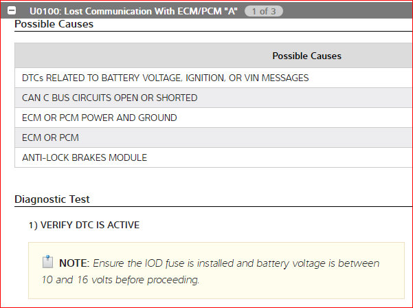

Car stalls give code p0700 and u0100.
Dec 30, 2018 at 8:19 AM
DANNY L
  • 5,648 POSTS

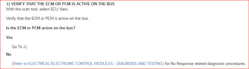

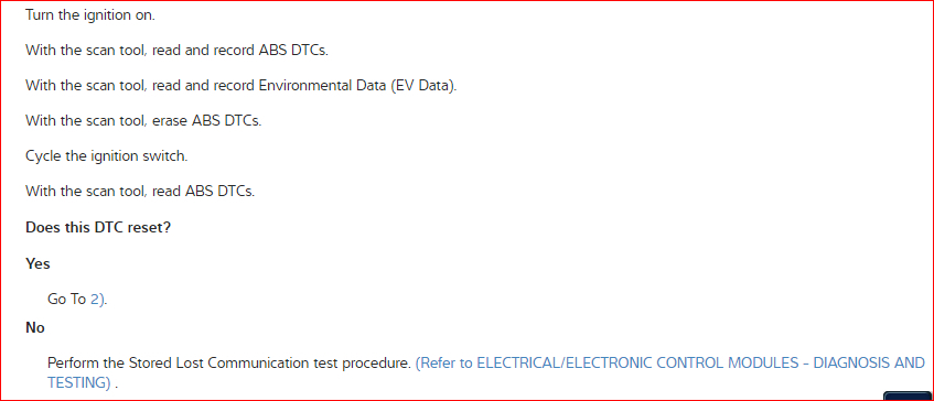

Hello, I'm Danny.

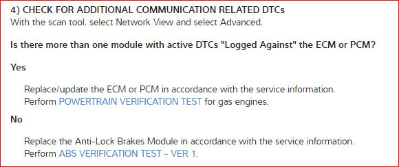

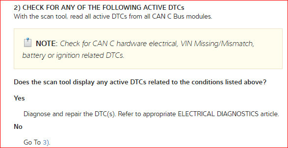

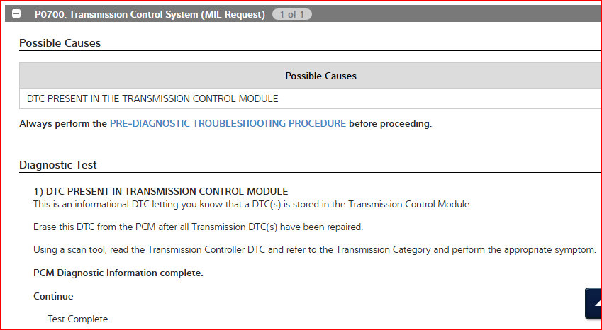

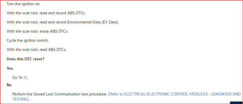

I've attached a few pictures below as a step-by-step guide on checking your codes/problems with your car. Here is a tutorial showing how to check wiring:
You are going to need a professional style scanner to help with the transmission code diagnostics.Hope this helps and thanks for using 2CarPros.
