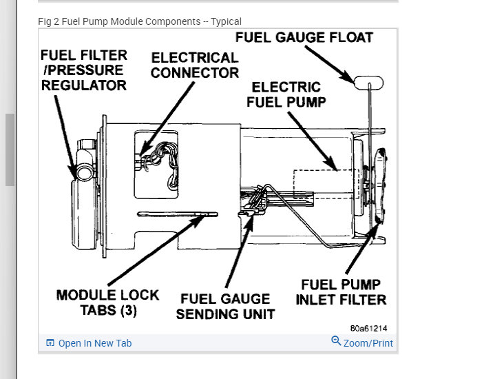

Truck starts idles heats up shut offs and on 100 times. Whether its warmed up or not. it gets a mile or 2 and stalls. truck starts up get a block or 2 and shuts off again and i can keep going this way. I changed fuel pump and only pump not the whole sending unit assembly. i can hear it work like I'm supposed to. also, i got the bed up to get to pump do i have to have the ground wire from cab to bed hooked up to do all tests and checks and run right? What would make a relay click one time but not the next on new relay? And is the fuel pressure 45 - 55 when key is on and under a load or does it rise when under a load.no check engine light. please help. thank you

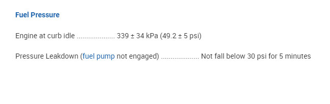

We need to start with fuel pressure when this stalls. It should be 50 PSI pretty consistently even when you are accelerating. It will move around a little but not much.

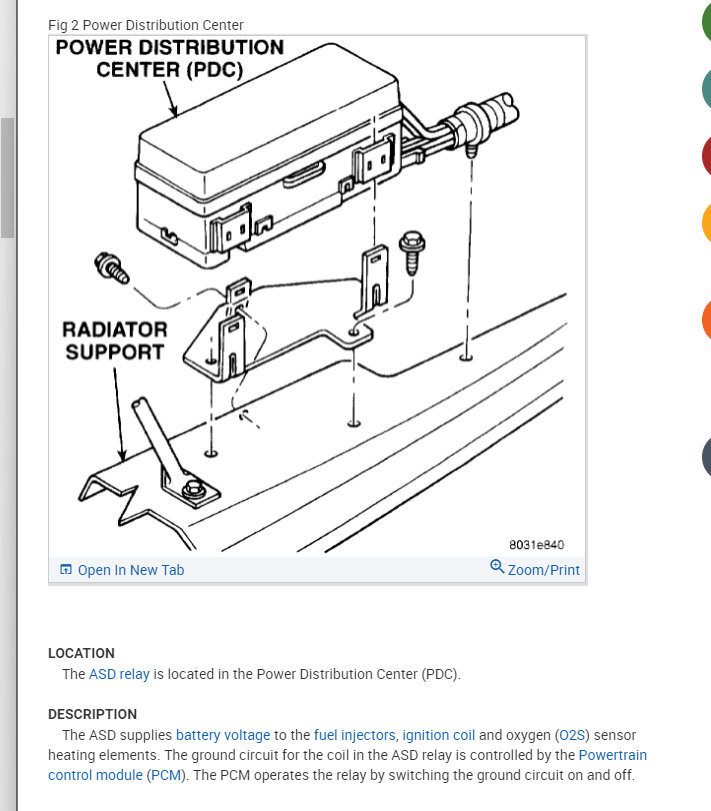

At that point we need to move onto ignition cutting off. This is most likely an issue with the ASD relay. But with this we will need to monitor spark or fuel injector power when this stalls.

It takes three times to get the fuel pressure up to standard and immediately drops off. it stays at 50 when running but drops as soon as I turn key off.
Jan 22, 2022 at 4:56 AM
Okay. The standard for this is when the key is turned on one time it goes to 50PSI and then it should hold pressure above 30 PSI for at least 3 minutes.
If it cannot then the pump is the issue, or you have a leak somewhere in the system.

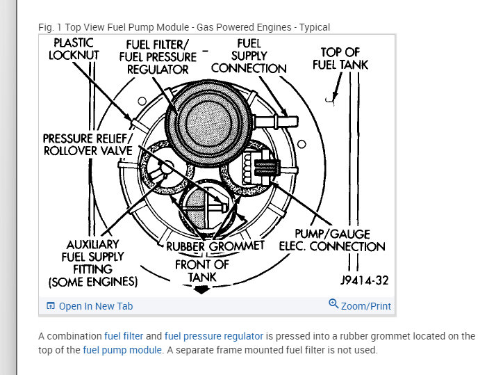

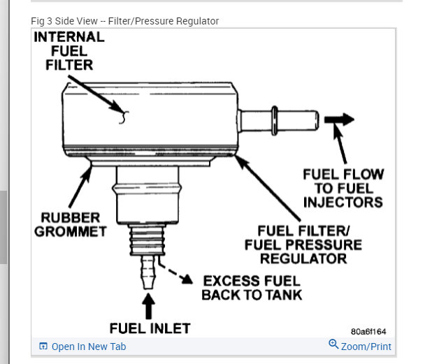

However, when you say you replaced the pump and not the entire assembly, I assume you did not replace the regulator as well?
More than likely this is a regulator issue or relief valve is stuck open.
What happens is the regulator allows the fuel to return to the tank and no flow to the injectors. This causes pressure to be low until the regulator opens enough to all the fuel to build the pressure.
Then when you shut the engine off, the pressure bleeds right back into the tank.
We could have other issues but if it were me, I would replace at least the regulator. However, at this point I would put the entire assembly in there, so I didn't have to go back in.
