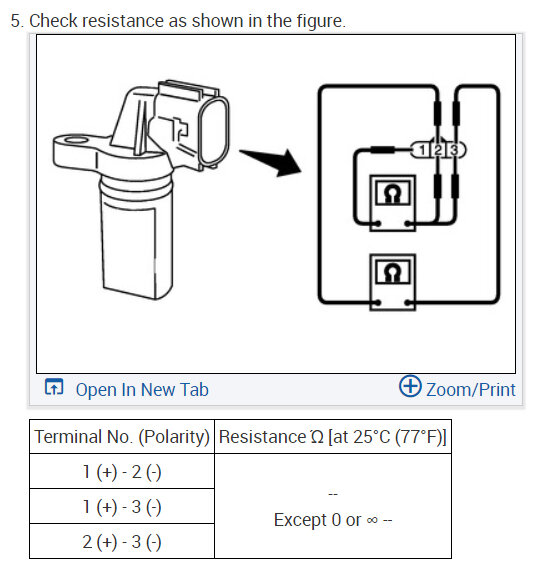

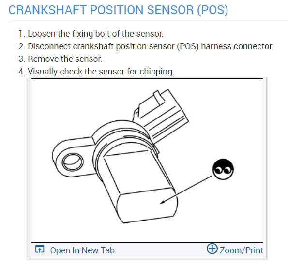

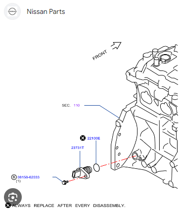

Yep, it sounds like the truck is in limp mode. I would replace the crankshaft position sensor and then clear the codes which should fix it. Here is the location and how to change the crankshaft sensor out. Check out the images (below). Let us know how it goes.
