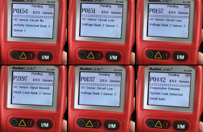

4 months ago I noticed it was kinda shy about shifting when it reached 3,500 rpm's. I let off the gas and it would shift.
2 months ago I got gas and then the next day my car had a considerably hard time shifting at 3,000 and letting off gas wasn’t really helping. Within 30 minutes it was slowly dying. It would go past 2,000 then 1,500 then it would shut off.
I got the gas station inspected and they were fine. Wasn’t the gas. However within the week I get a call from the mechanic saying he couldn’t reproduce the issue. So I drove it home.
The next day I drove to college and it was good. On the way home it start to not shift past 3,000 again and my heart sank. It kept going for a few miles but living in Atlanta means red lights everywhere. Yea, the red light gave my car a chance to break down. I was barely even pushing the accelerator and it still shut off.
I restarted it several times and it idles fine. But as soon as I try to accelerate it has a terrible exhaust noise like a cat is clogged. I loosened the exhaust system (car is loud and annoying now). The car still has issues. Probably not the catalytic converter then.
I let the car run and removed the MAF sensor and the car died. Not the MAF sensor then.
I left it at a mechanic for a total of three weeks and he couldn’t figure out what was wrong. When it sits for awhile it seems to recover. However the more times it does it and recovers, the faster it dies next time.
Tl;dr car shuts off at red light. No like accelerate. Recovers for mechanic. I take home for a bit and it dies on me.

Also, the o2 sensor in bank 2 are new from AutoZone. I also removed bank 1 sensor 2 to let air flow to see if it’s the catalytic converter. It doesn’t appear to be.
May 17, 2020 at 4:41 AM
  • 110,248 POSTS
Since the codes indicate lean or low voltage from the sensors, have you checked to make sure the fuel pressure is within the manufacturer's specs?
If that hasn't been checked, that is where I would start. Here is a link that shows in general how it is done:

Let me know what you find. Also, let me know if it starts right back up each time this happens.

Thank you for the informative reply. But, I don’t understand why the car would be fine after sitting for several hours. Why would it idle fine? And why would that cause a gradual decrease of power until it shuts off and I have to wait to drive it anywhere?
May 17, 2020 at 3:43 PM
  • 110,248 POSTS
My theory is this: Since you have a lean mixture, fuel pressure may be low to start. As the pump runs longer, it may be getting weaker as time passes causing what you described. As far as a good idle, that is when the least amount of fuel is required.
Please understand, this is a theory at this point. When it cools off again, it may begin working again. That is why I suggested checking pressure. I feel it is a good starting point.
