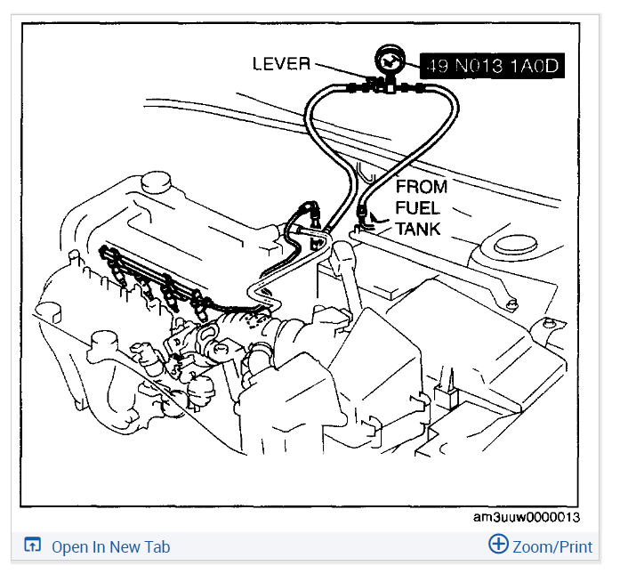

I recently purchased the car listed above last week and it was running smoothly the whole time. However, yesterday whenever i was at a stop light and pressed the gas pedal to accelerate, it kind of hiccups and the RPM meter jumps down and up. At some points, it stalls but it starts back up just fine. No codes on the OBD scanner except for some air bag sensors malfunctioning. I cleaned the throttle body thinking it might've been that but no luck. The battery is also 2 months old. What else can i check for the issue?

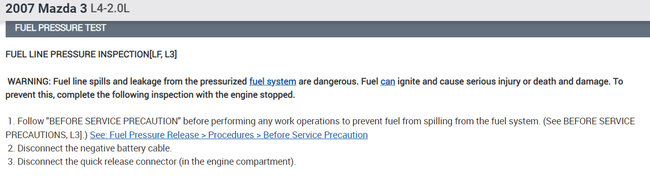

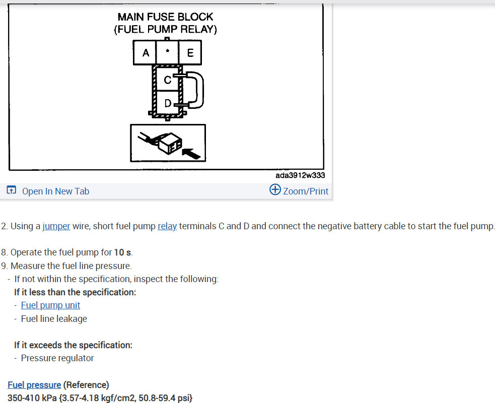

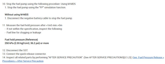

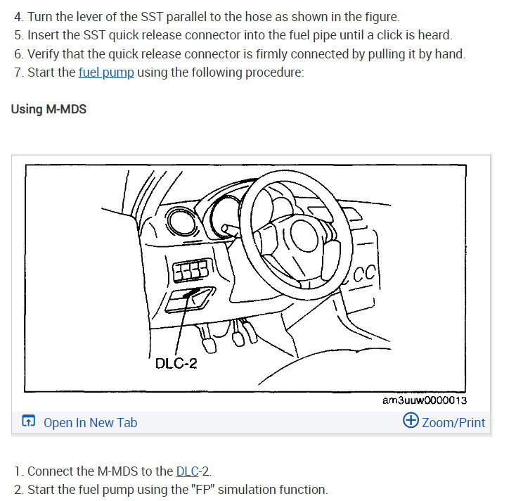

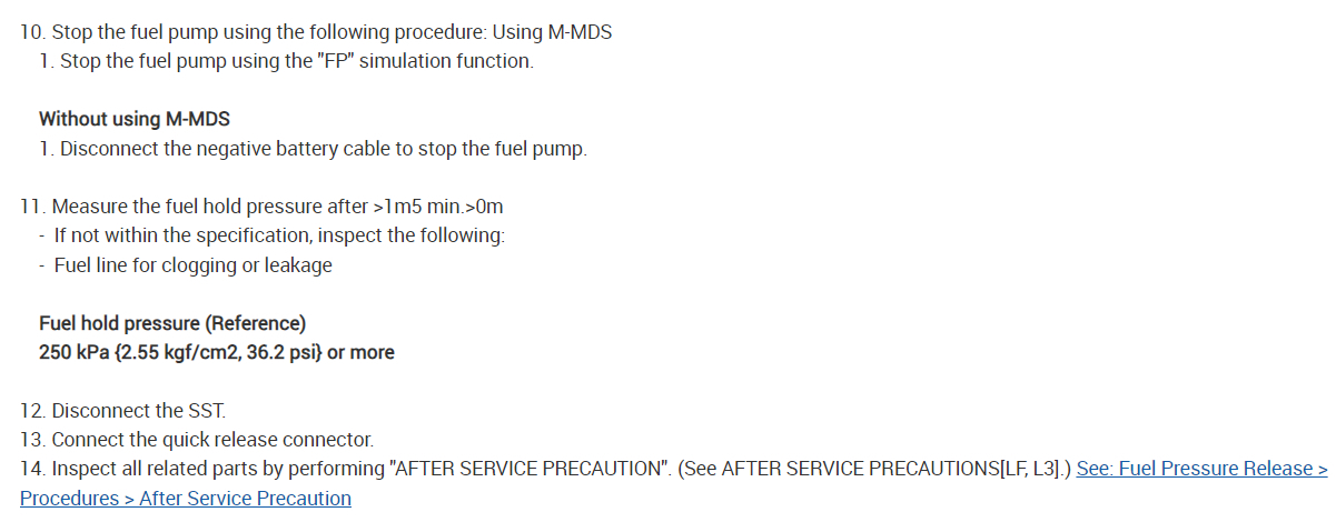

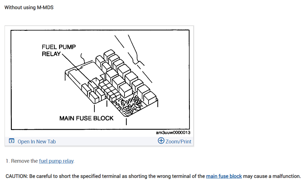

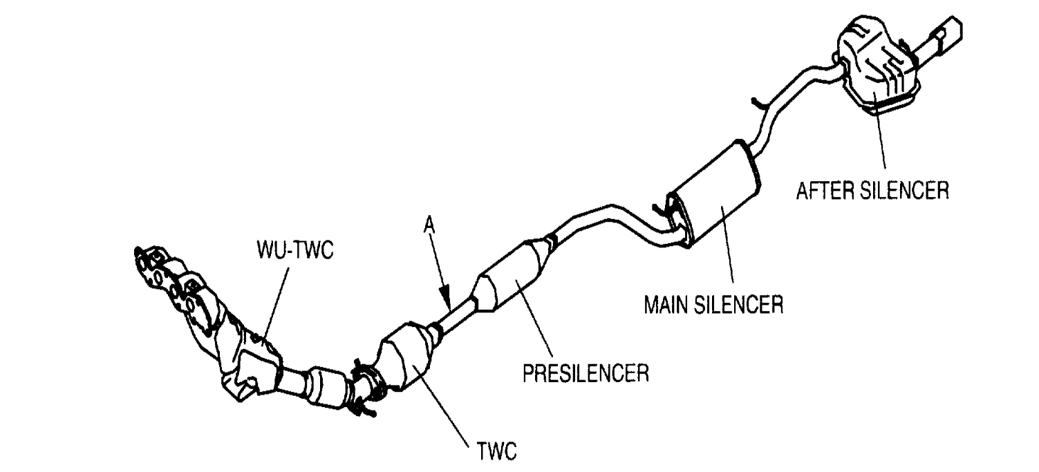

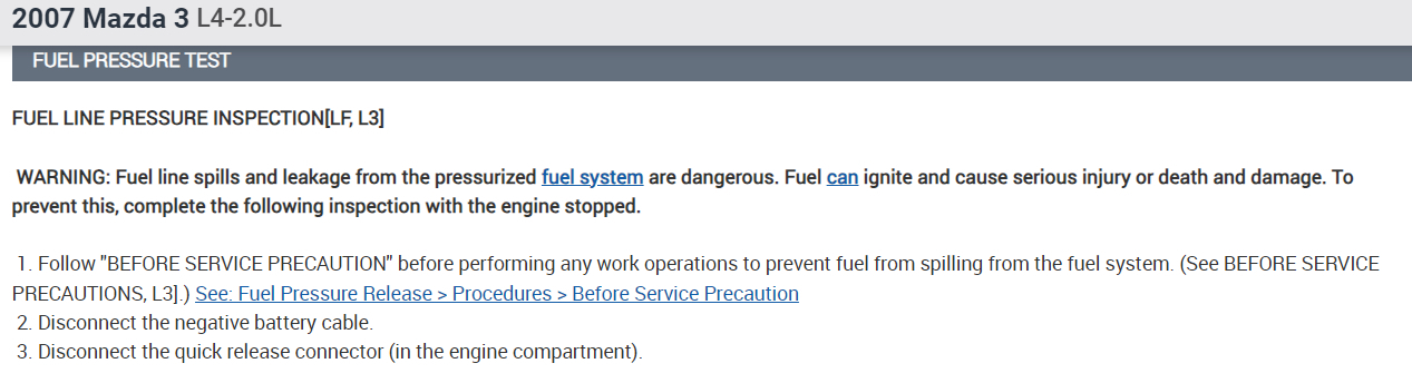

It could be water in the fuel or a weak fuel pump, we can start with a fuel pressure test. It also can be the catalytic converter being clogged due to the catalyst material breaking apart. Let's use these guides to help us eliminate problems:
and you can rent a fuel pressure gauge at the auto parts store for cheap or free.
Fuel Pressure Specifications
LF / L3
Fuel pressure (Reference)
350 - 410 kPa {3.57 - 4.18 kgf/sq.cm, 50.8 - 59.4 psi}
Fuel hold pressure (Reference)
250 kPa {2.55 kgf/sq.cm, 36.2 psi} or more
L3 With Turbocharger
Fuel line pressure
410-490 kPa {4.2-4.9 kgf/sq.cm, 60-71 psi}
Fuel hold pressure
More than 230 kPa {2.3 kgf/sq.cm, 33 psi}
I have seen the primary cats have issues so you might want to remove it for inspection. Check out the images (below). Please let us know what happens.
