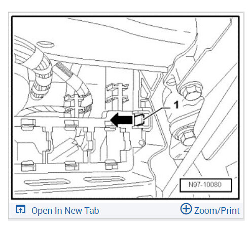

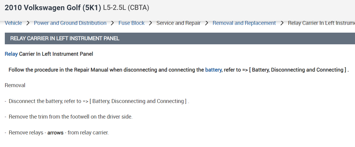

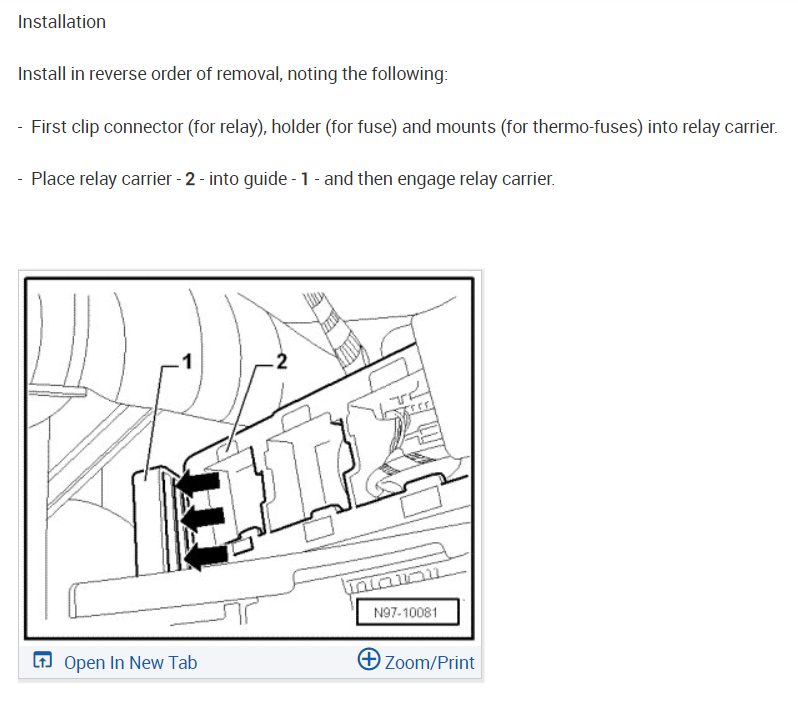

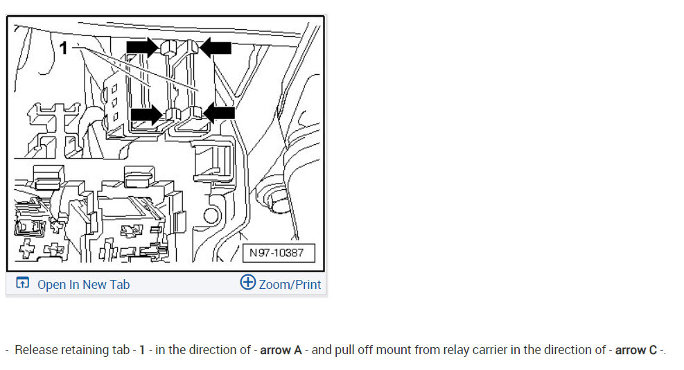

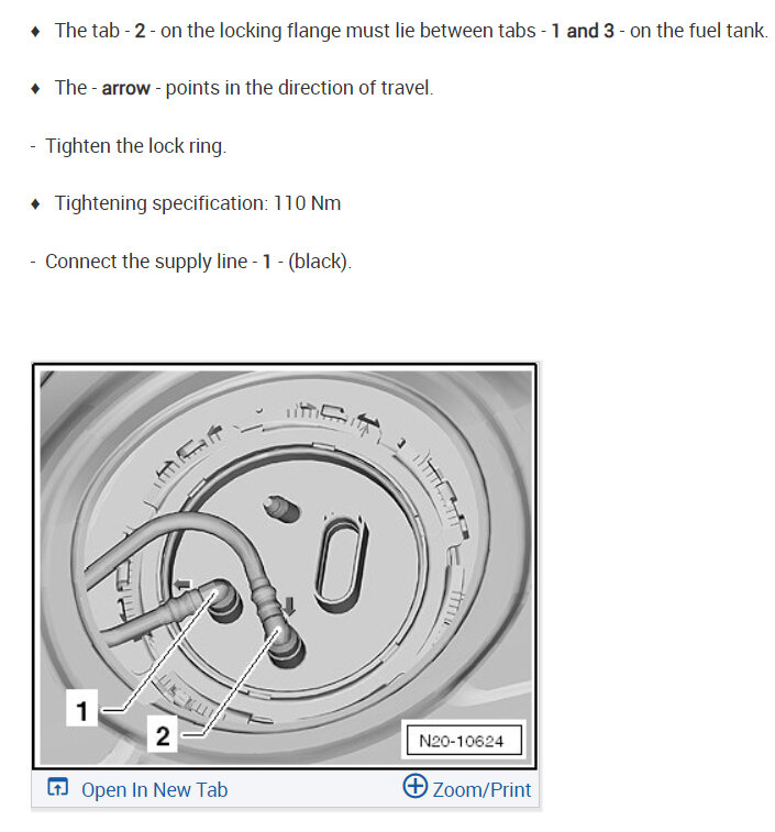

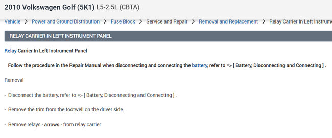

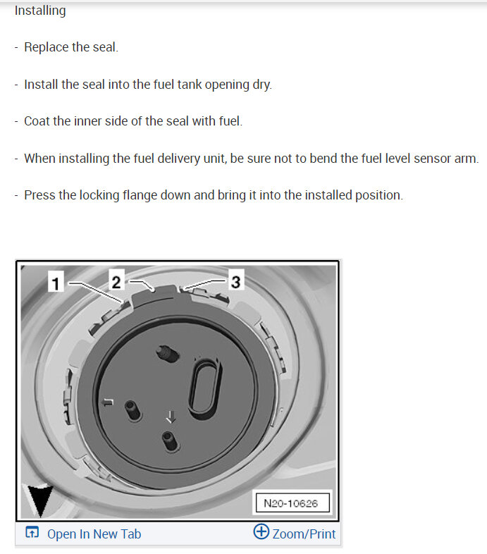

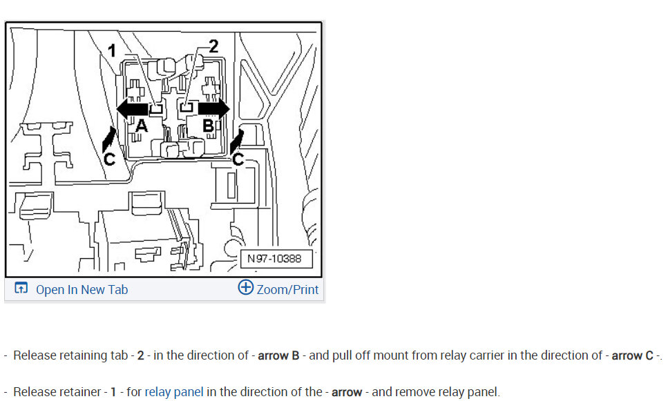

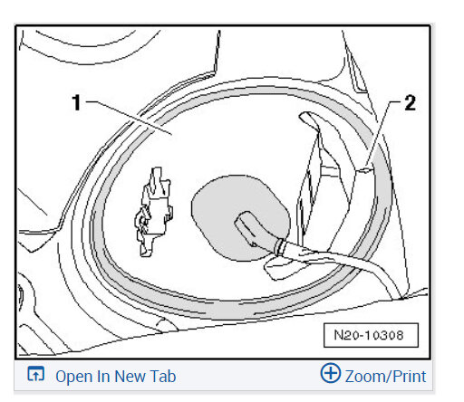

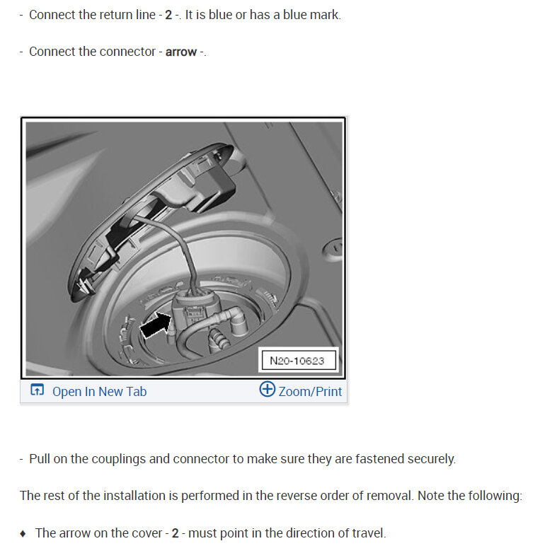

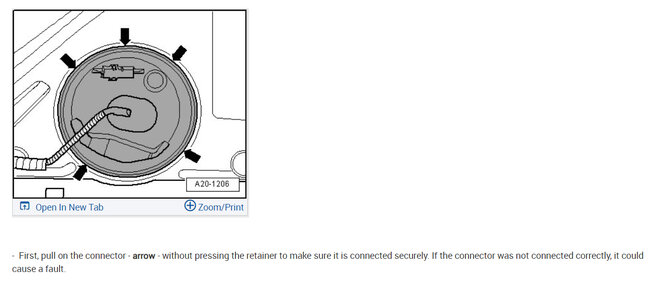

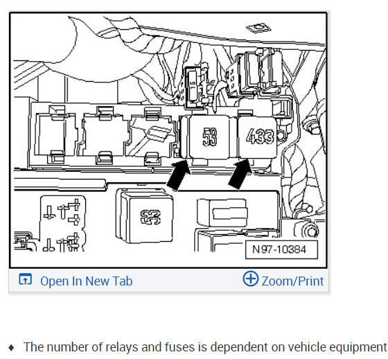

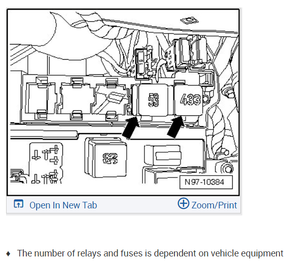

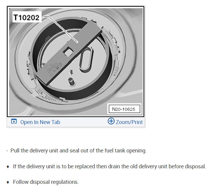

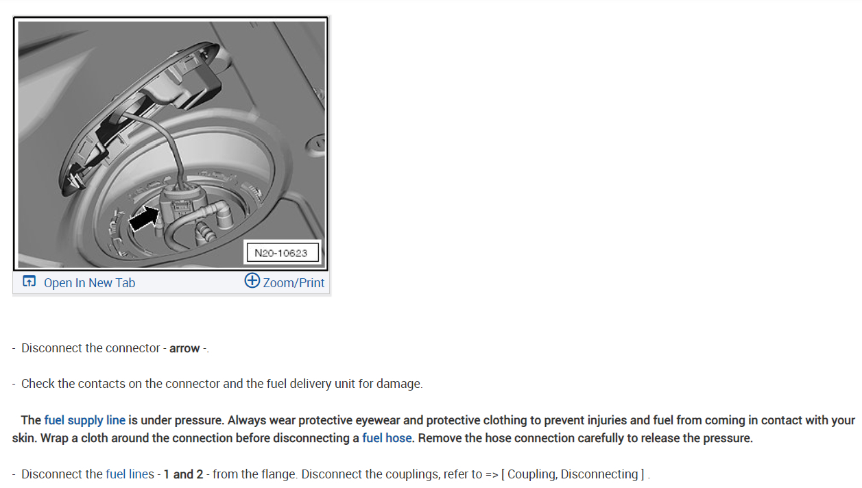

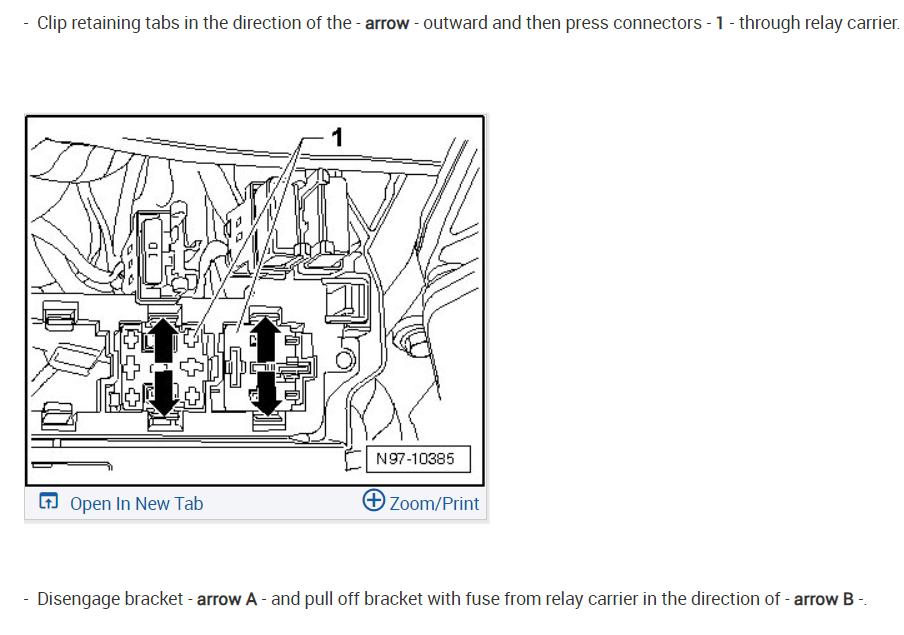

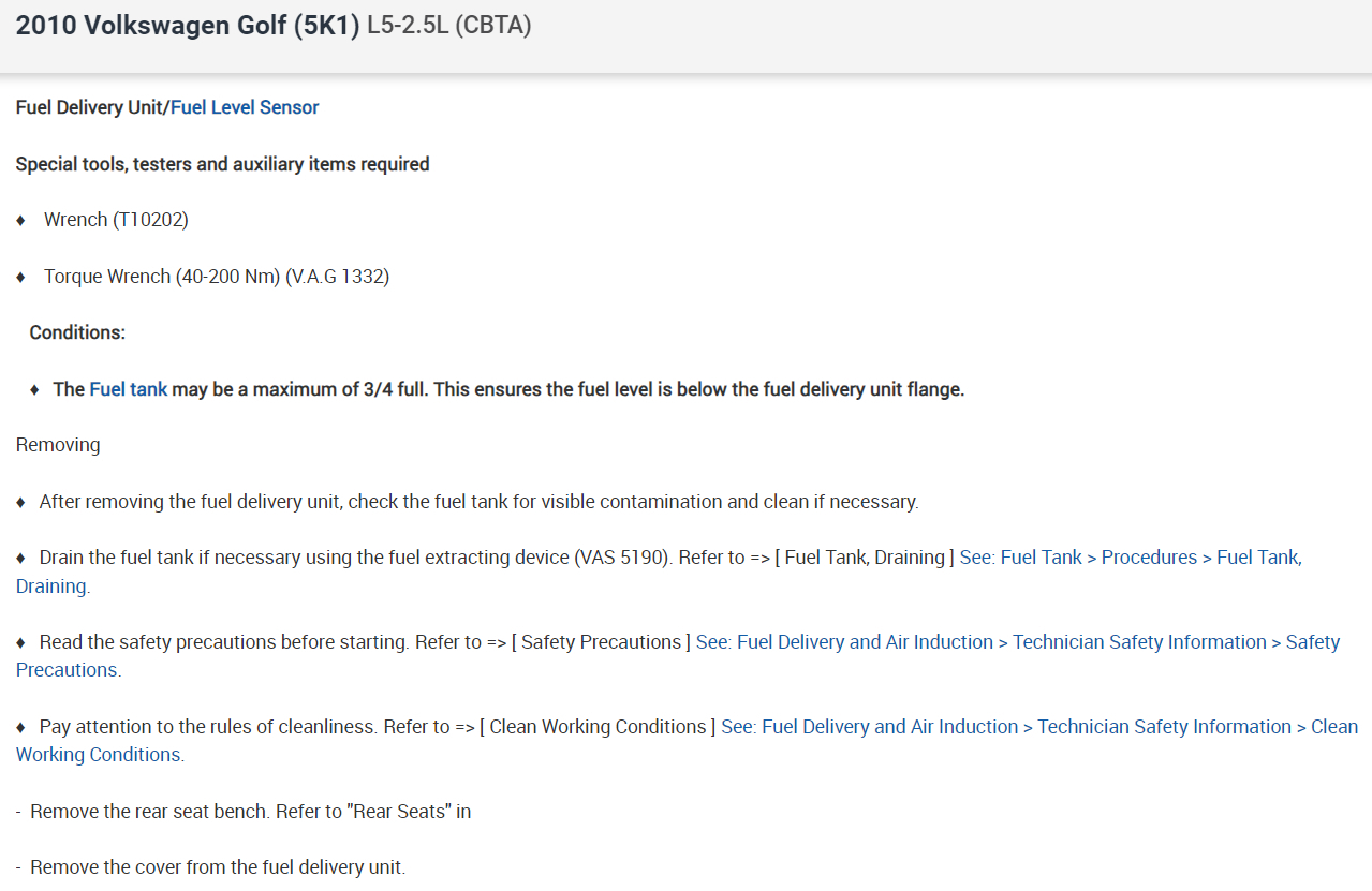

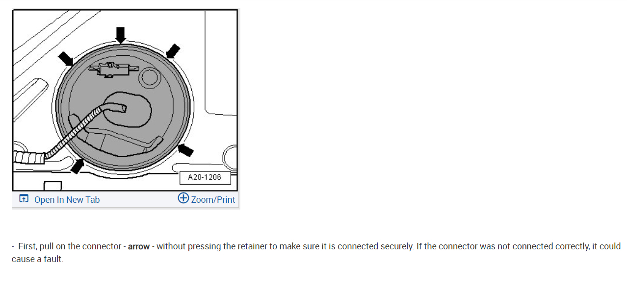

You have many codes which can be caused by the root problem, the code that sticks out for me is the:
p1541, fuel pump relay(j17) open circuit.

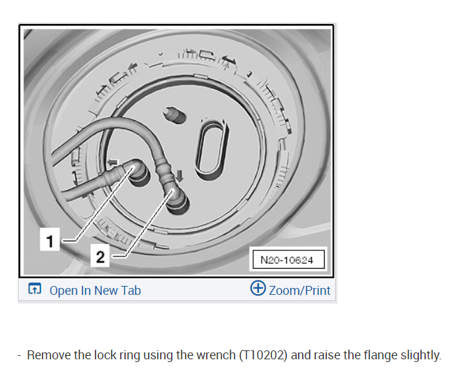

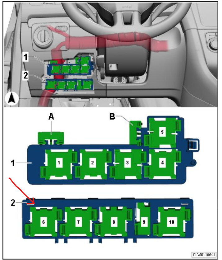

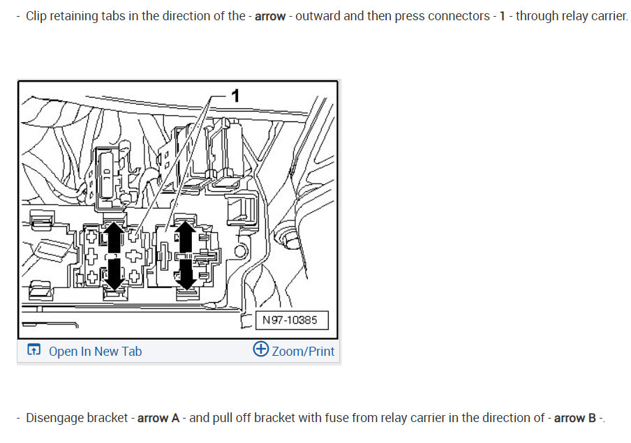

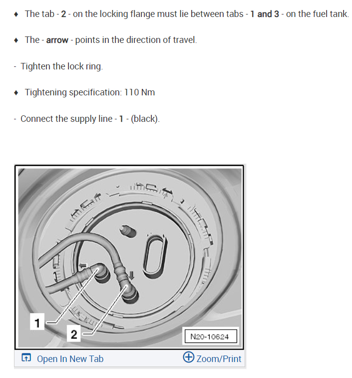

This is telling us the fuel pump and/or relay is going bad. I would clear the codes and replace the relay and fuel pump here is how the job is done for the fuel pump and the location of the FP relay.
This guide can help as well:
https://www.2carpros.com/articles/engine-stalls
Check out the images (below). Please upload pictures or videos in your response to the problem so we can see what's going on.

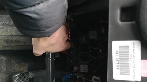

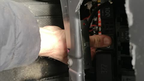

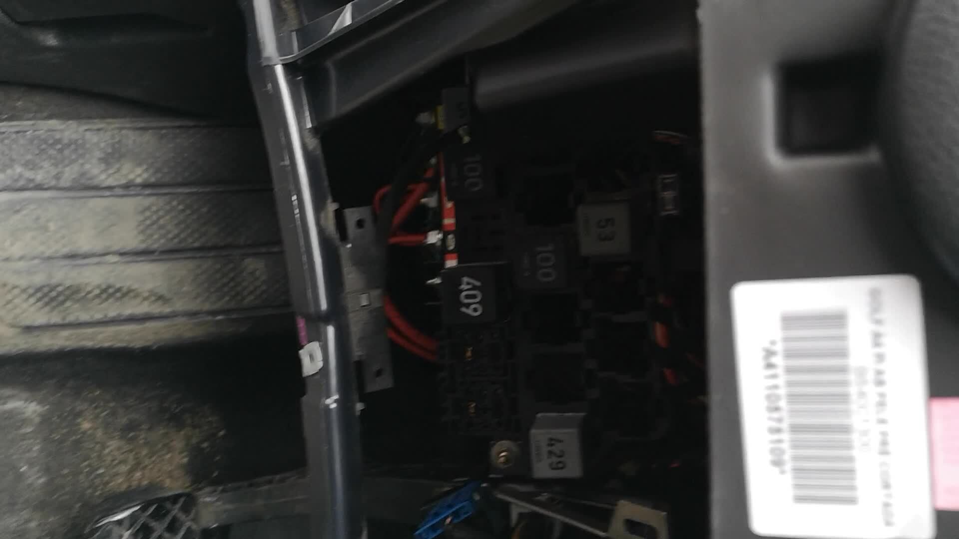

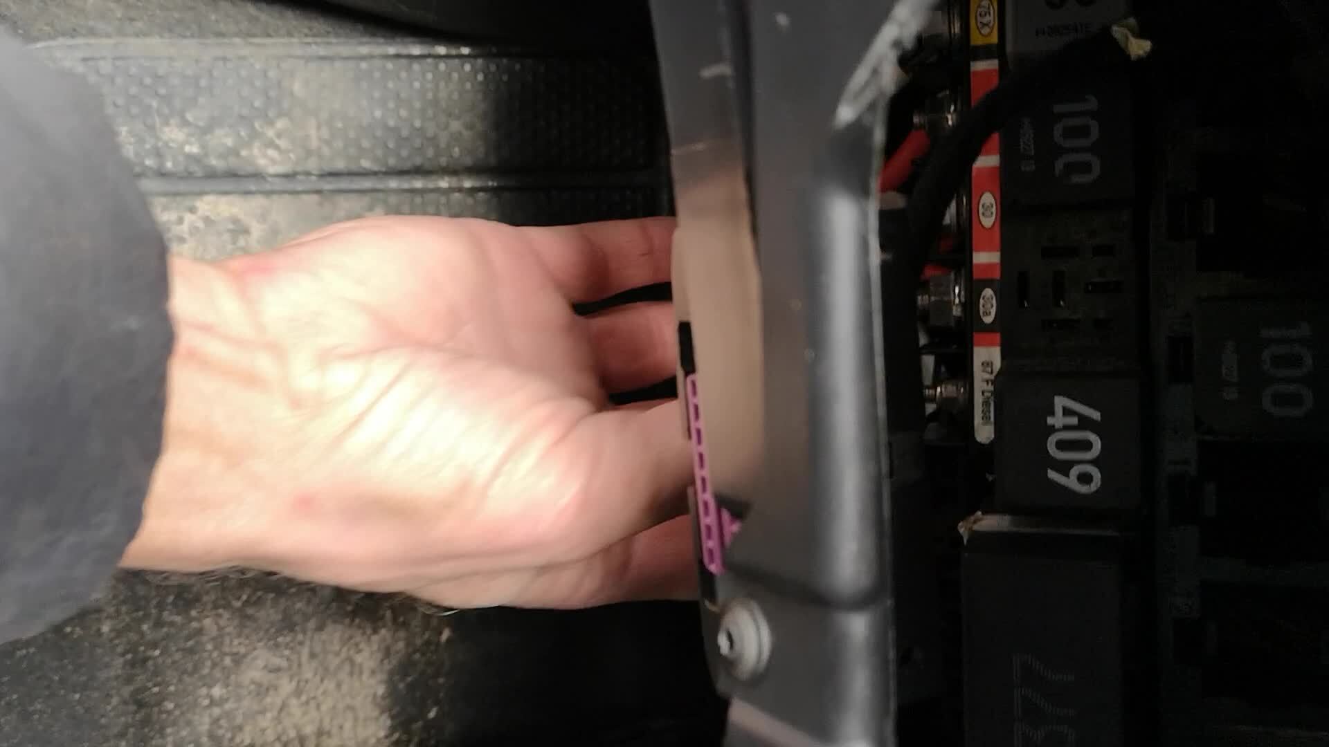

When i pinch/push on the fuel pump relay the car stall, it seems to come from inside the relay power/connector block. i will disassemble it and look inside, I'll let you know my findings.

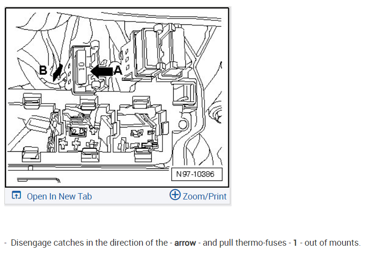

Good find, the wiggle test helps find electrical problems. thanks for the video. I have seen the fuse panel and with all of those codes is likely there is a problem. Check out the images (below). Please upload pictures or videos in your response to the problem so we can see what's going on.
Feb 8, 2024 at 1:36 AM
CHRIST CHEN
  • 36 POSTS
Good day Ken,
Your pics don't really help since my car is a 2l engine and Canadian market car only.
And for that, all set up as wiring, fuses box and relay carrier are very different.
That said, I already disassembled the relay carrier and opened it, all i found is a few loose connections, pinched them close and put it back together but it still stalls when i push on the fuel pump relay.
I will have to find a new one and try the test again and see.

Hopefully problem solved. i found a relay at the wreck yard, no stalling when i pinch the relay. so, we'll see in a few km how it goes. Thanks Ken.

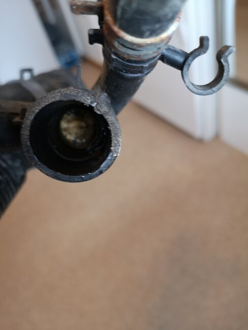

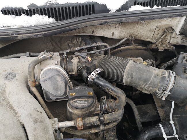

As i checked a few things, I noticed that there is oil,ice and a gas smell in my PCV, which is electric tube and valve (2010 Golf City, 2.0l).
What would cause this?
Christian
Feb 18, 2024 at 2:16 AM
CHRIST CHEN
  • 36 POSTS
From what i could read on the internet, it is called "heated PCV valve" and it is permanent on the intake tube, on the valve there is a small vacuum tube connected to the throttle body to close the valve at idle and open it as the RPMs rise. The thing is that i don't know how to check if the heater works or even has power to it and if the vacuum hose closes and opens the valve to let crankcase vapor in the intake.
Any leads to guide me on the right way to do it?
