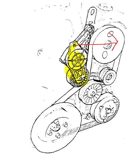

Do me a favor. Remove the accessory drive belt and spin the pulleys one at a time to see if you hear any noise.
I attached a picture below and highlighted the belt tensioner. Using a ratchet, turn the tensioner in the direction I have an arrow pointing (clockwise). That will loosen the belt. Installation is the reverse.
joe
See pic below.
Oct 4, 2023 at 10:14 AM

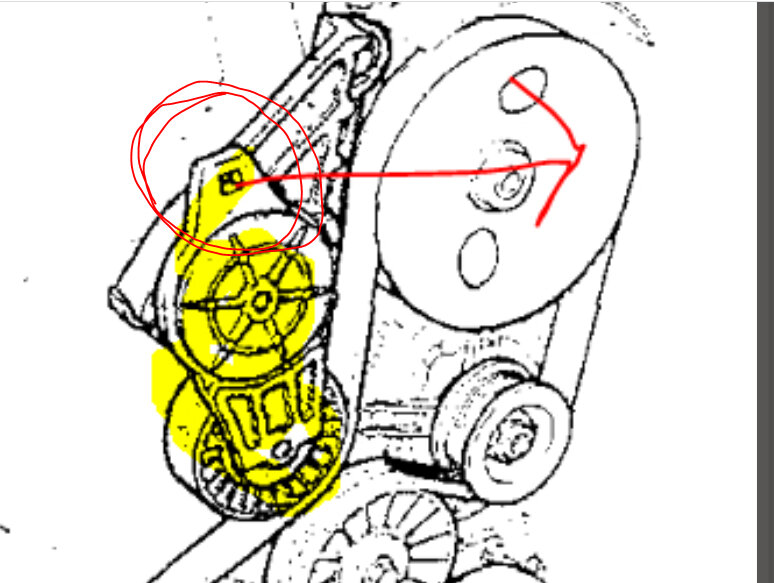

Good morning, Joe. I know where the belt tensioner is located; however, I do not see where to fasten my ratchet wrench. Is it the large nut on the larger wheel? Thanks.
Oct 8, 2023 at 11:07 PM
  • 110,241 POSTS
There should be a place on the tensioner to install either a 1/2" ratchet or a 3/8" ratchet. I recopied the pic from above and circled what you are looking for. Let me know if you find it. If you do, turn it clockwise to loosen the belt.
Oct 9, 2023 at 7:41 AM
PENELOPEPITTSTOP
  • 9 POSTS
Hi, Joe. I have not had a chance to work on the Volvo. Yesterday and today, I tried to start it again. The engine turns over but will not start at this point. And I've checked out bolts under the hood to make sure everything is tight. I know we've had lots of wet weather and I have not tried to start it since the loud noise I described (maybe 3 or 4 weeks ago?). So, I just wanted to touch base and let you know that I'm still here. I do not see any place to use a socket wrench on the belt tensioner assembly. Any other ideas you can offer would be great. We live in an area where no one is interested in working on an old Volvo. The garages want to repair the late model vehicles. Very discouraging.
