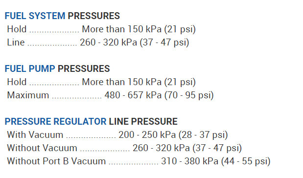

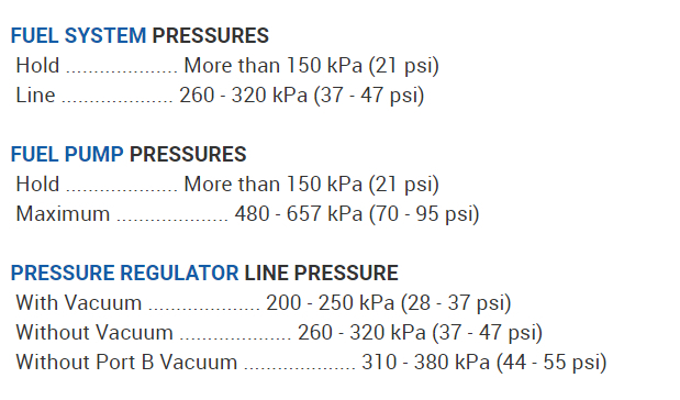

Have you tested the fuel pressure? It's possible you might have a week or failing fuel pump causing the poor performance and stalling. If you don't have access to a fuel pressure tester most auto parts store have a tool loaner program and can rent you one. Here is a tutorial showing what is involved:
I've attached a picture below of the fuel system specifications for your car. Let us know what you find and we'll go from there. Hope this helps and thanks for using 2CarPros.
