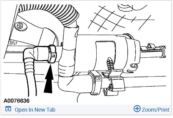

When the car is hot or drive to a long distance it will stall for half second like I press gas pedal no response after a second it picks and continues running well when it do that I press the accelerator harder it back fire in the exhaust and keep on running

This sounds like the fuel pump is going out, do you have any codes? This vehicle has a fuel filter so I would change that out first. Here is the location and a video on how to change it out and get the codes. Also, scan the car for codes as well.
https://www.youtube.com/watch?v=wi6kzRjk5to
and
https://www.youtube.com/watch?v=LBCpCWEFnTg
Check out the images (below). Please let us know what happens. Ken

I changed the fuel pump already with new one
Mar 7, 2026 at 5:00 AM
BITRUS DAVID
Twice came thing changed fuel pump module still not fixed but I didn't the fuel filter
Mar 7, 2026 at 5:02 AM
BITRUS DAVID
And no fault code

I would change the fuel filter for sure, let me know what happens please. A clogged fuel filter will cause this issue.
