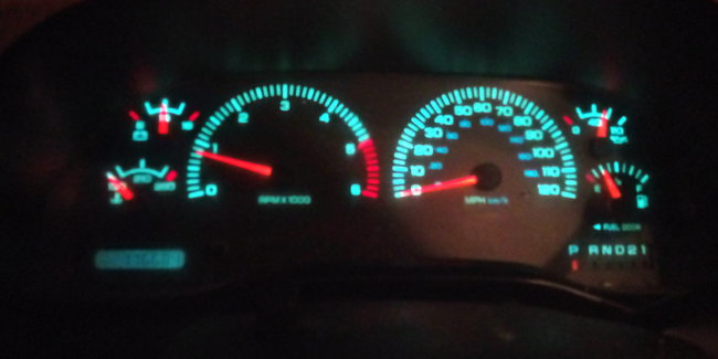

Oil pressure high. Exhaust leak between o2 sensors. Possible oil in coolant. Can anyone tell me what is the problem here? Cracked head? Blown gasket? Stuck valves? And what's up with the darn heater and gauge?

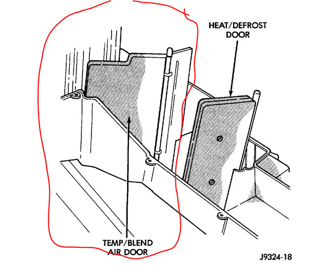

Now for the other issues. Do both heater core hoses get hot when the engine is warn and the heater is on? If they do, then the issue is related to what is called a blend air door. If you look at pic 1, I attached a pic of the door. There is an actuator to move the door in different directions when you change temp. On this vehicle, it is controlled by engine vacuum. If there is no vacuum, the actuator won't turn the door for heat. Also, if there is a vacuum leak, it can cause the engine to stall when at idle Take a look through these links and let me know if any of them help.
Keep in mind, some actuators are electric and others, like yours, can be vacuum or cable controlled. The vacuum reservoir is mounted in the passenger side cowl plenum area, under the cowl plenum cover/grille panel. The cowl plenum cover/grille panel must be removed from the vehicle to access the vacuum reservoir for service. That is where I would start checking for vacuum leaks. Also, here is a link that explains how to find one:

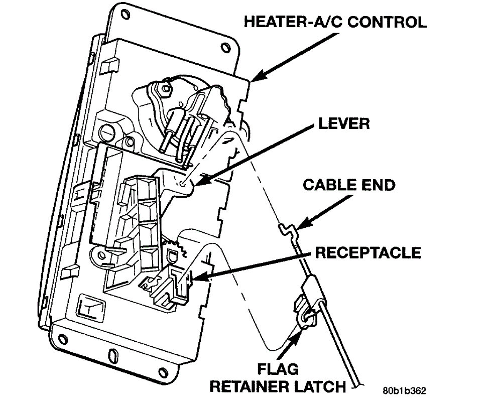

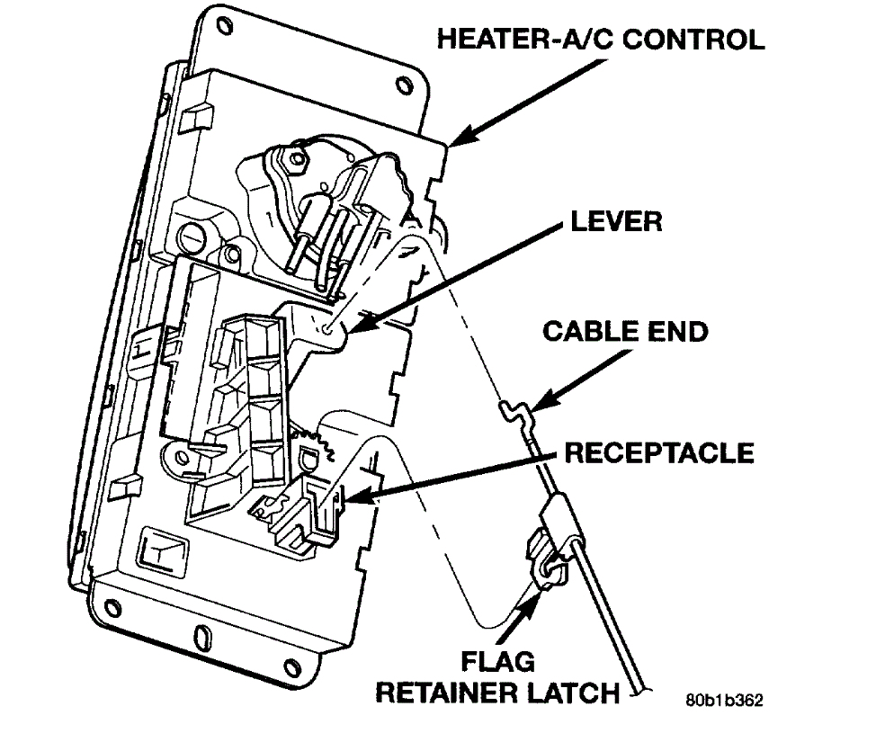

If you look on the back of the control panel, you may see a cable. See pic 2. If the cable is there, make sure it is properly attached. If you follow the cable (if it is of a cable design) it will lead you to the temp door. At that point, confirm it moves when you change temperatures.
Okay, I see the oil pressure above. It is still within the safe range, so it really isn't that much of a concern at this time. The exhaust leak is a different issue. A leak before an oxygen sensor can allow unmetered air to make its way to the sensor. In that case, the computer sees the system as running lean and will try to compensate by adding fuel. That can also be a partial cause of the stall.
