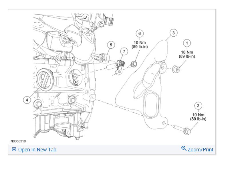

My car will turn off when driving, so far only in town driving. I pull over and it will re-start. Runs and idles fine. I have replaced the fuel control module and fuel pump.
Jan 12, 2023 at 1:15 AM
  • 55,224 POSTS

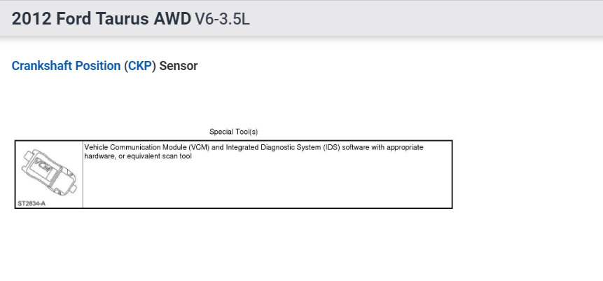

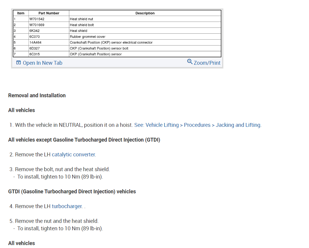

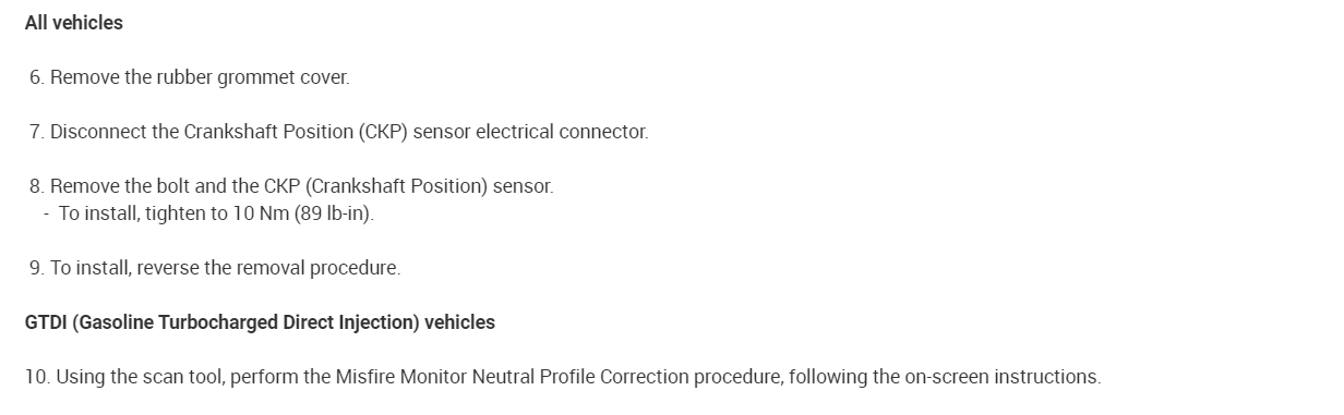

When it stalls do you have spark, and will it run on starting fluid? If not, I would run the codes and if none come up, I would replace the crankshaft angle sensor which can cause this issue. Check for spark video.
https://youtu.be/baq_aEWNQ0Y
and
Here is the location of the crankshaft angle sensor and how to change it out in the images below. Check out the images (below). Let us know what happens and please upload pictures or videos of the problem.
Jan 12, 2023 at 9:45 AM
MATTJH123
That fixed it. Thank you for the help!
