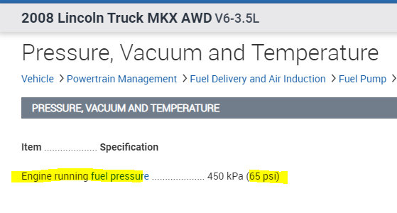

Here is my thought: If you had to cycle the key three times for it to start, we may have an issue with fuel pressure drop-off. If this has only happened once, see if it happens again after the vehicle sits overnight.
If it does, here is a link that explains how to test fuel pressure. You will need a fuel pressure gauge, but most parts stores will lend one to you.
I attached the manufacturer's fuel pressure specifications below. When you test this, pay attention to how quickly the fuel pressure drops once the key is turned off.
Let me know what you find.
See pic below.

Running fuel pressure 65 PSI, slowly dropped to around 55 after shutting off. No pending codes. Yesterday I noticed some corrosion on terminals, so I disconnected those for about half an hour while cleaning them. Nothing bad happened today, it ran and started normal. Now my son is a Chrysler mechanic and wasn't sure if his reader would pick up all of Ford's pending codes. I doubt that having battery corroded would've caused issue or disconnecting battery for half hour or so would've reset computer and that was problem. Honestly, though, I'm no mechanic since cars got computers decades ago. If you have any other ideas, please let me know, I planned a trip next weekend and don't want to get stranded 200 miles from home.

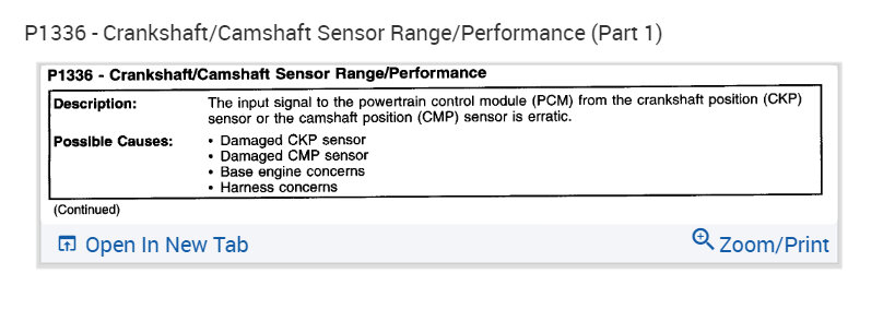

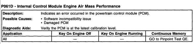

Hey Joe, got a better chance to read codes coming up. P061D Internal Control Module Engine Air Mass Performance and P1336 Misfire Monitor Hardware C?? misaligned CKP/CMP noise. The screen on reader has a blem so I couldn't read what were the 2 digits behind the C on 2nd code. Any thoughts?
Rich
Oct 24, 2022 at 9:41 AM
  • 110,248 POSTS
The first thing I would recommend is to have the PCM updated to see if that changes things.
Pics 1 and 2 are the descriptions. Based on what I'm reading for diagnostics, I would first focus on the P061D code. Between these two codes, you are going to have a hundred pages of diagnostics. LOL However, I will let that up to you.
I suggested that code because it is tied to the PCM. The other code is likely a wiring issue that in fact, may be caused by the PCM. I don't know if that makes sense or not. Regardless, let me know which way you would like to run with this, and I'll get you set up with the diagnostics.
