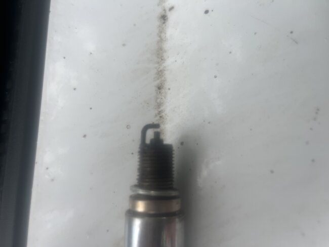

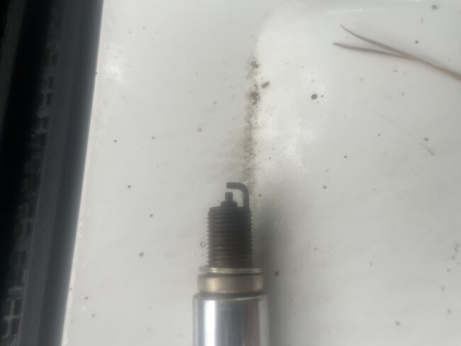

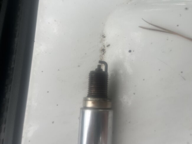

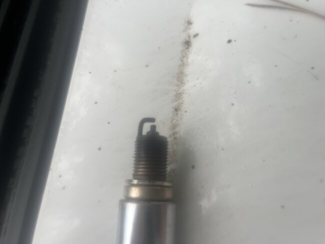

So if the long term trim says it is lean, then the short term trim will try and richen the mixture. This is why you smell the cats over working themselves. It can be a bad fuel injector as well that, is why we need to run the tests I presented to see what the problem is, there is no "one" answer to this problem, we must run some tests. If you remove the spark plugs and look at them it can tell us if a particular cylinder is causing the problem. You can upload an image of the plugs so I can see. I hope this helps.
Jul 12, 2025 at 2:00 AM
NETDALE10
  • 15 POSTS
Here are the the pictures:
Jul 12, 2025 at 2:38 AM
  • 55,402 POSTS

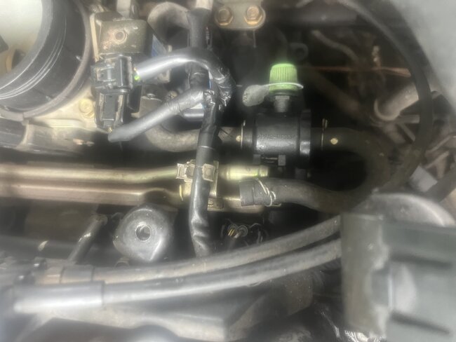

Yep, now we know it is not one cylinder causing it. There is a fuel vapor line I need you to check that goes to the engine, it should not have fuel in it. Here is the location so you can check it out. Thanks for the images. Check out the images (below).
Jul 12, 2025 at 2:58 AM
NETDALE10
  • 15 POSTS
I believe that this is the line you are referring too. It looks like a return line for the fuel. It is dry inside.
Jul 12, 2025 at 3:10 AM
