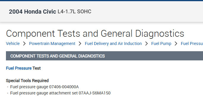

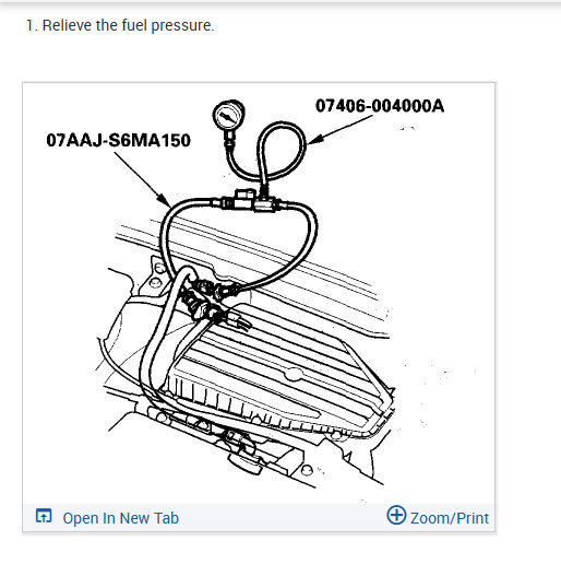

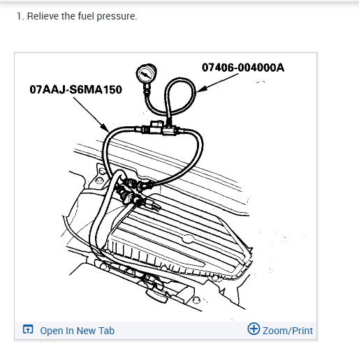

Two of the codes are specific to oxygen sensors. The one that has my attention is the P0171. That code indicates a lean fuel mixture. Have you checked to make sure there are no engine vacuum leaks? If not, start there. Here is a link that explains how to check.

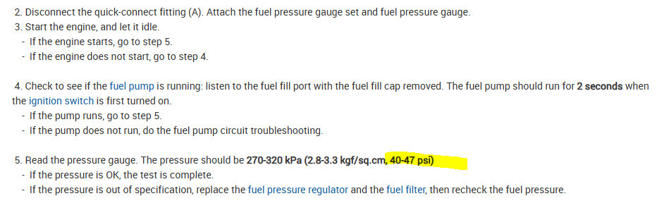

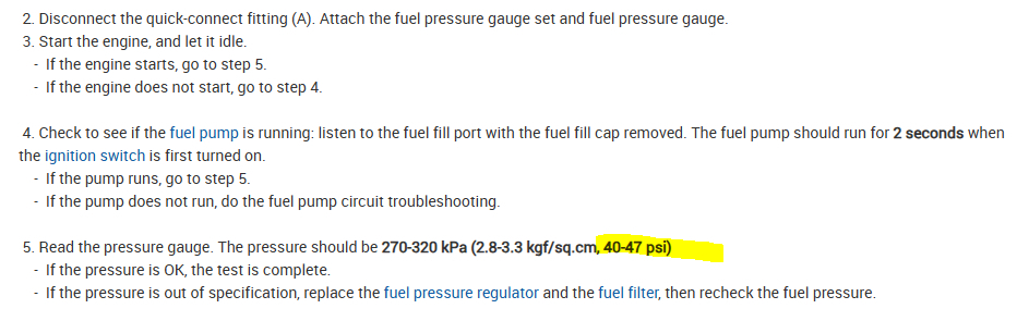

If you cannot find one, the next thing would be to check the fuel pump pressure. It can be too low or too weak to run the vehicle. I attached the directions and manufacturer's specifications below.
Let me know if this helps or if you have questions.
joe
Jul 7, 2025 at 9:33 PM
NETDALE10
  • 15 POSTS
Thank you for such a quick response. I am checking for leaks right now. I do have a leaky plug on the end of the cam shaft cover. Oil is leaking there. Is it possible that this is the problem? I have to wait a few days until the new one arrives. I just find it hard to believe that this problem is caused by a leak somewhere. The car always starts. But sputters and dies as soon as the car starts. If I try to rev it up, the RPMs go up but sputters and shuts off.
Also measured the fuel pressure. It is a steady 45psi.

Sorry for the delay, the fuel pressure is good, it seems like you have a large vacuum leak. This is why the oxygen sensor cant respond and the PCM is dumping fuel into the engine.

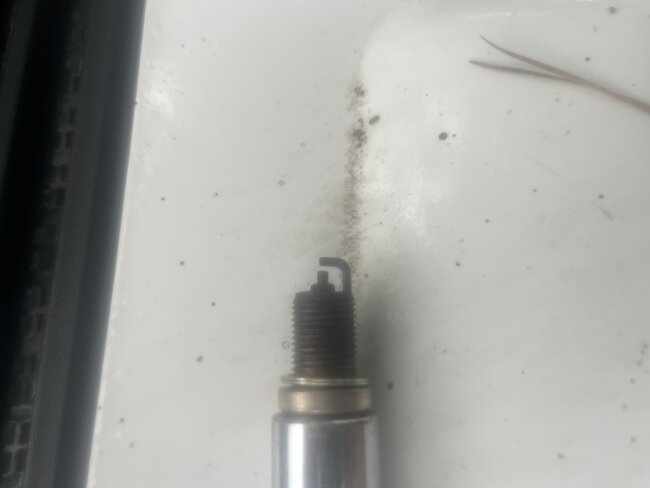

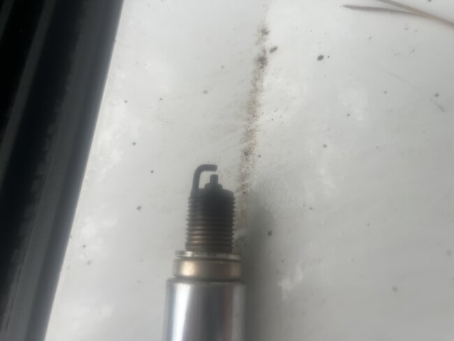

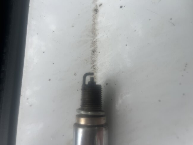

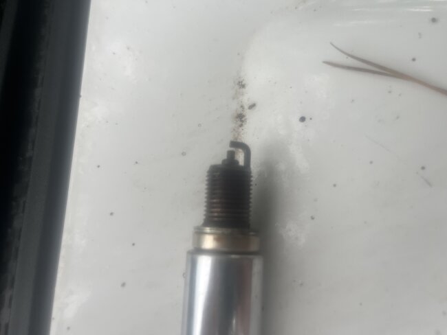

So if the long term trim says it is lean, then the short term trim will try and richen the mixture. This is why you smell the cats over working themselves. It can be a bad fuel injector as well that, is why we need to run the tests I presented to see what the problem is, there is no "one" answer to this problem, we must run some tests. If you remove the spark plugs and look at them it can tell us if a particular cylinder is causing the problem. You can upload an image of the plugs so I can see. I hope this helps.
Jul 12, 2025 at 9:00 AM
NETDALE10
  • 15 POSTS
Here are the the pictures:
Jul 12, 2025 at 9:38 AM
  • 54,832 POSTS

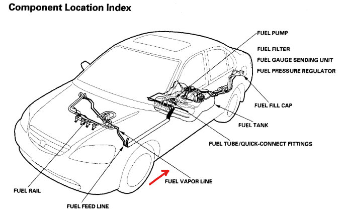

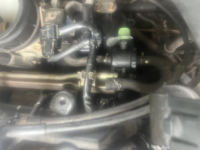

Yep, now we know it is not one cylinder causing it. There is a fuel vapor line I need you to check that goes to the engine, it should not have fuel in it. Here is the location so you can check it out. Thanks for the images. Check out the images (below).
Jul 12, 2025 at 9:58 AM
NETDALE10
  • 15 POSTS
I believe that this is the line you are referring too. It looks like a return line for the fuel. It is dry inside.
Jul 12, 2025 at 10:10 AM

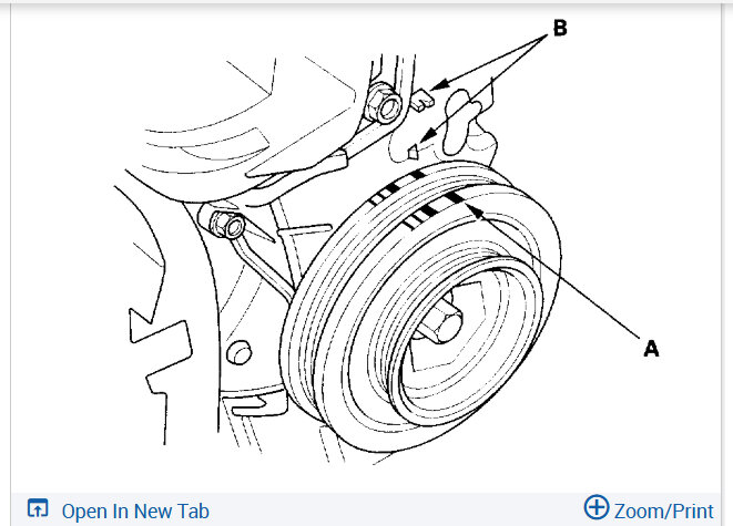

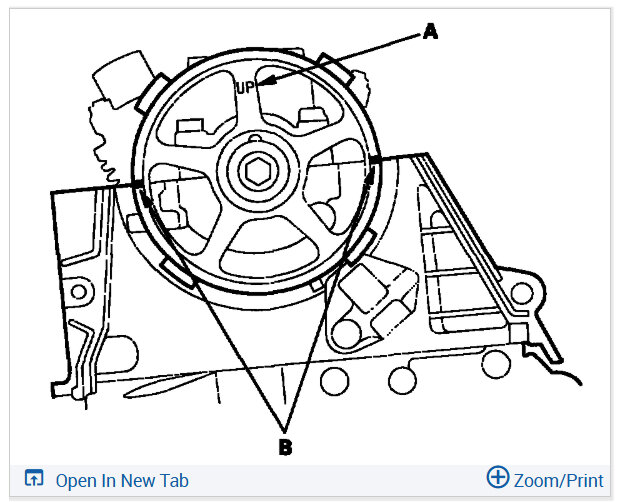

It sounds like it can be a weak fuel pump or the camshaft timing has jumped. Here is the camshaft marks so you can check it. Check out the images (below).
Jul 12, 2025 at 6:28 PM
NETDALE10
  • 15 POSTS
Thank you I’ll check it tomorrow. I checked the fuel pressure. It is a steady 45psi.
Jul 12, 2025 at 6:33 PM
  • 54,832 POSTS
Okay, yep I would check the timing of the camshaft. Have a good Sunday!
Jul 13, 2025 at 11:57 AM
NETDALE10
  • 15 POSTS
It took me some time to check it. It is about maybe 1 tooth off.
Jul 25, 2025 at 4:15 AM
  • 54,832 POSTS
One tooth off is enough to cause low engine vacuum which will cause the ECM to give the engine excessive fuel. I would install a new timing belt.
