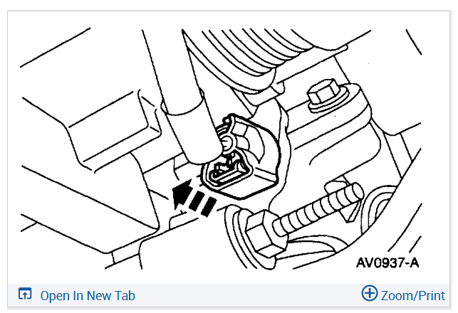

My car starts runs after a little while it shuts down and won't start back until it has cooled off no lights on cluster panel.

These can be tough problems to fix, we can start with the easy stuff which will be seeing if the fuel or spark has failed, I would use starting fluid after it stalls to see if that makes a difference and if so, I would replace the fuel pump and relay. If it makes no difference then the engine has lost spark.
This video can help us see which system is failing:
https://www.youtube.com/watch?v=lXLJbuAZ4CE&t
Here is the location of the crankshaft sensor in case there is no spark. You will need to remove the A/C compressor to get at the sensor. Check out the images (below). Please let us know what happens.
