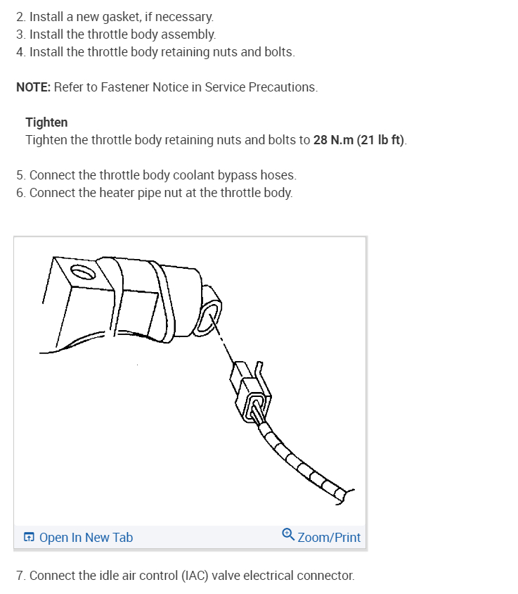

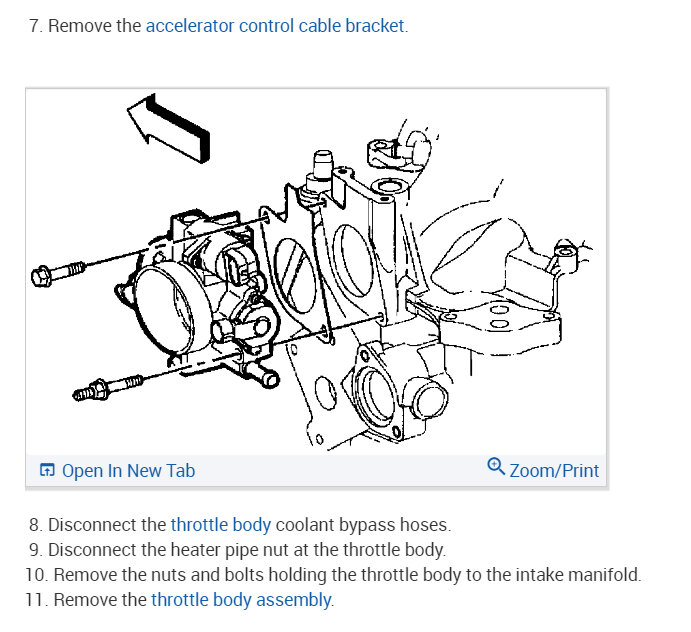

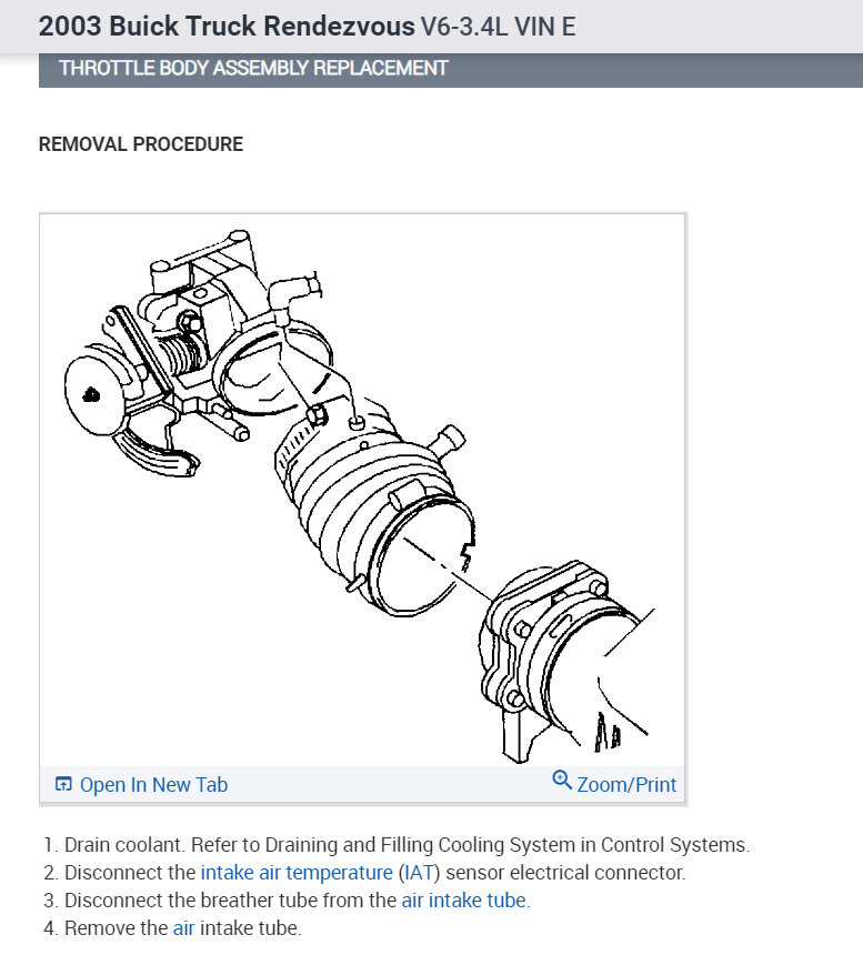

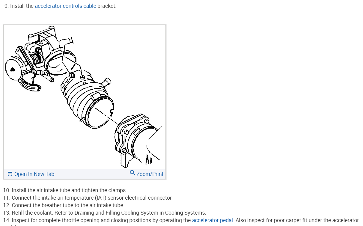

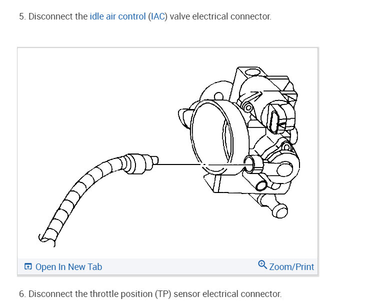

I start the car once I start or try to reverse it cuts off. I have to press the gas to get it back started and actually take off.
Oct 18, 2022 at 2:46 AM
  • 55,479 POSTS

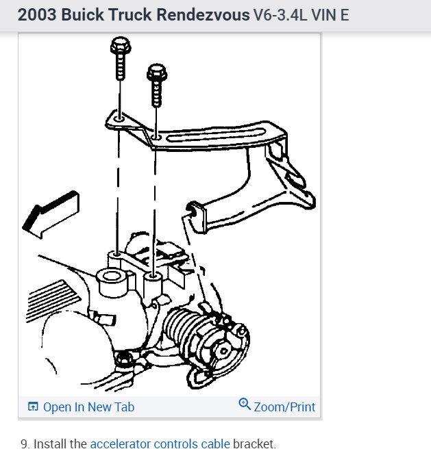

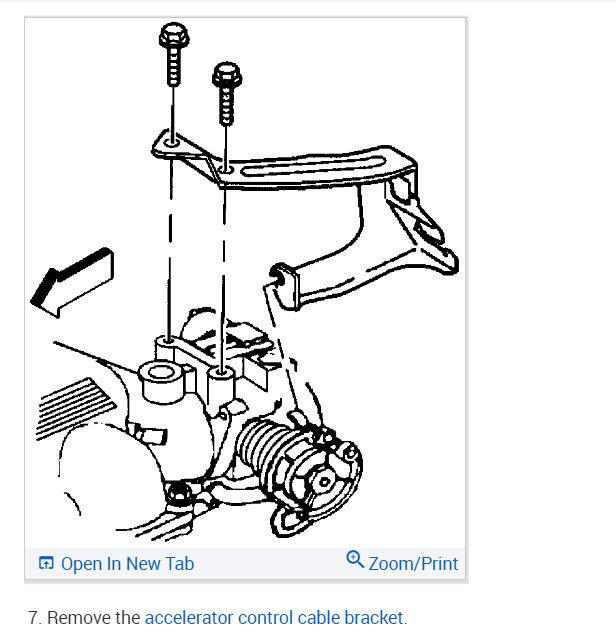

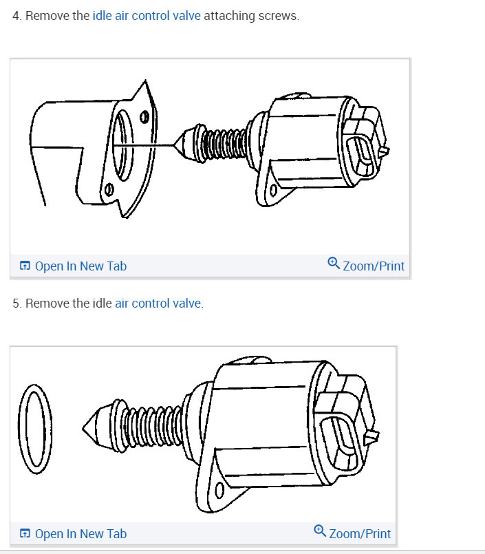

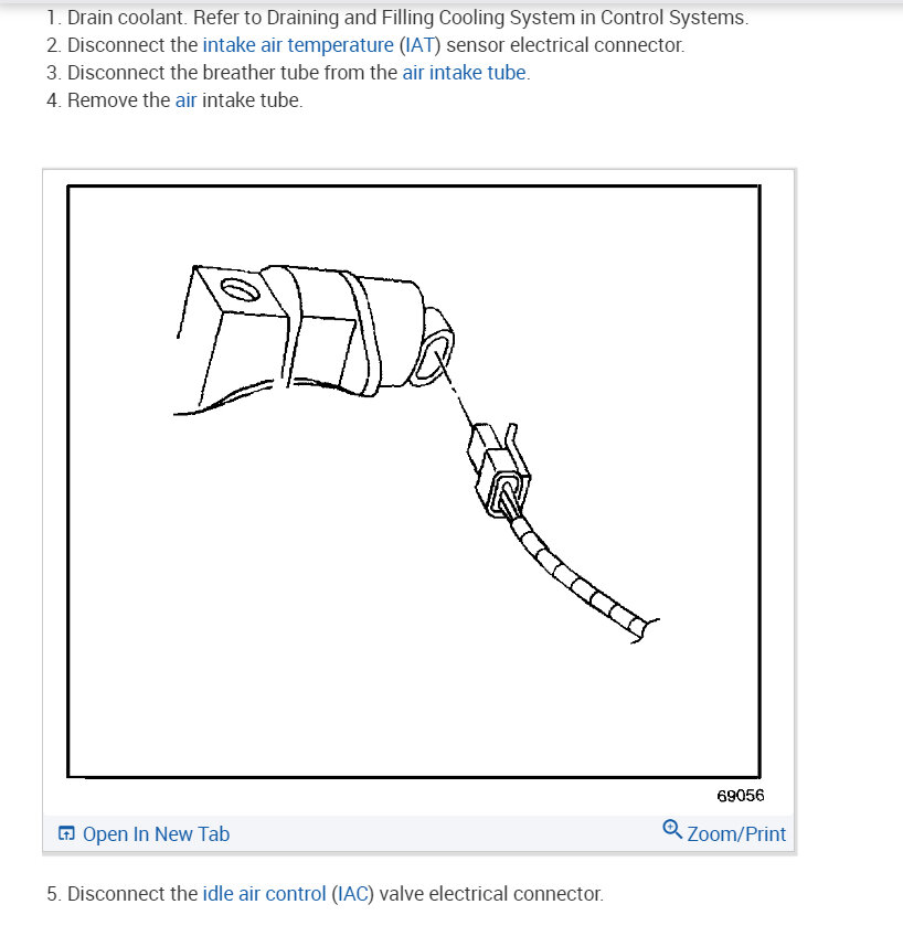

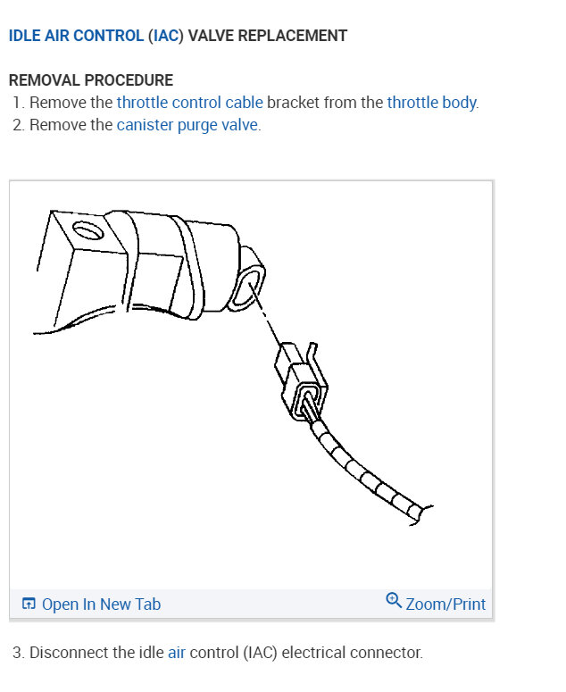

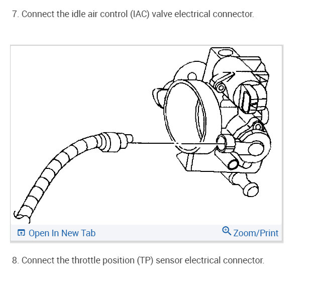

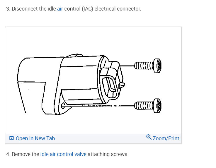

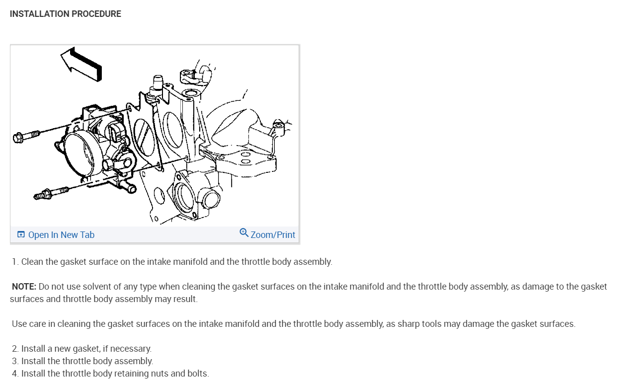

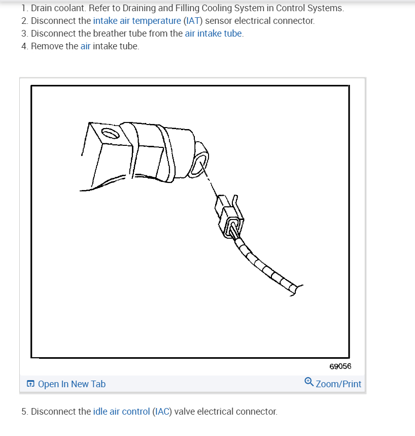

This is common when the throttle bore needs to be serviced. IAC motor needs to be replaced or you have a vacuum leak. here are two guides to help you fix the problem with instructions in the diagrams below to help you with your car:
And this guide, only do this when the engine is cold:
This guide can help as well:

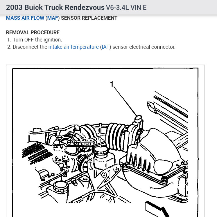

I got the car diagnosed by AutoZone, it was a code P0300.
Oct 18, 2022 at 3:20 AM
  • 55,479 POSTS

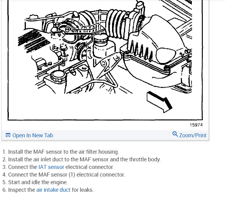

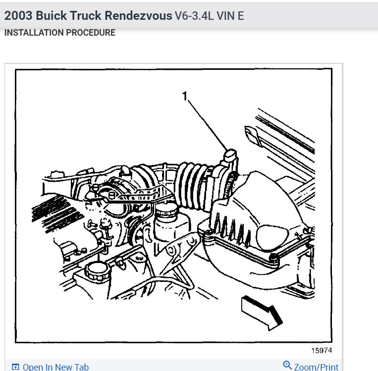

Okay, usually when this code is present it will be the fuel pump is going out or you have a MAF sensor that has gone out here is the location of the sensor so you can check it out. also, to check the fuel pressure you can follow this guide:
Fuel Pressure (Key ON Engine OFF) .................... 358-405 kPa (52-59 psi)
