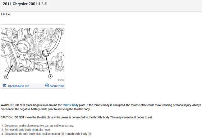

My car has been stalling on me but starts right back up. it stalled on me yesterday and I pulled off road and sat couple minutes and started it back up and ran fine.
Oct 24, 2024 at 4:32 AM
  • 55,740 POSTS

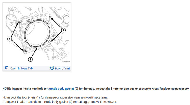

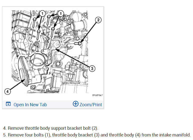

Yep, this will happen when the throttle bore needs to be serviced, please follow this guide and I will leave instructions for your car in the images below.
Please go over this guide as well, which shows other possibilities:
Check out the images (below). Please upload pictures or videos in your response of any problems so we can see what to help you with.
