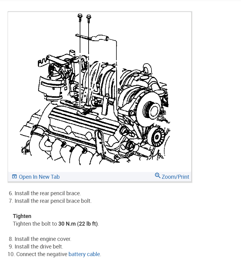

This happens when the alternator stops working, but to be sure you can jump start the car and test the alternator by using this guide:
Here is a video that will help you jump start the battery:
https://youtu.be/a9Ycibu9cwY

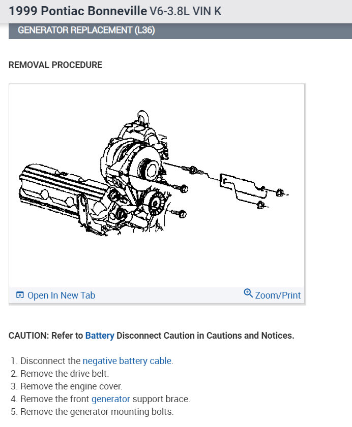

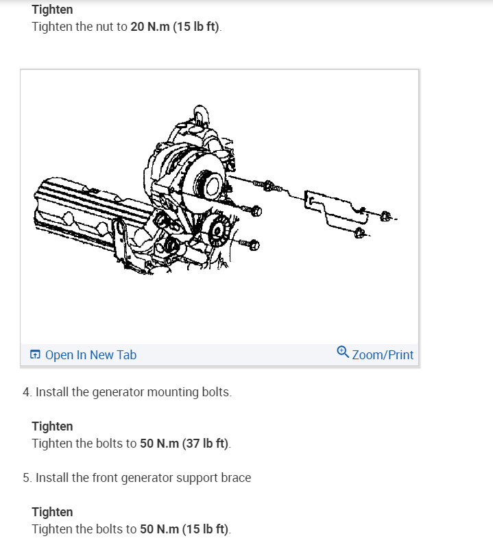

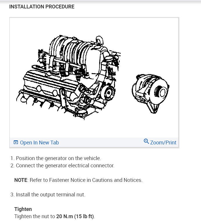

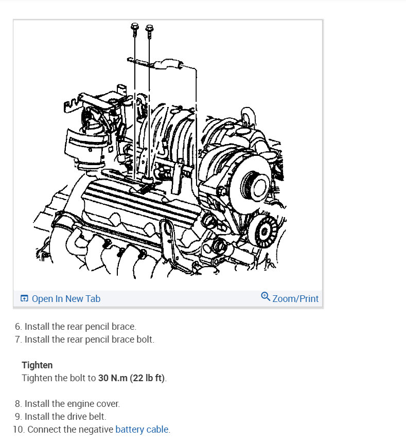

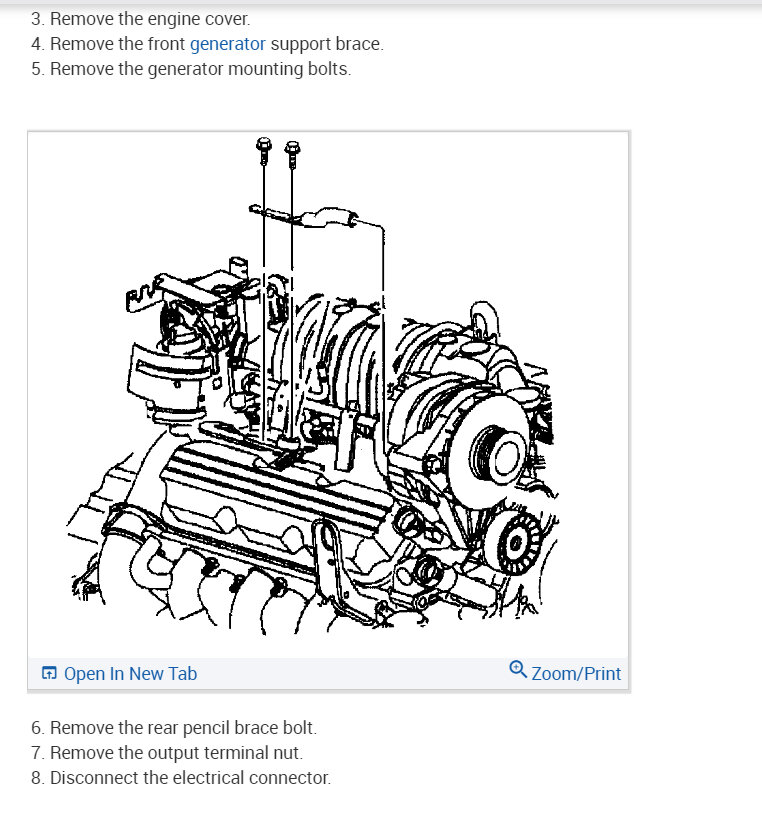

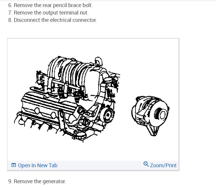

This guide can help walk you through the steps of the alternator replaced with instructions in the diagrams below to help you with your car:
https://www.2carpros.com/articles/how-to-replace-an-alternator
