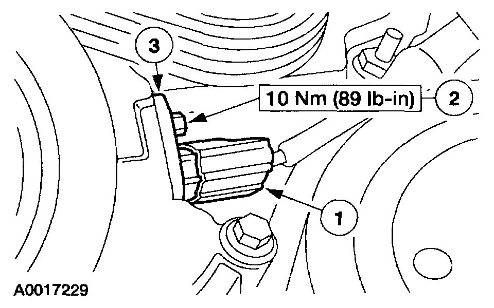

When I drive the car somewhere park and turn it off and suddenly decide I need to go leave right away and start the car back it will start but it knocks off. I have to wait 30 minutes or so before it will start. It doesn't do it all the time but at least once a week.

That could be a few things. The idea that it happens when the engine is warm leads me to believe it could be related to the crankshaft position sensor. Take a look at this link and let me know if it mirrors what you experience:
The best way to confirm is to either check for ignition spark when it won't start or check for an RPM signal when it won't start. To check for an RPM signal requires a live data scan tool. However, here is a link that shows how to check for spark without a scanner:
If you find no spark, then I would replace the sensor. Here is a link that shows how to in general:
Here are the directions specific to your vehicle:

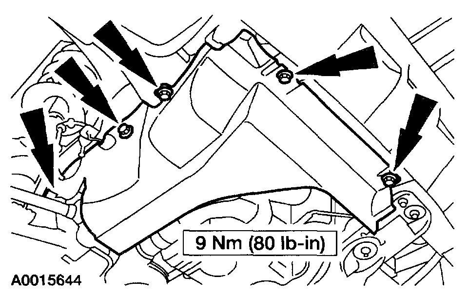

1. Raise and support the vehicle.
pic 1
2. Remove the bolts and the right front lower splash shield.
pic 2
3. Remove the Crankshaft Position (CKP) sensor.
1 Disconnect the electrical connector.
2 Remove the bolt.
3 Remove the sensor.
INSTALLATION
1. To install, reverse the removal procedure.
