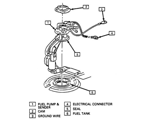

When I turn it on sometimes turns back off. also when I press the gas pedal on a stop it stalls. changed the fuel regulator and spark plugs.
Sep 16, 2021 at 4:36 PM
Experienced Mechanic
52,796 POSTS
Good morning,

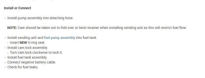

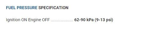

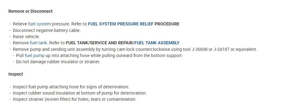

I would start by testing the actual fuel pressure. It could be a bad fuel pump causing this issue.
https://www.2carpros.com/articles/engine-stalls
https://www.2carpros.com/articles/how-to-replace-an-electric-fuel-pump
You can rent a tester at a parts store for this test.
Let us know if you have any other questions
