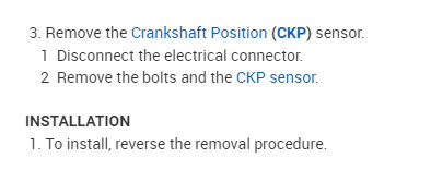

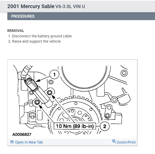

What you described sounds like a failing crankshaft position sensor. When they begin to fail, they are adversely affected by heat. Once they cool off, they start working again.
Do me a favor. Take a look through this link and let me know if you feel anything mirrors what you experience:
If you haven't already, check to see if there is spark to the plugs when it won't start.
Here is a link that explains how that is done:
https://www.2carpros.com/articles/how-to-check-for-ignition-spark
If there is no spark, this is my first suspect. I attached the directions below specific to your vehicle for the replacement of the sensor.
