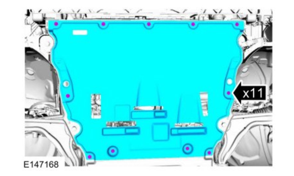

2. Refer to: Jacking and Lifting - Overview See: Vehicle Lifting > Procedures > Jacking and Lifting (Vehicle Jacking and Lifting). See: Vehicle Lifting > Procedures > Jacking and Lifting

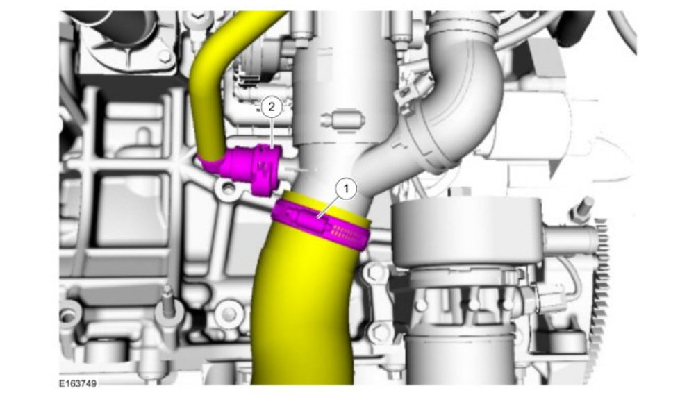

1. Torque: 5 Nm
2. Refer to: Quick Release Coupling See: Fuel Line Coupler > Procedures > Quick Release Coupling (Fuel System - General Information).

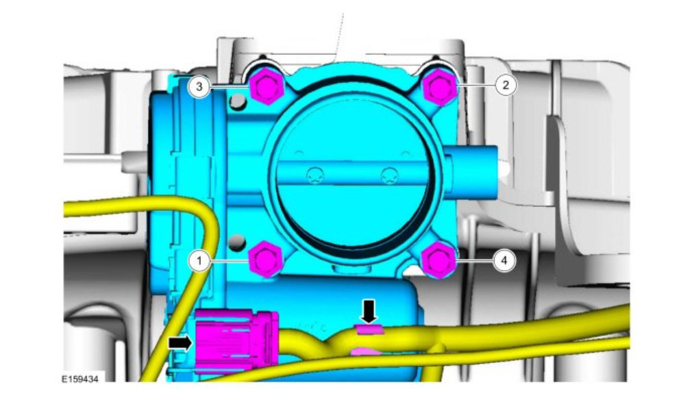

6. NOTE: When disconnecting the Throttle Body (TB) electrical connector disengage the red locking tab on the Throttle Body (TB) electrical connector by sliding it to the rear of the Throttle Body (TB) electrical connector, away from the Throttle Body (TB). Squeeze the Throttle Body (TB) electrical connector while removing.
NOTE: When connecting the Throttle Body (TB) electrical connector engage the red connector locking tab after fully installing the Throttle Body (TB) electrical connector. The red tab will not slide forward unless the Throttle Body (TB) electrical connector is fully installed.
Torque: 10 Nm
Help See: Vehicle > Components > About This Information
7. NOTE: Make sure that a new Throttle Body (TB) gasket is installed.

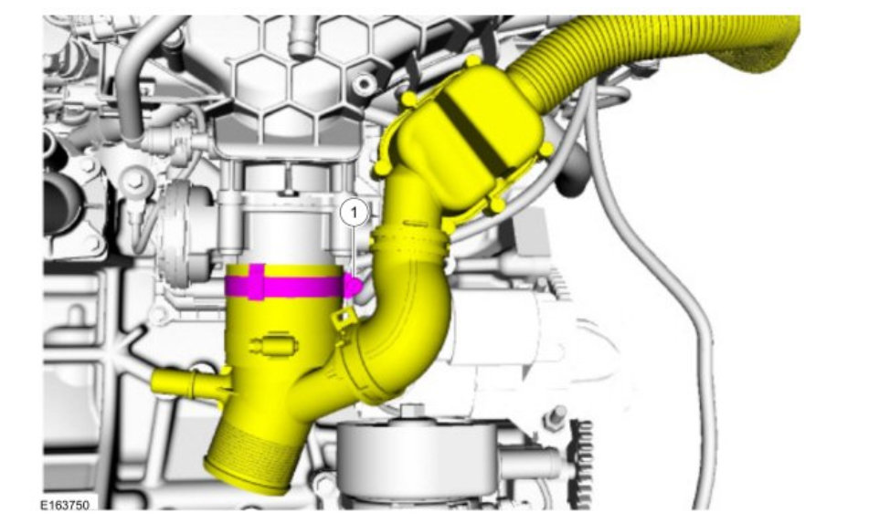

This year model car has no throttle cable it's all driven electrically. I know how to do everything with cleaning throttle body and relearning the throttle position sensor with my computer diagnostic tool I just need to know where the location of the throttle body is on this particular vehicle. I followed the air hose tube are Boot and it goes from the driver side engine compartment all the way down to the passenger side on the back side of the engine. I cannot see exactly where the throttle body is located. if you could pinpoint that for me I would sure appreciate it. this car is not turbo it is just a 1.6 l EcoBoost.
Jan 11, 2019 at 8:23 AM
It is buried down on the intake manifold.
Did you remove the top cover from the motor and follow the intake tube from the air filter?
Jan 11, 2019 at 8:42 AM
RAYW1961
Yes I did. the air tube runs down to the side of the bottom of the engine not underneath it but to the side. I guess I'll put it up on the lift and see if I could see it better from the bottom. never seen one located there before but that's where the air tube ends. Thanks for all your help.
