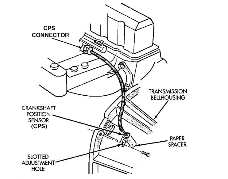

I will be driving the temperature gets up to a quarter then as I am driving she will start to sputter and jerk. Help please it is the only vehicle my family has.

How long since you had the plugs wires, cap and rotor replaced?
I would start with basics for the ignition system.
Is the check engine light on?

No check engine light and replaced plugs wires rotor cap and button a month ago.

Okay, the next possibility is the crank sensor. It is located on the bell housing of the transmission on the drivers side at the top. The harness comes in to the engine area behind the distributor. It will kill the spark signal if it is bad. Also, a common issue.

I will try that. Any specific way to remove that sensor?
Jul 29, 2018 at 5:56 AM
If you have small hands, you can get it from the top.
I do not, so I get it from the bottom. One bolt and the connector. You can get it at any parts store.
