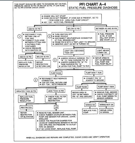

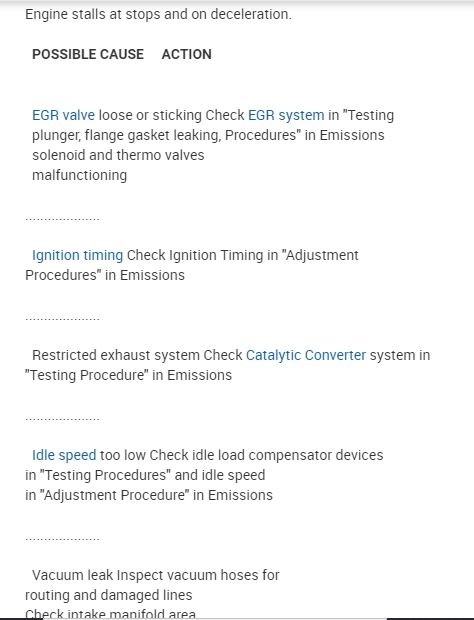

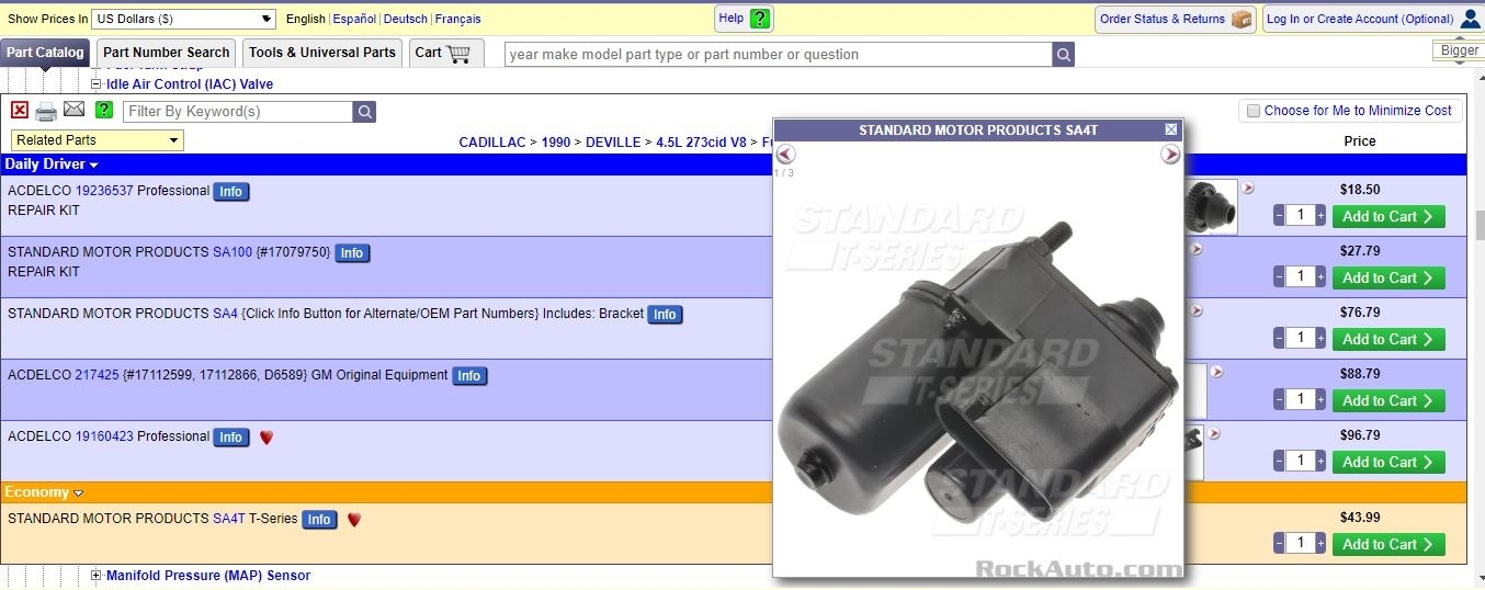

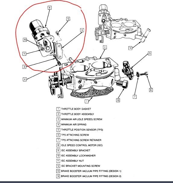

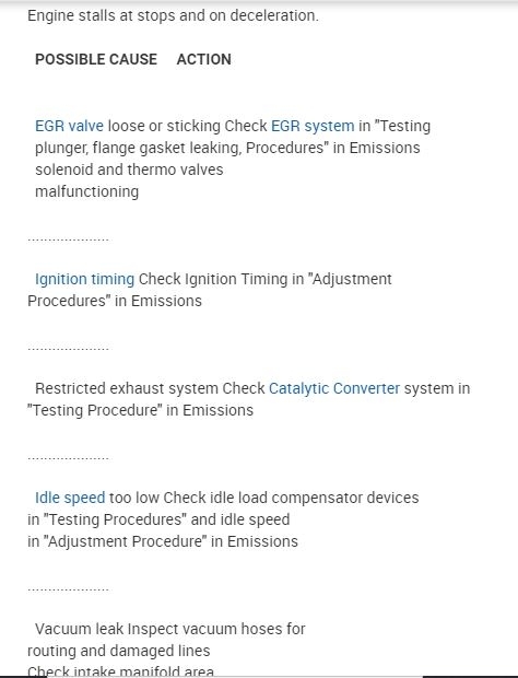

Car is hard to start. But then idles fine once it warms up. Shuts off when it is put in drive or rev.
Tuesday, February 18th, 2020 AT 2:06 PM
MECHANIC
52,797 POSTS
Good evening,

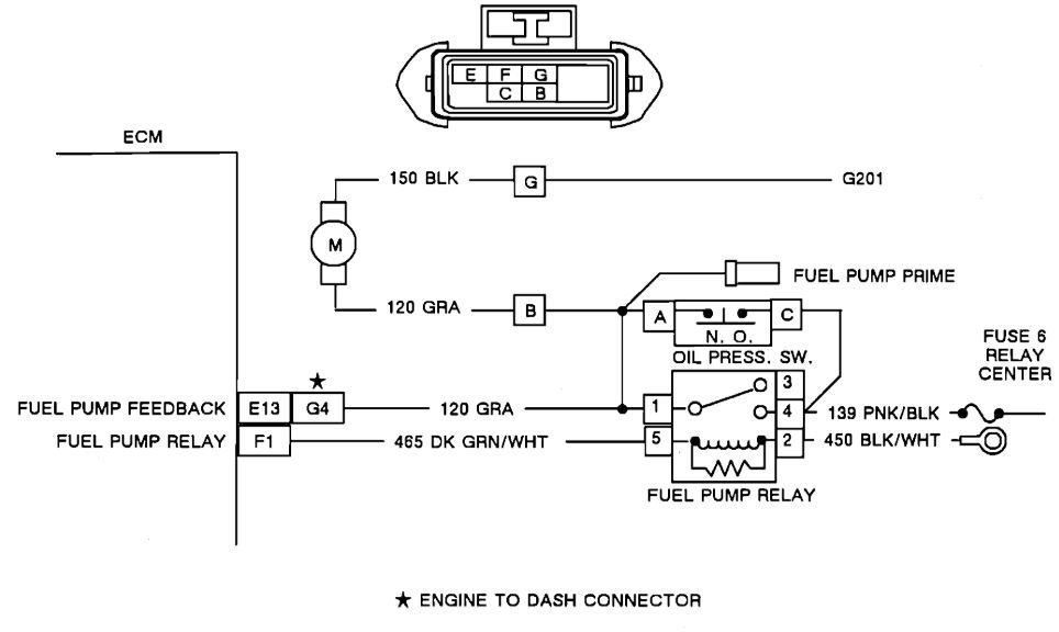

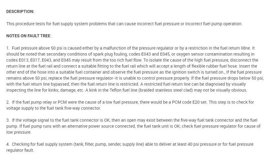

The first thing I would do is check the fuel pressure. It would explain both issues.
You can rent a tester at a parts store.

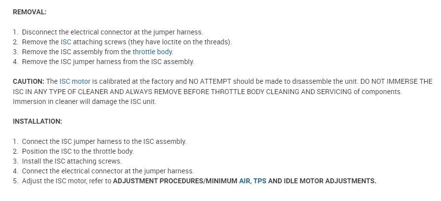

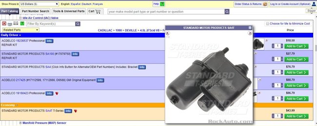

There is a motor on the throttle body that can cause the stalling going into gear. That could be the reason for this.
