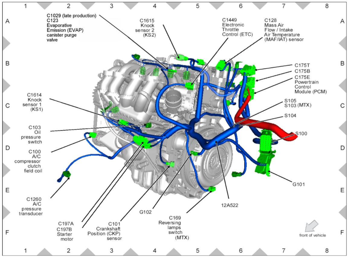

The car engine shuts off all of a sudden while driving, always restarts though.

This sounds like you have a crankshaft angle sensor that is going out. Here is a guide and some diagrams (below) to help you get the problem fixed.
This will give you an idea of what you are in for when doing the job.
Here are some additional guides to help you.
https://www.2carpros.com/articles/engine-stalls
Please let us know what happens, we are interested to see what it is.
