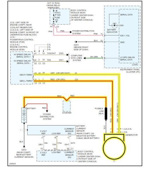

Good afternoon,
I would start by checking the battery. Your battery may have died while driving and the resulting low voltage shut off the car.
https://www.2carpros.com/articles/symptoms-of-a-bad-car-battery
The charging system would need to be tested as well.
