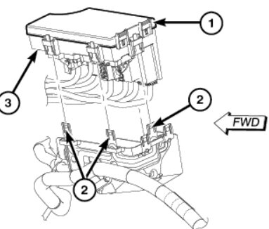

I checked all 4 relays and found them in working order, but the plugin strip had a female terminal (the one on the far passenger side) that was hot in the 85 and 86 holes, not on the 85 and 30 holes. I lifted the terminal block and found those lead wires to have 13 volts on the 85 and 86 positions. Isn't that odd? The wires seem normal and not charred or corroded.
