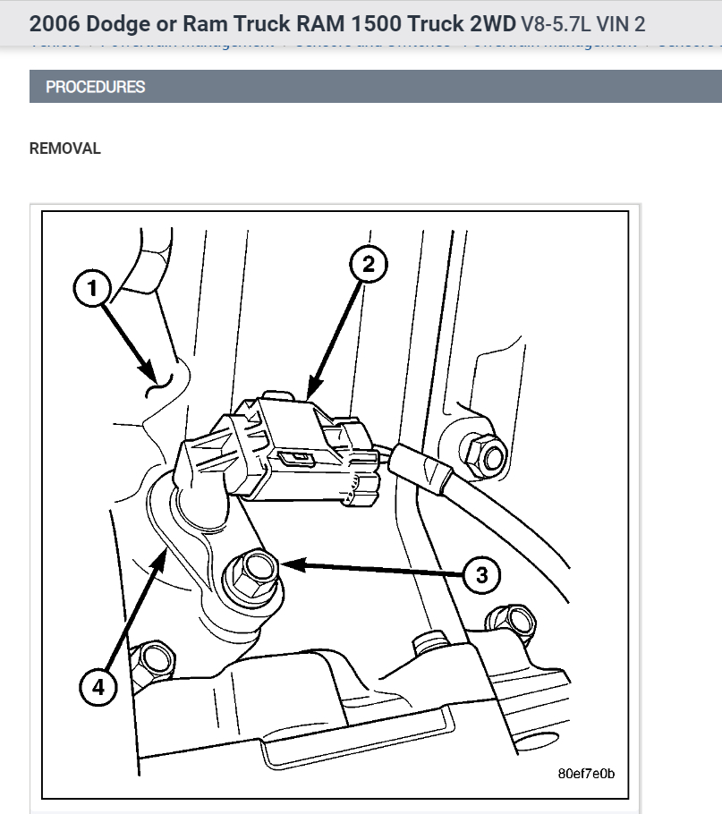

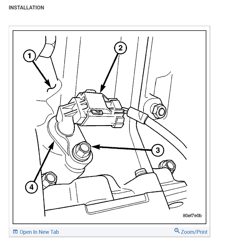

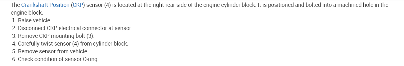

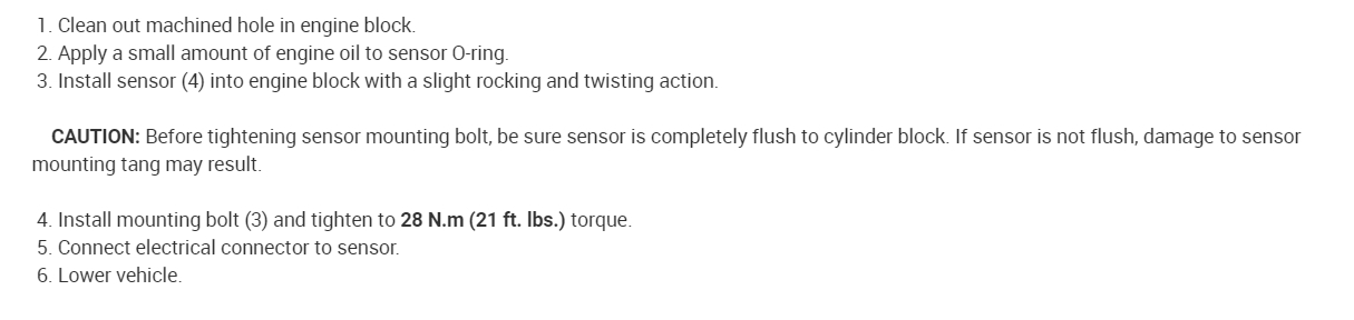

Those scanners work okay, can I ask when you turn the key on without cranking the engine over do you hear the fuel pump running inside the fuel tank for about 5 seconds? Also, I would try starting fluid to see if the engine and ignition systems are okay. It sounds like the fuel pump or crankshaft angle sensor has gone out. This guide can tell us the spark has stopped and I have left instructions in the images below on how to change out the crankshaft angle sensor in case you need it.

If the crankshaft (or camshaft) position sensor is bad, would that prevent the fuel pump from being commanded on?
Is there a way to test the crankshaft position sensor before I replace it? My Chilton guide usually shows me what pins to connect to in order to test resistance on a sensor, but it only shows how to remove it (kind of like the guide you attached for me), and it doesn't say how to test it?

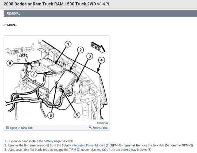

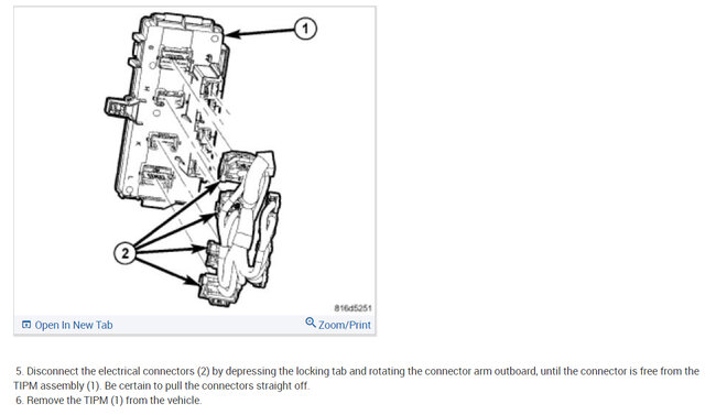

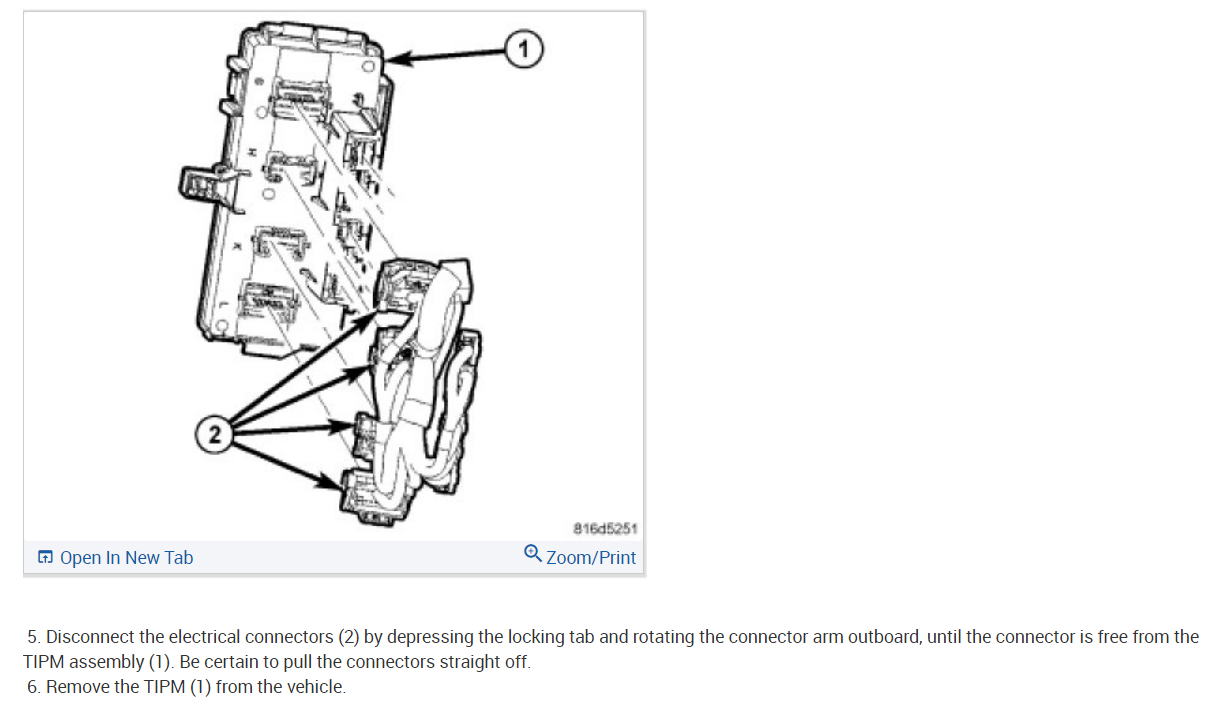

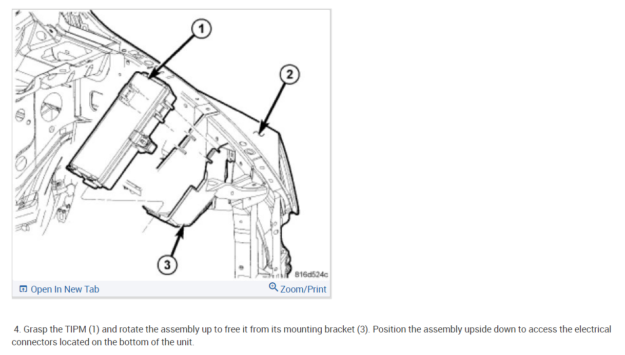

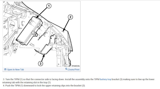

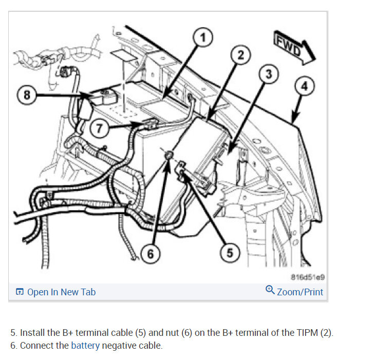

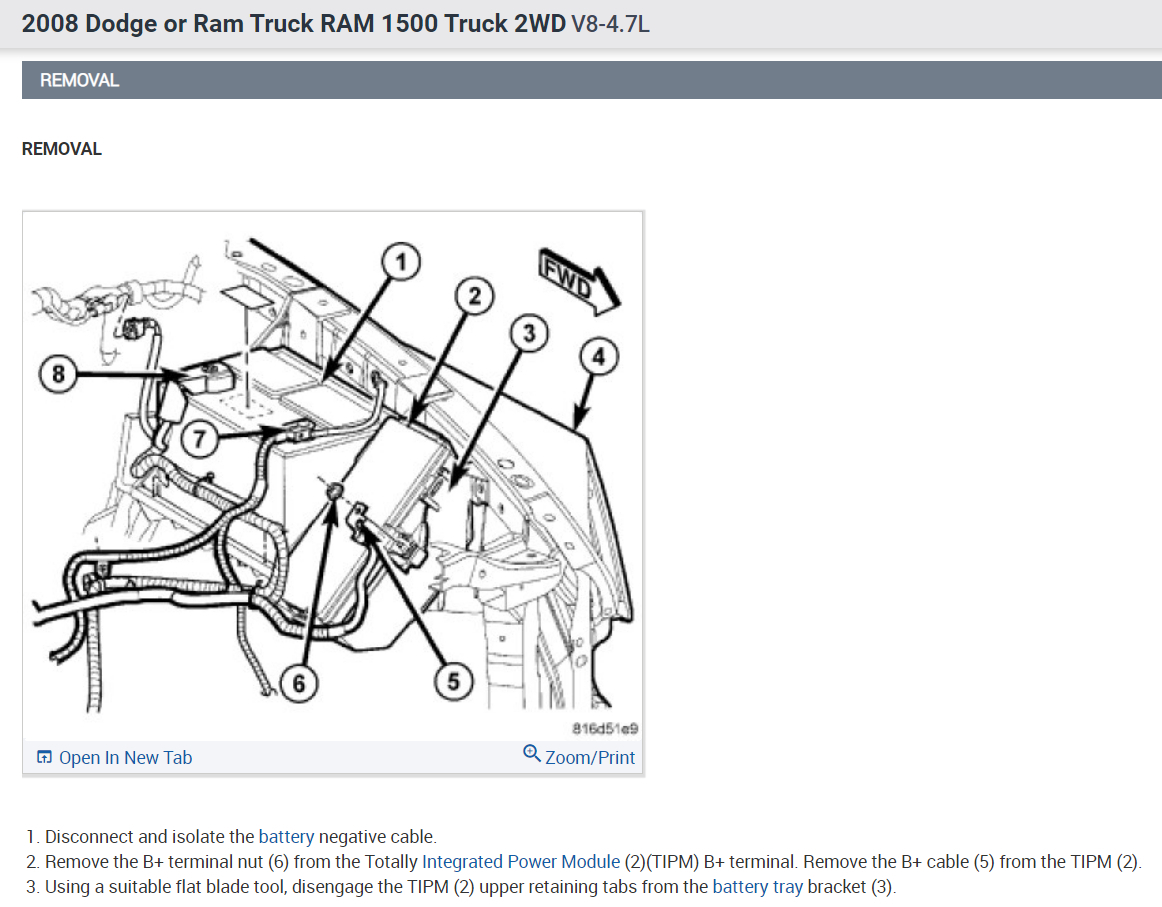

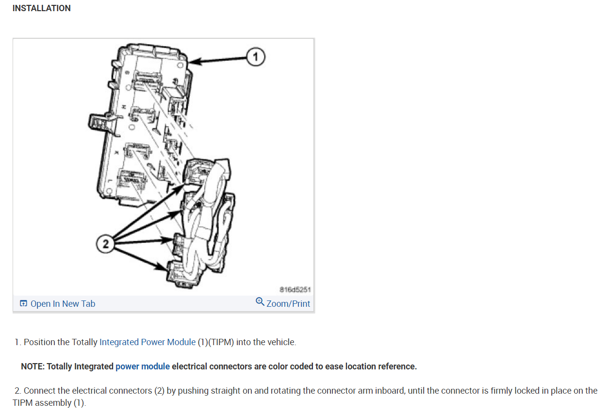

Yes, if the crankshaft sensor is bad, it can cause the computer to not turn on the fuel pump. You can use an oscilloscope to test the sensor, just look for a smooth sign wave. I looked up the fuel pump relay and there is none. It is controlled by the TIPM which they had big problems with which I think that is what is wrong with your truck. You might want to run a CAN scan to confirm. You can get a CAN scanner (Controller Area Network) which will work on most cars from Amazon.
https://youtu.be/u-4syLc-ifQ
and

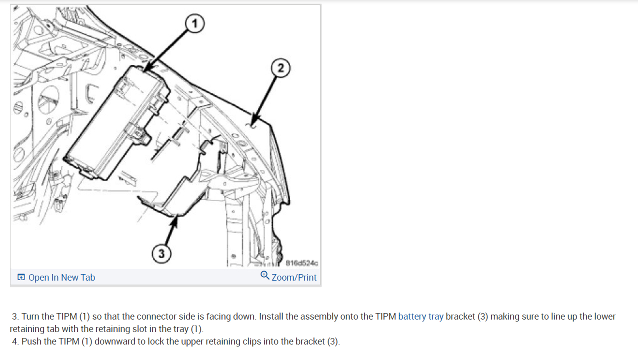

Here is how to replace the TIPM in case you need it which is easy to replace because it-self learns. Check out the images (below). Please let us know what happens.
