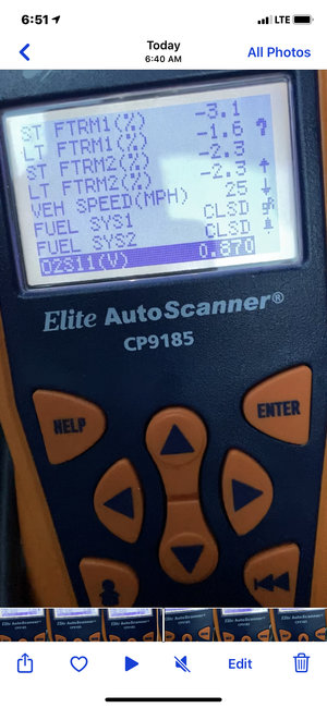

Okay Joe, the engine temperature is at 73 before I started and the thermometer in the car says it’s 65. Attached is a picture of about the time that it would normally do it although it did not do it this time. I did run a three minute video from just after starting all the way until virtually near full warm-up so I can go back and review that if you need me to.
May 11, 2020 at 8:55 PM
  • 110,244 POSTS
Did the ECT indicate the correct temps as the engine warmed up? Also, the fuel trims indicate the computer is trying to lean the mixture, but it's really not that far out of line.
Let me know about the temp readings. And I hate to say it, but it may not indicate a problem until the problem actually happens. You may need to do this again and hope the problem occurs.

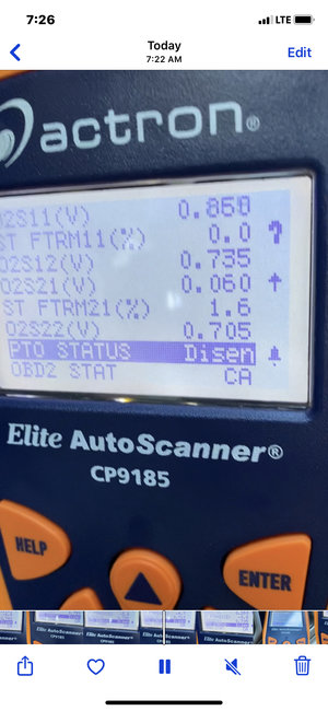

Thanks again for getting back. I think I mentioned that the ambient temperature yesterday morning was around 68° and before I even started the vehicle the temperature showed through the OBD 73° All four 02 sensors are brand new. This picture was taken around the time it would stall, but naturally for the past two days it has not reared its head.
May 12, 2020 at 9:27 PM

I don’t think the picture attached so here it is again.

I will continue each morning until it happens and the. Report back - so I don’t bother you. But, can you tell me what you want the scanner looking at when it does occur? O2 or Fuel Trim or?
May 12, 2020 at 10:26 PM
  • 110,244 POSTS
You are in no way bothering me. Please feel free to come back as often as needed. As far as what is happening, check for both. If I had to choose, I would say fuel trim. If an o2 sensor is causing problems, I should be able to recognize it via that reading.

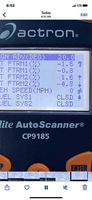

You are such a blessing. Okay, this morning the outside ambient temperature was around 68. I was recording for four minutes as the engine was warming up and I was driving. Right around the three minute mark of the video the temperature gauge was reaching around the point where I have issues. Although it did not stall this picture that I’m attaching shows that the RPM's were dropping to probably around 450 and normally it would idle at around 550. I could see the needle starting to fluctuate like it normally does. And this is as close to the condition as I can get without a stall. It showing all of the fuel trims leaning out pretty good. I have did the test previously were you spray carpet cleaner around the intake to see if there’s any vacuum leaks but didn’t have any detected. I also made sure all the intake bolts were torqued correctly. As I mentioned all the O2 sensors are brand new I just put them in a week ago.
May 13, 2020 at 9:02 PM
  • 110,244 POSTS
Did you send a video? Also, the trims indicate the computer is trying to reduce the fuel to the engine. It is getting more than is needed. But it isn't totally out of the norm. Was it fluctuating when this happened?
