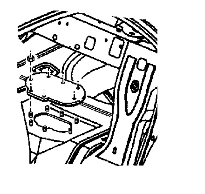

After the engine warms up, the engine stalls out
165,000 MILES • 3.1L • V6 • 2WD • AUTOMATIC
POGLE00

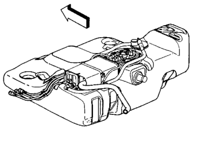

The fuel pressure good, got spark, runs on a cleaner sprayed into manifold. once engine is cooled off it will start, fuel not getting into engine.
Jun 19, 2022 at 11:37 AM
  • 55,500 POSTS

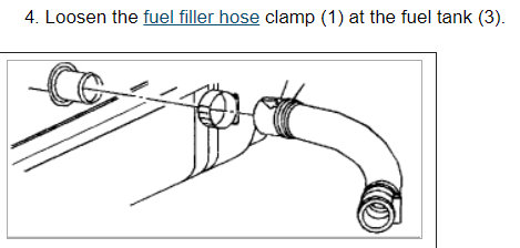

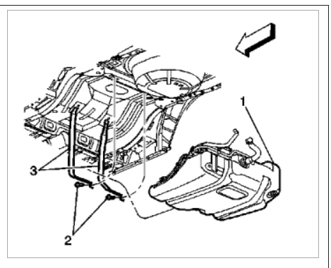

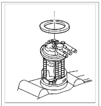

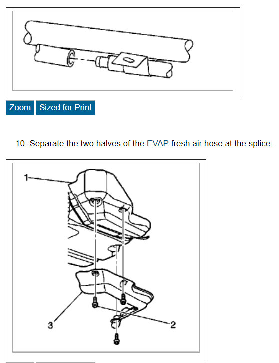

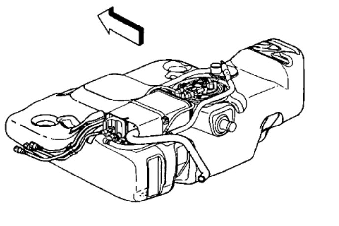

This is common when the fuel pump starts to go out. To be sure we can check the fuel pump when the engine is not running. Please follow this guide, I have also included how to change the pump out in the instructions below.
