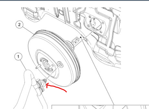

So, I got my car back and took my daughter to school today and I noticed when I was stopped at a long light, holding my foot on the brake, that the car started running rough again. When I got home, I sat in the driveway with my foot on the brake, and after about two minutes of idling, my car started puttering like it was going to stall, but it never did. I then switched to Park and it’s been five minutes and it’s idling just fine. Could having a vacuum leak in my brakes cause my car to run rough somehow?
Oct 23, 2023 at 5:25 AM
  • 54,832 POSTS

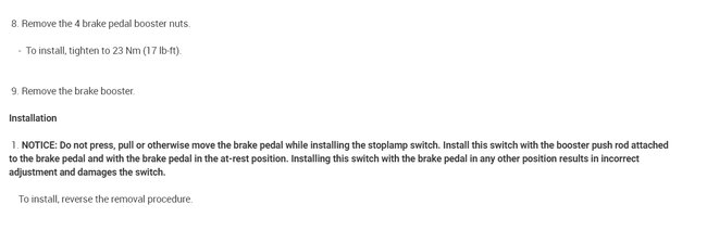

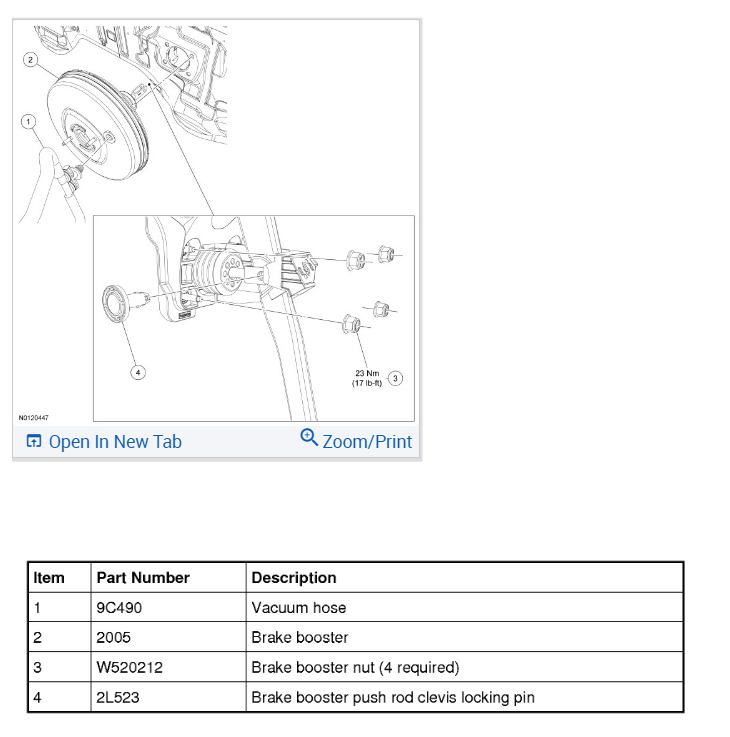

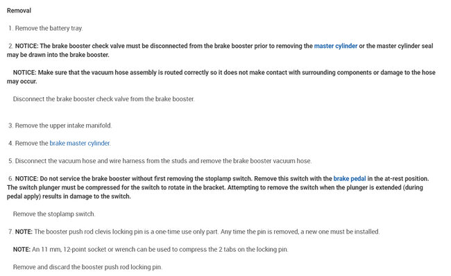

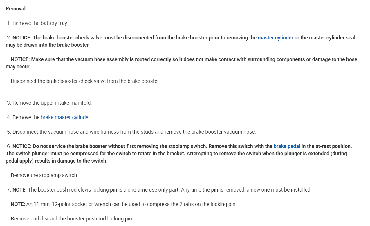

Yes, chances are the oxygen sensors were not bad, these codes come up when the engine is getting too much air which can be caused by a vacuum leak. With the engine off, remove the vacuum check valve from the brake booster and you should hear air escaping. Here is the location of the valve. Also, here is a guide that you should use when the engine is cold:
If you don't hear air escaping the booster is bad, here is how to replace it. Check out the images (below). Please let us know what happens.
