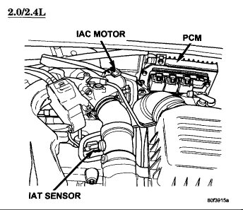

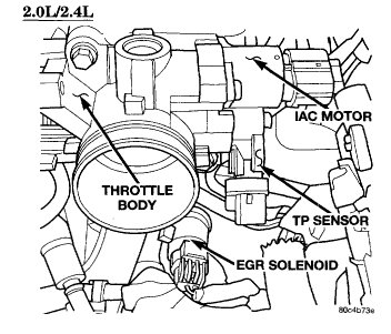

Hi and thanks for using 2CarPros.com. This could be the result of a few things. First, I am going to recommend checking for engine vacuum leaks. Here is a video that will guide you:
https://youtu.be/4ktw1X4W_-k
If no leaks are found, I would question the idle air control valve, IAC. Here is an explanation of its function and how it works:
https://www.2carpros.com/articles/how-a-idle-air-control-valve-works
Here are directions on how to clean one:
https://www.2carpros.com/questions/how-to-clean-idle-air-control-valve
I have attached two pictures to help you locate it. If it needs removed removed for cleaning or replaced, just disconnect the electrical connector from it. Then there are two torx screws which hold it in the throttle body. Remove the screws and the IAC. Replacement is opposite of removal.
I hope this helps.

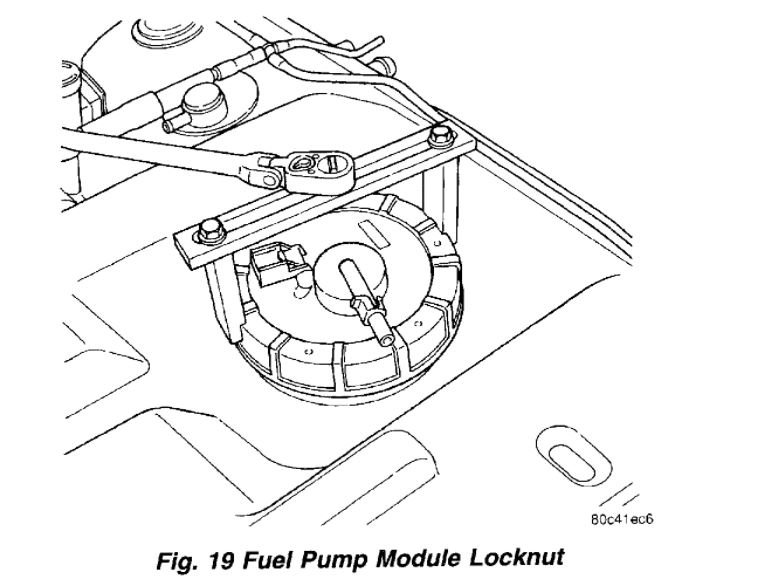

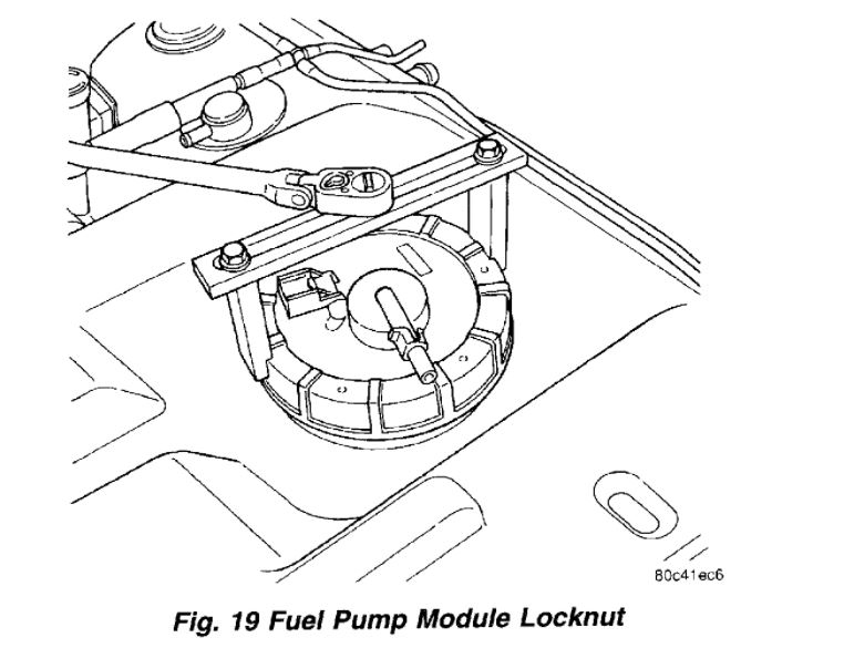

Changed the fuel pump, it idles fine but when you give it gas it stalls. What is wrong?
Jul 1, 2021 at 6:22 AM (Merged)
Okay, the first thing I would do is verify the fuel pressure. If it is low, this will happen.
https://www.2carpros.com/articles/engine-stalls
Fuel System Pressure
Deadhead Pressure 880 kpa (130 psi)
Regulated Pressure 400 +/- 14 kpa (58 +/- 2 psi)
NOTE: The electric fuel pump is not serviceable. If the fuel pump or electrical wiring harness needs replacement, the complete fuel pump module must be replaced.
WARNING: release fuel system pressure before servicing fuel system components. Service vehicles in well ventilated areas and avoid ignition sources. Never smoke while servicing the vehicle.
REMOVAL
1. Remove fuel filler cap and perform Fuel System Pressure Release procedure.
2. Remove the air cleaner lid, disconnect the inlet air temperature sensor and makeup air hose.
3. Remove the negative battery cable.
4. Raise vehicle and support.
5. Remove fuel tank.
6. Clean top of tank to remove loose dirt and debris.
7. Disconnect fuel filter lines from fuel pump A module.
Fig.19 Fuel Pump Module Locknut
8. Using Special Tool # 6856 Fuel Pump Module. Ring Spanner, remove locknut to release pump module (Fig. 19).
WARNING: the fuel reservoir of the fuel pump module does not empty out when the tank is drained. The fuel in the reservoir may spill out when the module is removed.
9. Remove fuel pump module and seal from tank. Discard seal.
INSTALLATION
1. Wipe seal area of tank clean. Place a new seal between the tank threads and the pump module opening.
2. Position fuel pump module in tank. Make sure the alignment tab on the underside of the pump module flange sits in the corresponding notch in the fuel tank.
CAUTION: Over Tightening the pump lock ring may result in a leak.
3. While holding the pump module in position, install locknut. Tighten locknut to 74.5 Nm (55 ft. lbs) torque using special tool # 6856.
4. Install fuel tank.
5. Lower vehicle.
6. Install the negative battery cable. A
7. Install the air cleaner lid, connect the inlet ail temperature sensor and makeup air hose.
8. Fill fuel tank with clean fuel. Use the DRB scan tool to pressurize the system and check for leaks.

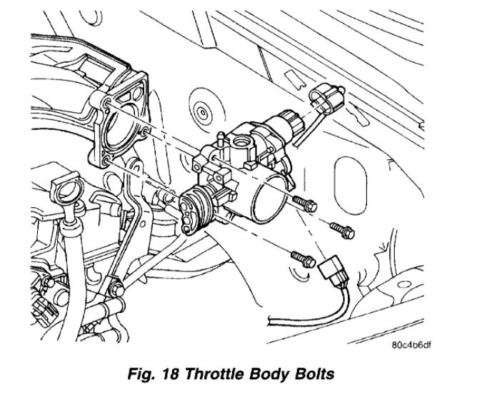

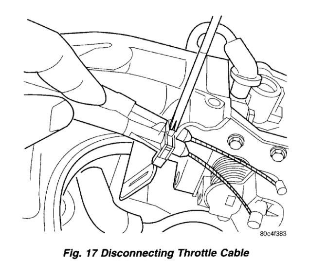

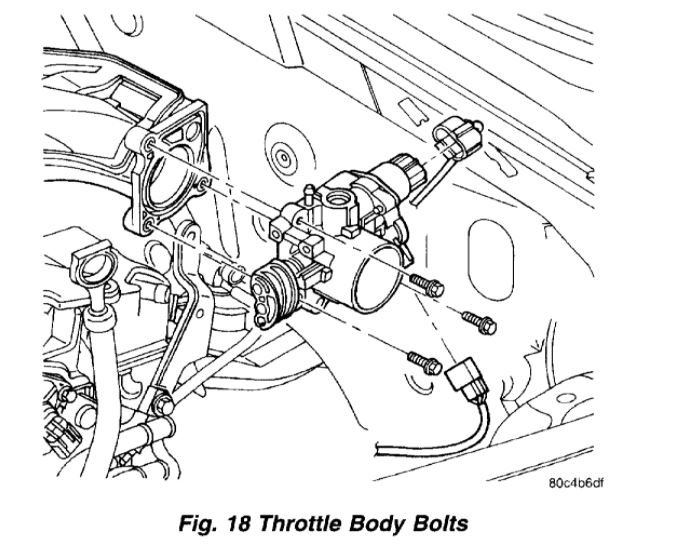

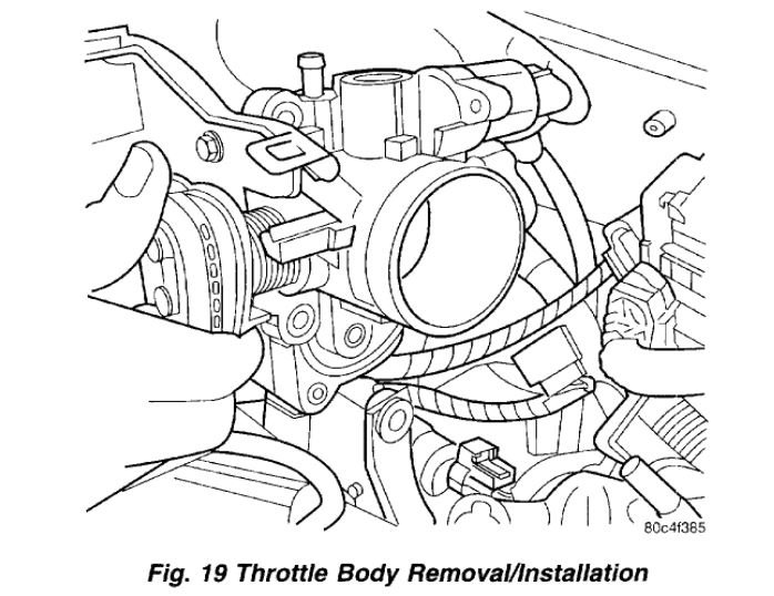

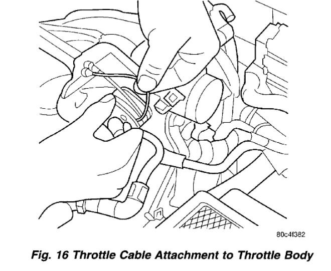

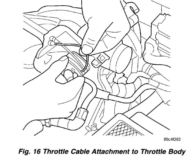

You also need to check the throttle body and make sure there is no carbon deposits on the plate.
https://www.2carpros.com/articles/how-a-throttle-body-works
I attached some guides for the cleaning below for you.
The content of this article reflects the changes called out by TSB 26-07-00.
REMOVAL
1. Remove the air cleaner lid, disconnect the inlet air temperature sensor and makeup air hose.
2. Remove the negative battery cable.
3. Remove the engine cover or throttle control shield if equipped.
Fig.16 Throttle Cable Attachment To Throttle Body
Fig.17 Disconnecting Throttle Cable
4. Remove throttle cable from the throttle body lever (Fig. 16) and (Fig. 17).
5. Lift the retaining tabs on the cable and slide cable out of bracket.
6. If equipped with speed control, remove speed control cable from throttle lever by sliding clasp out hole used for throttle cable.
7. Remove EVAP purge hose from nipple on throttle body.
8. Remove the electrical connectors from the throttle position sensor and idle air control motor.
9. Remove 2 screws holding cable mounting bracket and support bracket.
Fig.18 Throttle Body Bolts
10. Remove throttle body mounting bolts (Fig. 18).
Fig.19 Throttle Body Removal/Installation
11. Lift throttle body straight up and to remove the throttle body (Fig. 19).
