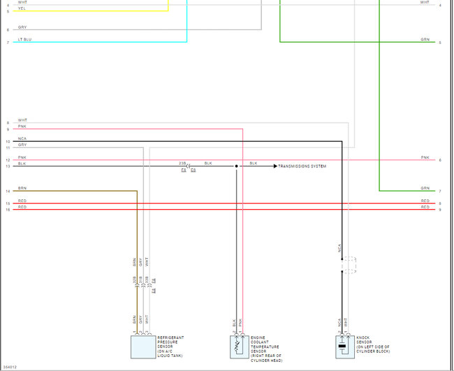

I’m having same problem after replacing fuel pump (I did not replace the gasket under new fuel pump). Car stalls while driving. Idle is smooth. Car starts up ( even when in motion, only one time after refueling the car took like 4 times to start and stall. That was before pump replacement) looks like it stalls when I let off gas pedal. No check engine light. I got the car at the auction so idk the history but looks like someone was trying to work on it before ( ground wires are clean. Looks like after market pump). Car is 4 speed automatic.
Jun 15, 2024 at 10:42 PM
  • 55,433 POSTS

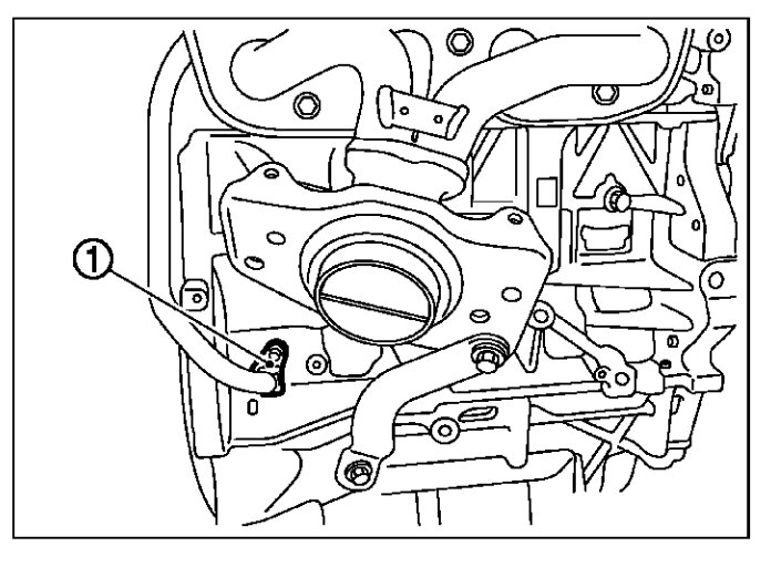

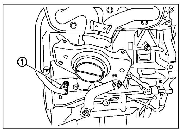

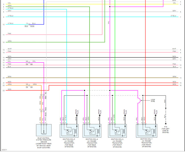

I have seen the crankshaft angle sensor start to go out and cause this issue, this will not create a check engine light as well, so it fits. but you should run the codes anyway to see if any codes are pending.
This guide may help as well, and I have included the location of the crankshaft sensor, so you know which sensor to check out.
https://www.2carpros.com/articles/engine-stalls
The crankshaft sensor is on the right side of the engine block towards the rear down low. Check out the images (below). Please upload pictures or videos in your response to any problems so we can see what to help you with.
Jun 16, 2024 at 5:51 AM
MAROZ
  • 22 POSTS
Thank you for your help. I just replaced bad and crankshaft sensor. Still the same problem. Anything else I can change or check? Thank you

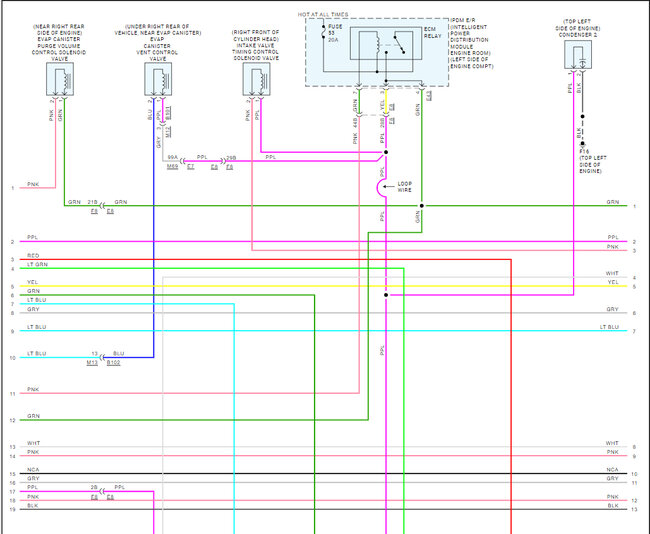

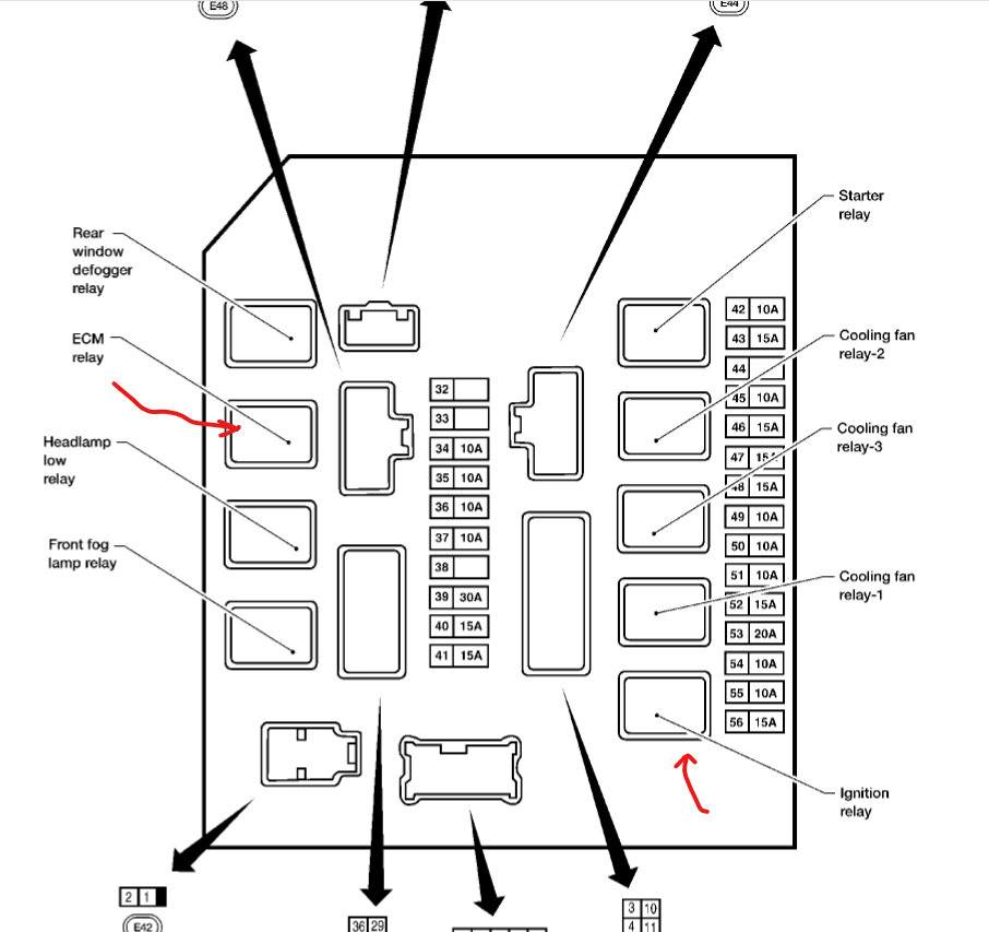

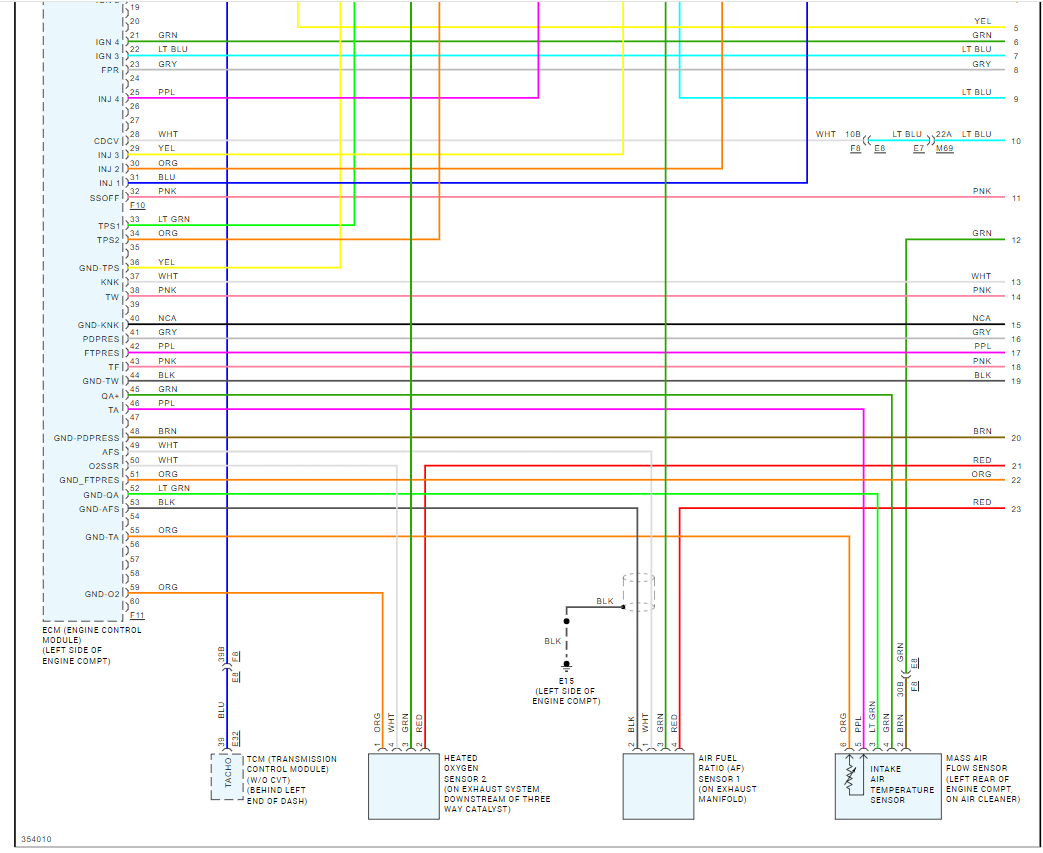

Have you run the codes to see if any are stored? I have seen the ignition relay or PCM start to overheat and go out which can cause the engine to stall without setting a code. Here are the locations so you can swap them out to see if that fixes the problem. Check out the images (below). Please let us know what happens.
Jun 23, 2024 at 3:34 AM
MAROZ
  • 22 POSTS

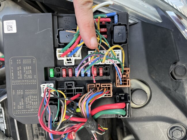

No codes. I just replaced throttle body and that didn’t fix it. My wiring fuse box is different than the one you sent me.
Jun 23, 2024 at 11:08 AM
  • 55,433 POSTS
Yes, that is different, is this a euro car? Also, I see a bunch of cut wires?
Jun 24, 2024 at 3:15 AM
MAROZ
  • 22 POSTS
I got the wiring box from junkyard. Mine is the same as the one in the picture. The versa is plain. Nothing special. Nothing is power, only mirrors.

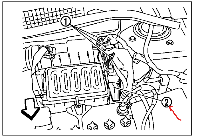

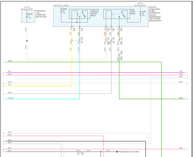

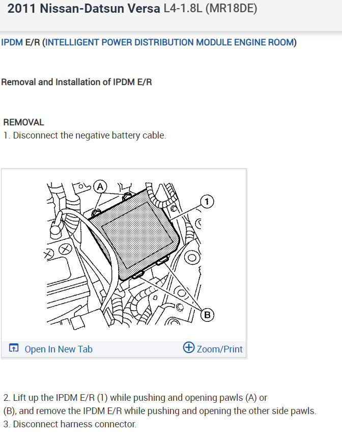

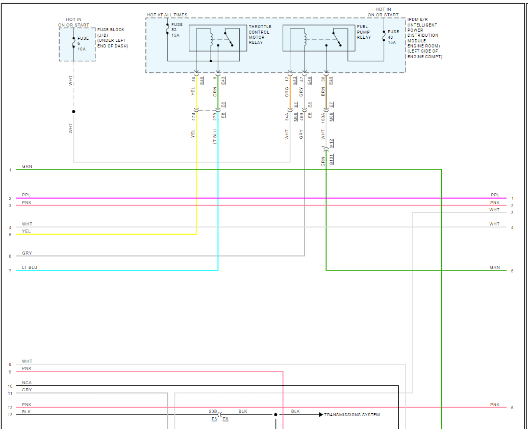

You could have a bad fuel pump but I have seen the IPDM go out in these cars which housing the non serviceable fuel pump relay. Here is how to change it out which would fix the problem. You can use a test light at the fuel pump feed wire (green) to confirm no power when you don't hear the fuel pump running.
Check out the images (below). Let us know what you find.
Jun 26, 2024 at 3:20 AM
MAROZ
  • 22 POSTS
I just checked the green wire and I have power(13.55) only when the engine is running. Whenever the key is turned to on without the engine running then there’s no power. Is that normal?
Jun 26, 2024 at 1:06 PM
MAROZ
  • 22 POSTS
This morning, I hooked up the tester to green wire and it ran for like 5 minutes with around 13.5v After the engine warmed up the power go to 0. I started the car again and the power goes back to 13.5v but after 5 seconds it goes to 0 (then the fuel stops and then the engine stalls). It used to be that I can drive it for 20 miles and then it shuts off and I can start it again and drive it. Looks like something is warmed up and fails. What else can I check or change? Tia
Jun 26, 2024 at 10:11 PM
  • 55,433 POSTS
It sounds like the IPDM is going out, you might be able to get a code for it if you do a CAN scan, please watch this video to see how:
https://youtu.be/InIlnsjOVFA?si=wyNwD-Mme8W-4vV3
Please go over this guide and get back to us.
Jun 27, 2024 at 3:09 AM
MAROZ
  • 22 POSTS
I just replaced ipdm with used one. No change. Car runs for few minutes and stalls. The power to the pump randomly stops. I have tester on the (green wire) pump and it’s 13.5v then it just drops to 0. I also have tester on the ipdm fuse and power is 14.4 v. Sometimes I can feel the relay klick when I hold the ipdm. The over on fuse never drops. The power on the pump does. Can the ecm/pcm be bad? Does it need to be reprogrammed? Tia

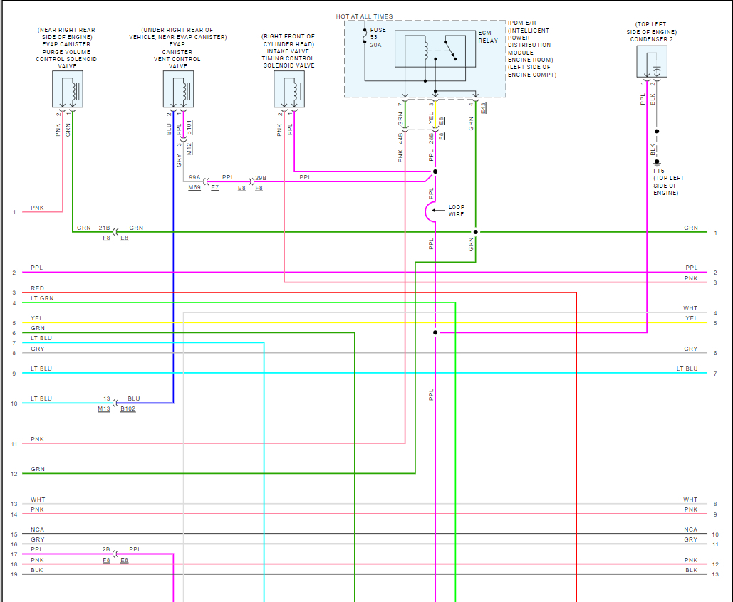

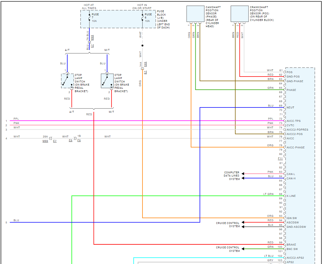

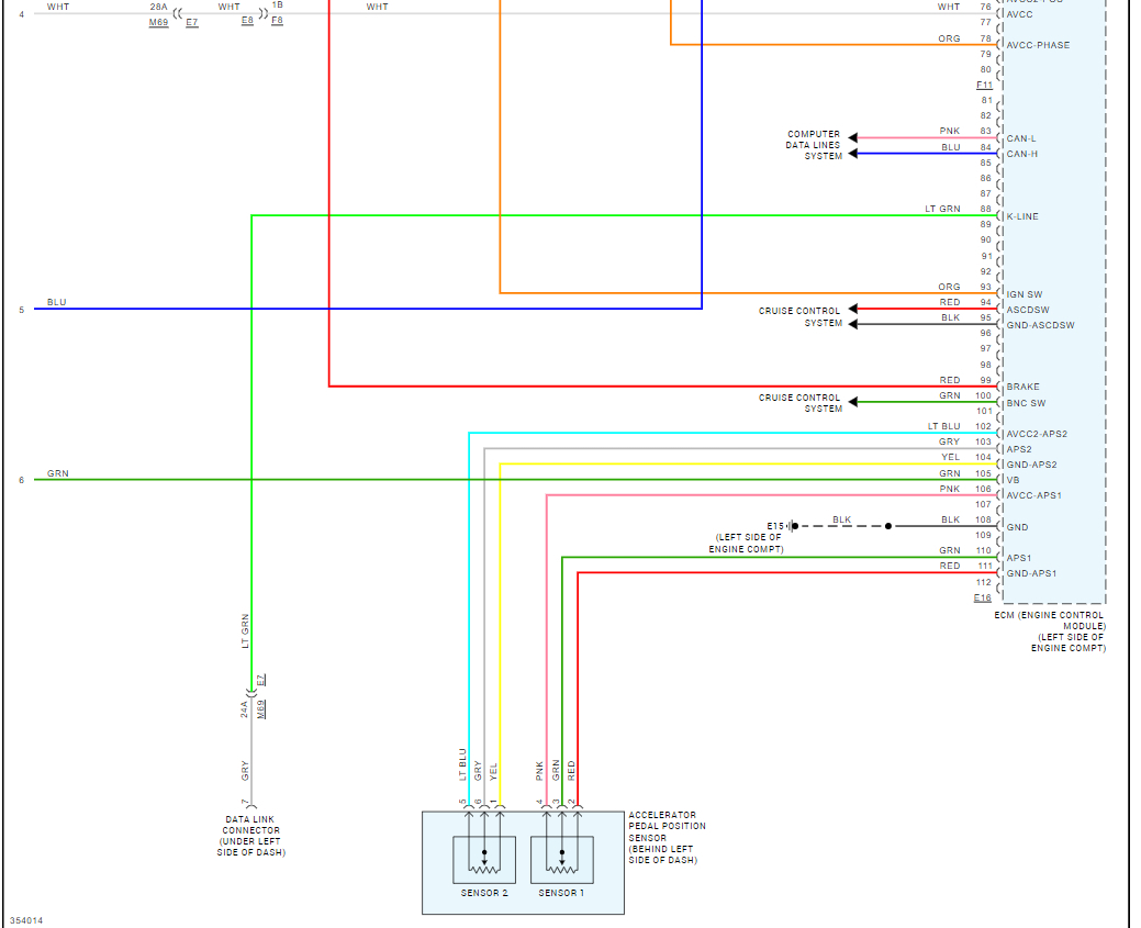

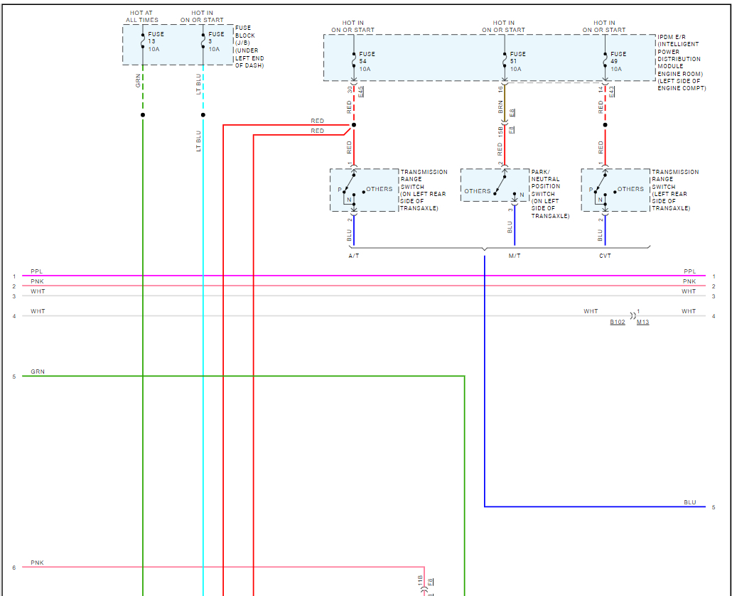

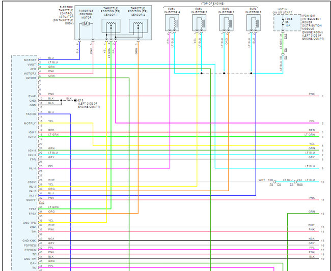

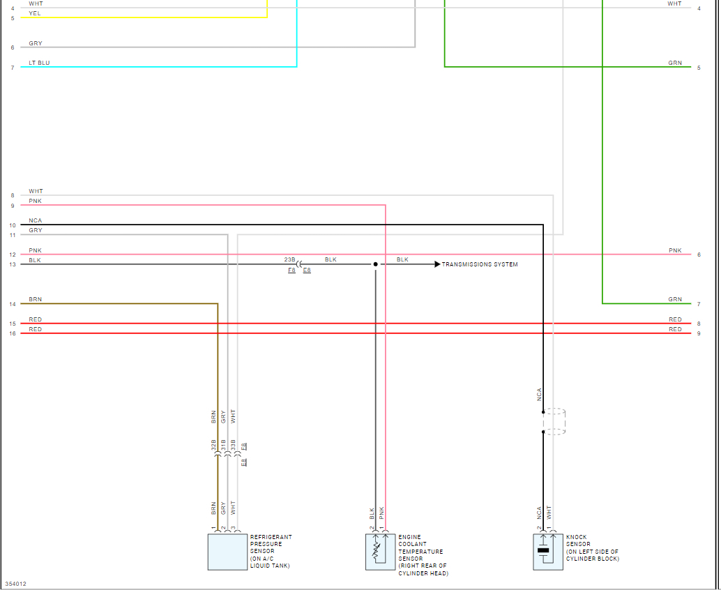

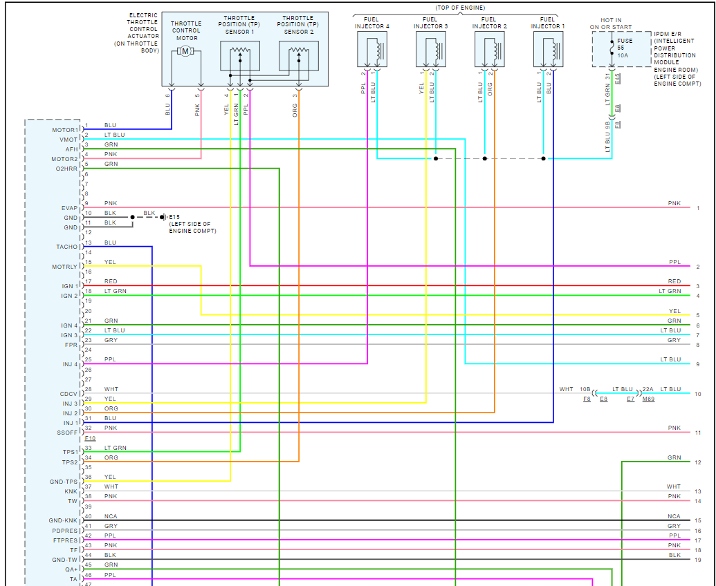

It could be but can I ask if you ran the CAN scan? It could be the ignition switch, or PCM. You can send the PCM for testing and they will go over it for you. It is difficult to test the PCM yourself if there are no codes. When you replaced the IPDM it came with different relays correct? Here are the engine and PCM wiring diagrams so you can see how the system works.
This guide will help you test the connections:

Seems like there’s something telling the computer to turn off the power to the fuel pump. I was able to drive it the whole day and now it won’t run more than 3 minutes in the driveway. Sometimes 1 minute, sometimes 2. I don’t think there is broken wire. I may be wrong but if there is broken wires then there won’t be any power at all going to the pump. Is it possible that the computer is going out or needs to be reprogrammed? Tia
Jun 28, 2024 at 10:20 AM
  • 55,433 POSTS
Yep, that is a possibility, you can remove the unit and send it in for testing. Please search google or ebay for a company that can do the work for you.

I guess I figured it out. I worked on it almost all day. Found out that it drops power at the IPDM (that was replaced with used one)
I ran on-off-on switch from the fuel pump up to the driver seat. Installed light on the ECM/IPDM side so I know when no power to fuel pump. Other wire ran from cigarette lighter to the 3way switch. Now when the light is off, I just flip switch to manual power. Light back on (ECM/IPDM) is working so I keep it on the normal working mode. So far, it’s been working fine. Tired of chasing ghosts. The car has only 33,000 miles on it, so I keep driving it as is.
