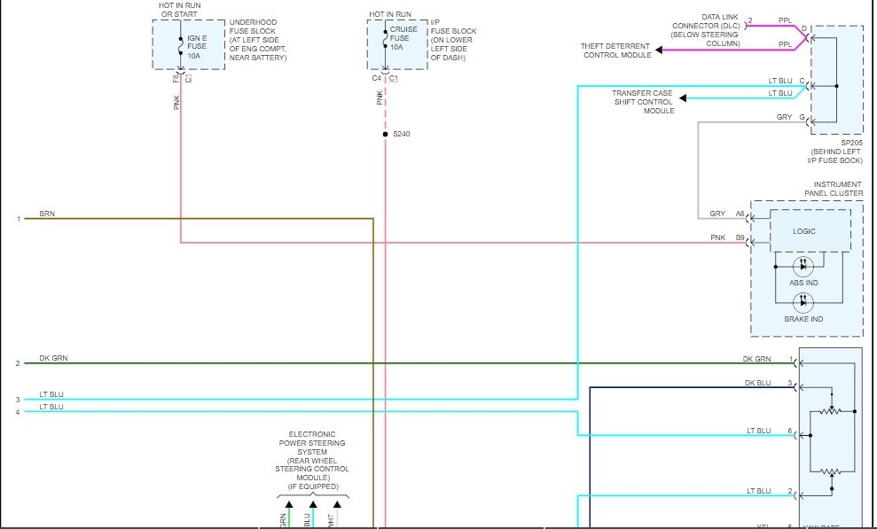

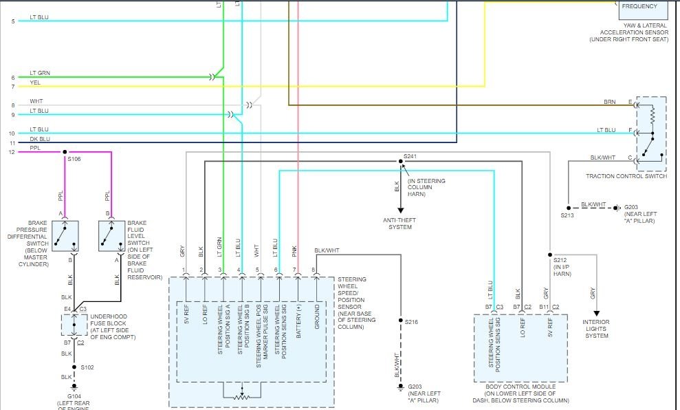

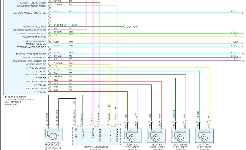

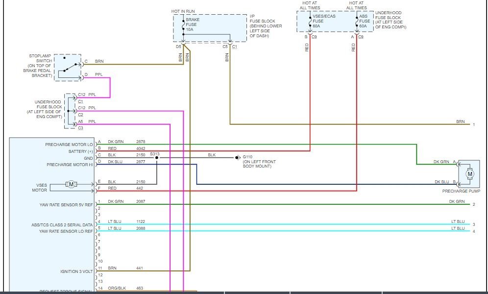

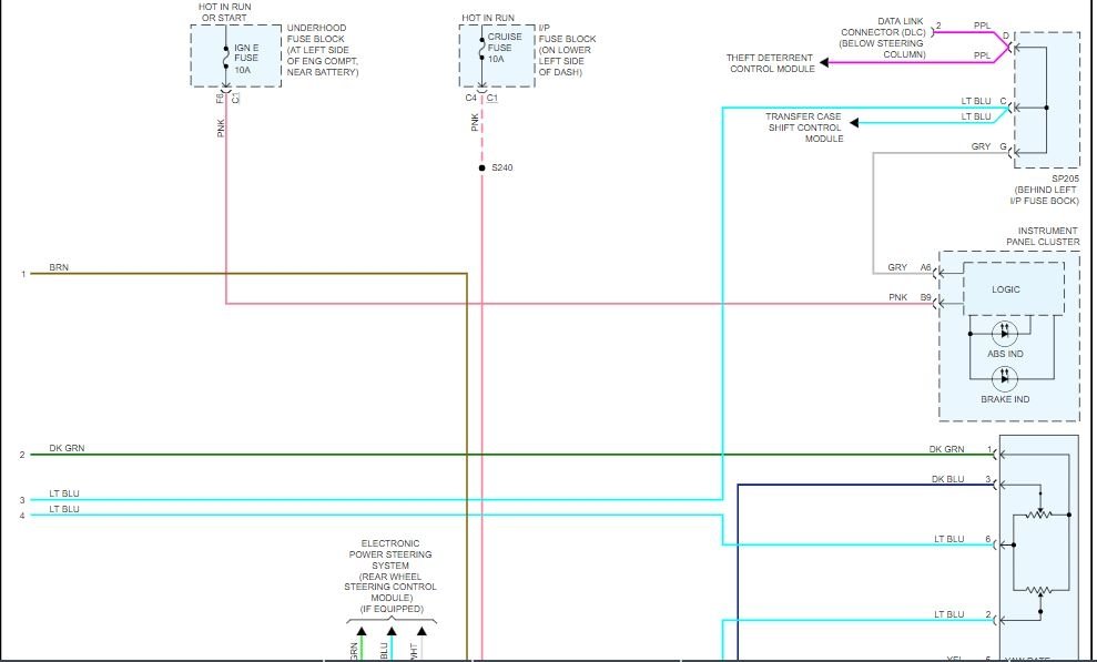

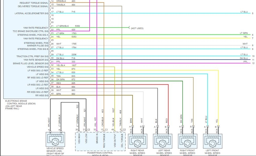

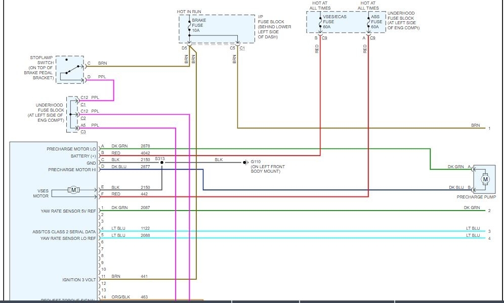

when i turn off the stable trak system on my truck, does it become 2 wheel drive?
Aug 22, 2019 at 5:16 PM
Okay, I posted the description of the system and how it works with ABS and traction control issues. When you disable that system, it disables traction control. When you disable the traction control, it will default to 2 wheel drive.
I attached the wiring diagram for the system as well. It will default to 2 wheel when there is an issue.

^ Wheel speed sensors (WSS) - As the wheels spin, toothed rings interrupt magnetic fields in the wheel speed sensors. This causes each wheel speed sensor to generate an AC signal. The EBCM uses these AC signals to calculate the wheel speed. Any imperfections in the toothed ring, such as a missing or damaged tooth, can cause an inaccurate WSS signal.
^ Traction control switch - VSES and the engine torque reduction function of TCS are manually disabled or enabled by pressing the traction control switch.
^ Lateral accelerometer - The EBCM uses the lateral accelerometer to determine the sideways acceleration of the vehicle. The lateral accelerometer is packaged with the yaw rate sensor as a single component.
^ Master cylinder pressure sensor - The master cylinder pressure sensor is located within the BPMV. The master cylinder pressure sensor uses a 5-volt reference and generates an output signal proportionate to the hydraulic fluid pressure which is present in the front brake circuit at the master cylinder.
^ Yaw rate sensor - The EBCM uses the yaw rate sensor to determine the rate of rotation along the vehicle's vertical axis. The yaw rate sensor is packaged with the lateral accelerometer as a single component.
^ Steering wheel position sensor - The electronic brake control module (EBCM) receives several inputs from the steering wheel position sensor. 3 digital square wave signal inputs are wired directly to the EBCM harness connector, however, only signals A and B are used or monitored. The failure of the index pulse signal does not effect VSES function. The body control module (BCM), which receives an analog steering position sensor input, transmits steering position data on the serial data line. The EBCM monitors the serial data information as an added fail-safe for the steering position sensor circuitry. Battery voltage is supplied to the digital portion of the steering wheel position sensor from the cruise control fuse. The analog portion of the steering wheel position sensor is supplied a 5-volt reference from the BCM. This circuit is also used for a lamp dimming function.
^ Precharge pump motor and pump - The precharge pump assembly is used to assist the ABS pump in rapidly building hydraulic pressure needed during certain TCS or VSES events.

Precharge Pump
The TCS and VSES are dependant on the precharge pump to assist the ABS pump in building hydraulic pressure to perform brake pressure application. This is because the passages from the master cylinder reservoir to the ABS pump inlet are restrictive, and do not supply adequate fluid to the ABS pump. The precharge pump is used mostly at the beginning of brake pressure applications since once some pressure is built, the ABS pump is usually able to continue building pressure and maintain the application. The precharge pump inlet is fed by a flexible hose which draws fluid directly from a port on the master cylinder reservoir. When the precharge pump is activated, fluid is pumped into the combination valve, slightly pressurizing the front and rear brake circuits between the master cylinder and the BPMV. It is important to note that during this time, the EBCM must isolate of the all wheels except for those to which the brake pressure application is directed. The portion of the pressurized fluid that is not drawn into the ABS pump inlet, passes through the bypass ports in the master cylinder and returns to the reservoir. Some of the pressurized fluid is supplied to the ABS pump inlet when the EBCM commands ON a supply valve in the BPMV. Since the fluid at the ABS pump inlet is slightly pressurized, the ABS pump is able to function with higher efficiency. The precharge pump, however, is not always used during TCS or VSES events due to the fact that the precharge pump motor must be protected from overheating. During a long series of brake pressure applications, the precharge pump may be disabled by the EBCM for up to 12 seconds. Although the driver may be able to detect a change in the vehicle stability during this time, the TCS and VSES do remain functional. No indication is given to the driver if the precharge pump is disabled due to overheating.

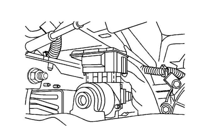

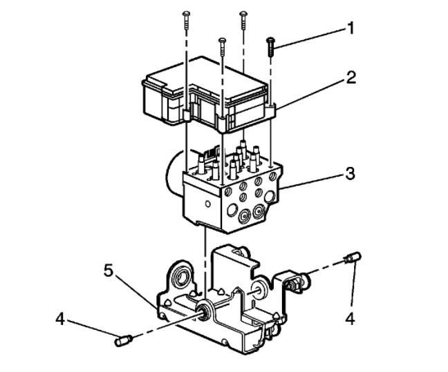

I attached the procedure of replacing the module for the ABS, TRAC, and Stable system for you.
Electronic Brake Control Module Replacement (w/ JL4)
Removal Procedure
Caution:
Important: After installation, calibrate the new EBCM to the tire size that is appropriate to the vehicle.
1. Disconnect the negative battery cable.
2. Raise and suitably support the vehicle.
3. Important: The area around the EHCU MUST be free from loose dirt to prevent contamination of disassembled ABS components.
Thoroughly wash all contaminants from around the EHCU.
4. Remove the mounting screws (1) that fasten the EBCM (2) to the BPMV (3).
5. Remove the EBCM from the BPMV. Removal may require a light amount of force.
6. Remove the EBCM from the vehicle.
7. Clean the BPMV to EBCM mounting surfaces with a clean cloth.
Installation Procedure
1. Important:
^ Do not reuse the old mounting screws. Always install new mounting screws with the new EBCM.
^ Do not use RTV or any other type of sealant on the EBCM gasket or mating surfaces.
Install the EBCM to the BPMV.
2. Notice: Refer to Fastener Notice in Service Precautions.
Install the new EBCM screws (1).
^ Tighten the screws to 5 Nm (39 inch lbs.) in an X-pattern.
3. Lower the vehicle.
4. Connect the negative battery cable.
5. Revise the tire calibration using the Scan Tool Tire Size Calibration function.
6. Return to Diagnostic Starting Point - Antilock Brake System.
