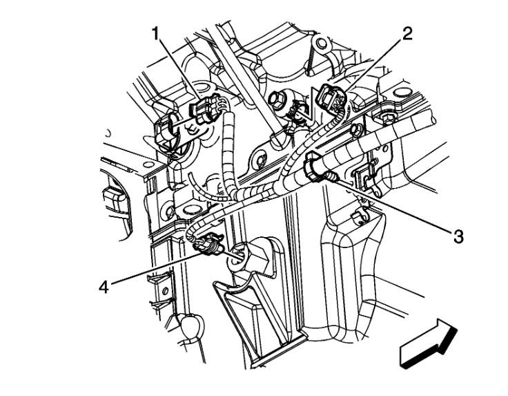

In the mornings or when ever the truck has been sitting for over a hour when you start the vehicle it turns over and over won't start. turn off ignition try it again it starts. then the tact's not working, the check engine light comes on as well as the stabilizer traction control light and it runs real rough. And just yesterday I started down the road everything was running fine no lights no nothing then all of a sudden it gave like a kick in the behind and everything comes back on. what do I do? Oh, I had AutoZone check code and it's PO335 but I had that changed in November.
Mar 8, 2019 at 9:06 PM
Good morning,
The code is for the crank sensor and does sound like the issue with starting.
I would start there and use one from the dealer, not aftermarket.
As far as the trac light, you need to pull the code for the ABS as the ABS module is what controls the traction control?
