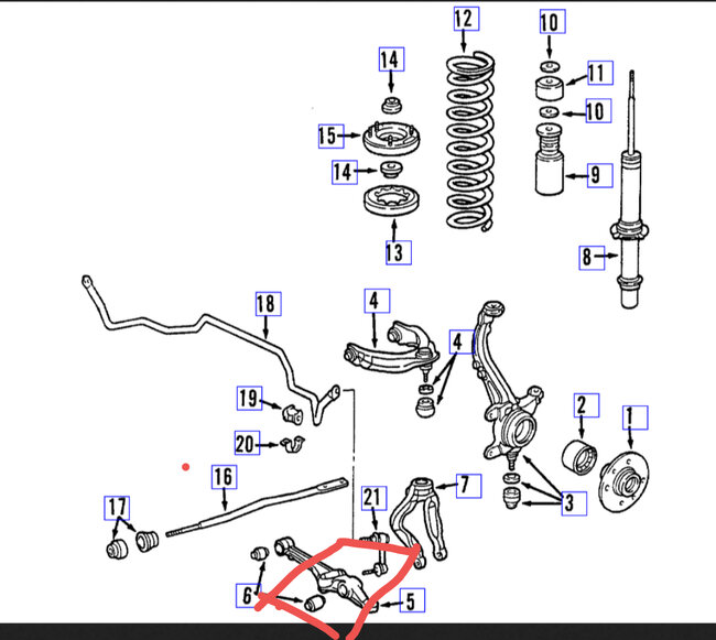

Thank you for your time. The problem I'm running into is the lower bolt of the link I can't get a wrench on the bolt because of the lower control arm and it's also pretty rusted. Can I use a cutting tool to get it out or is there something I am missing?
Dec 21, 2022 at 5:37 PM
  • 55,766 POSTS
Nope that is a problem, you must be able to hold the link mount, or it will just turn. I have seen people apply pressure to reseat the taper which will hold the link joint from turning, this would be easiest instead of cutting. You can use vise grips, C clamp or channel locks. Let me know.

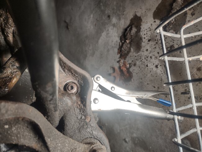

Here is what I'm dealing with sorry for the delay....
Dec 24, 2022 at 8:50 AM
  • 55,766 POSTS
No problem, thanks for the image, I see the vise grips which I assume are attached to the bottom of the link. I would use an impact gun to remove the nut. If that doesn't work, please upload more images so I can see better of what's going on.
