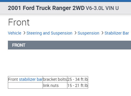

What is the specified torque value for the front stabilizer bar end links?
Also, the OE end links are made with plastic/polyurethane bushings while many aftermarket brands have rubber bushings. Would the torque specification be different for end links with rubber bushings considering the compression of the rubber?
Aug 9, 2023 at 6:15 AM
  • 110,244 POSTS
The torque specifications remain the same for either design. As far as the specifications are concerned, I attached what I have in my manual. See pic below.
Let me know if that helps or if you have other questions.
joe
See pic below.

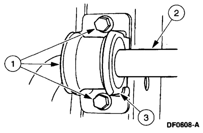

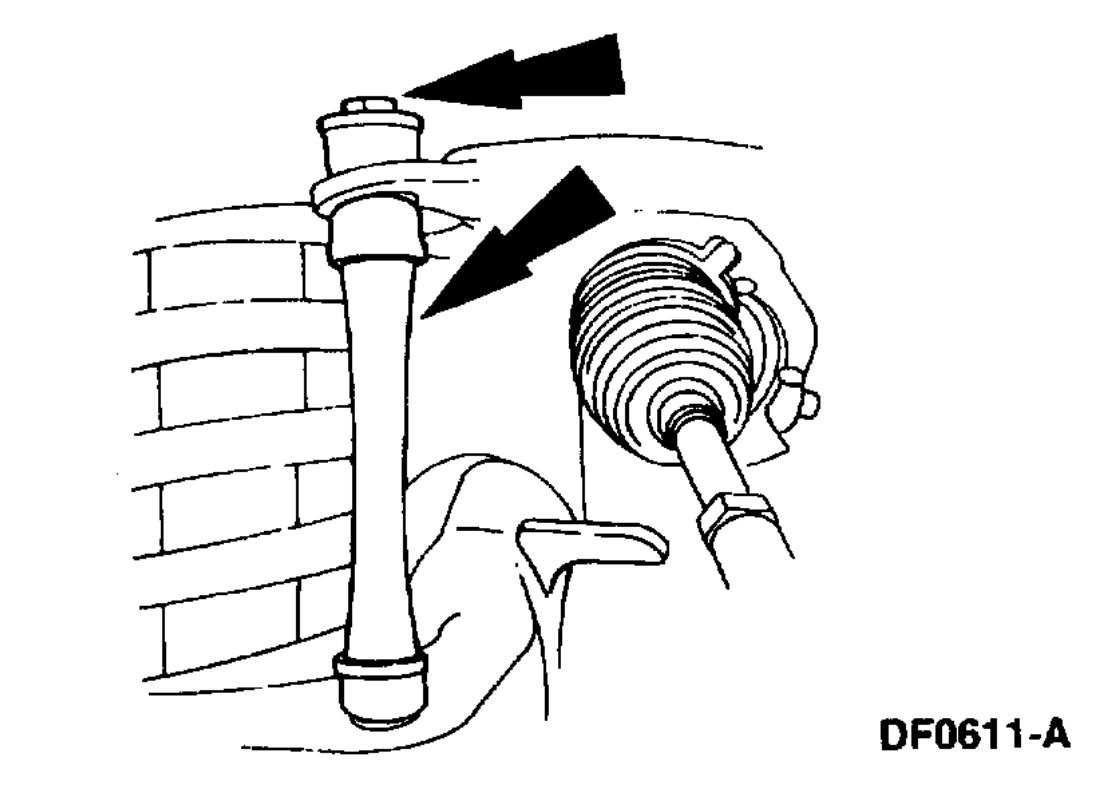

The stabilizer links can be torqued with the vehicle raised. The torque for the end links is 21 ft/lbs, and the torque for the stabilizer bar bracket bolts is 34 ft/lbs.
I will attach the procedure for stabilizer link and bar removal below.
Thanks for using 2Carpros!
William
Removal
1. Raise the vehicle on a hoist.
2. Remove the wheel and tire assembly.
3. Remove the front stabilizer bar link nuts from the front suspension lower arms.
(See image 1)
4. Remove the front stabilizer bar link bolts and the front stabilizer bar links.
(See image 2)
5. Remove the front stabilizer bar. (See image 3)
1 Remove the four bolts and two brackets.
2 Remove the front stabilizer bar.
3 Remove the stabilizer bar insulator.
