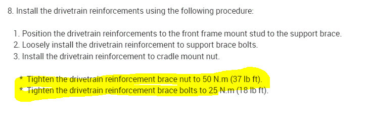

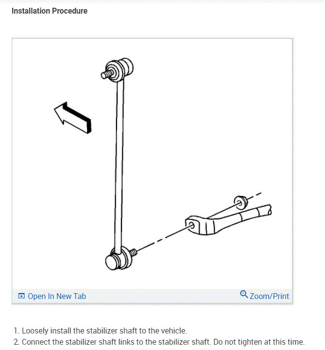

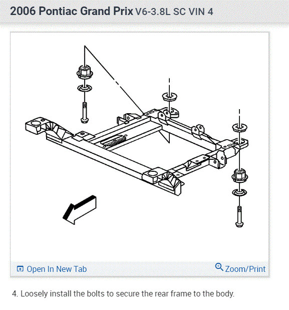

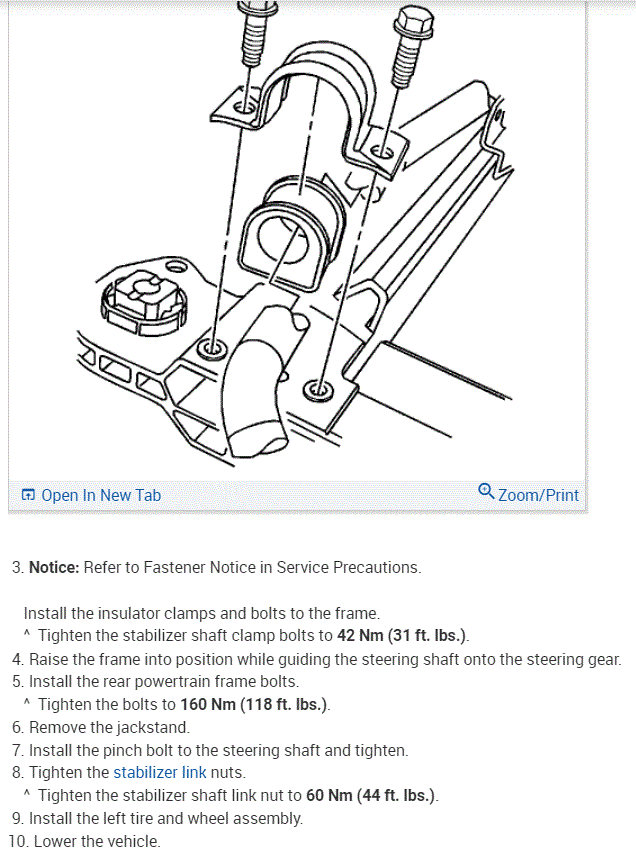

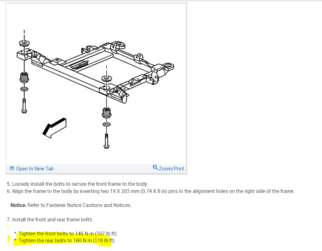

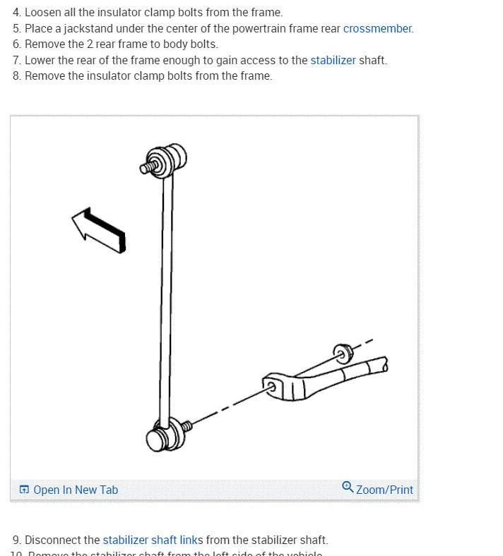

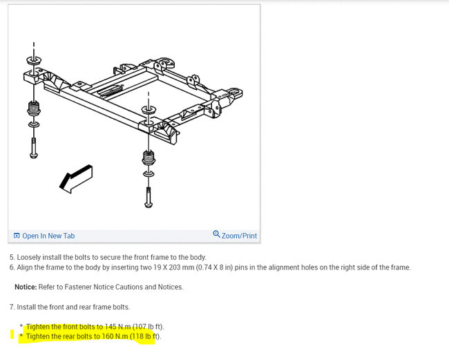

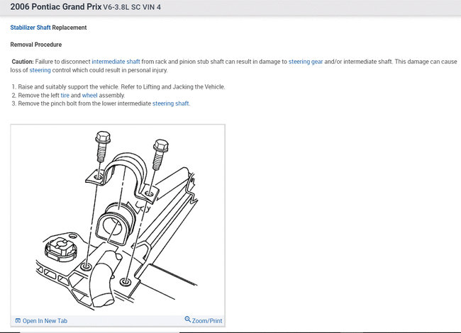

What's the stabilizer bar torque specification? Also, the sub frame bolts torque specification?
May 1, 2022 at 3:53 AM
  • 110,248 POSTS
It sounds like you have your hands full. As far as the stabilizer is concerned, I attached the information for removal and replacement of the bushings which includes the torque specs. As far as the sub-frame, the last three pics are related to that procedure. The torque specs are also included.
