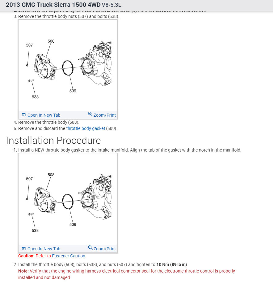

stability track light on disconnected battery overnight truck worked fine no light on, then after driving for 5 minutes or less light back on and truck in limp mode or I guess you can call it where it has no speed/acceleration.

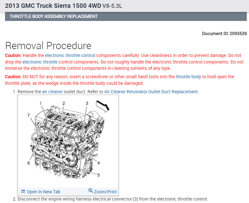

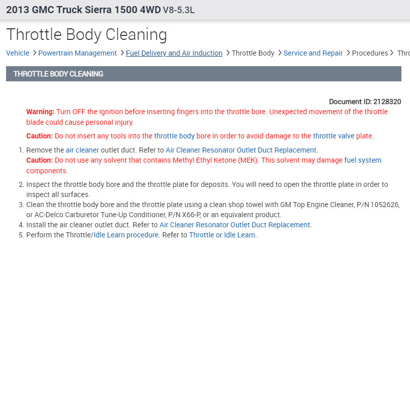

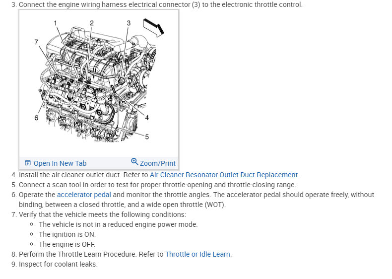

One of the most common causes for these trucks to go to limp mode is having a dirty throttle actuator.
Dirty or a malfunctioning actuator will be unable to send correct data to the ECM. That will make the ECM trigger the limp mode or low power mode.
https://www.2carpros.com/articles/reduced-power-limp-mode
So, cleaning out the throttle actuator is a good place to start.
