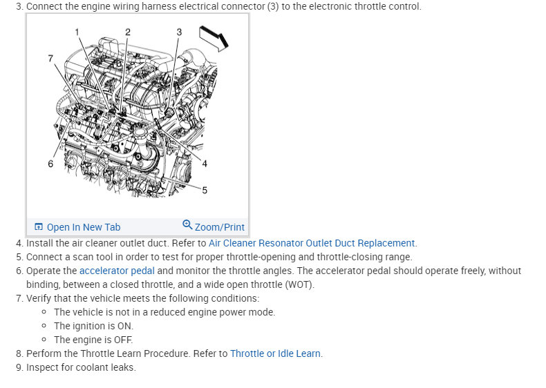

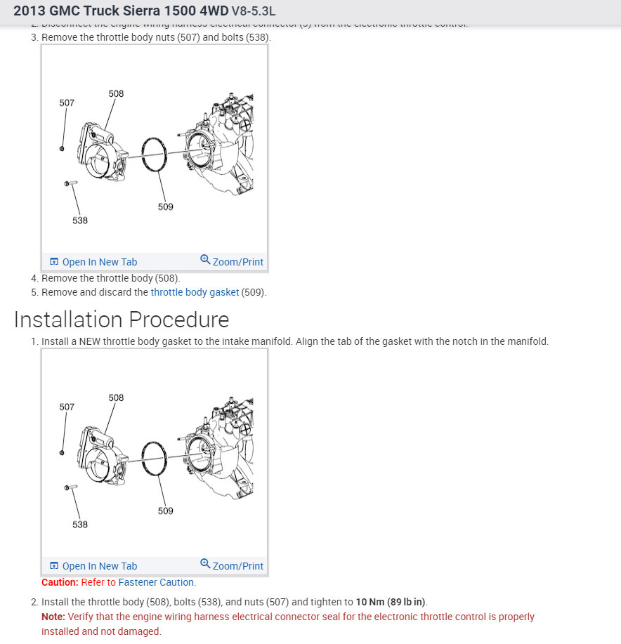

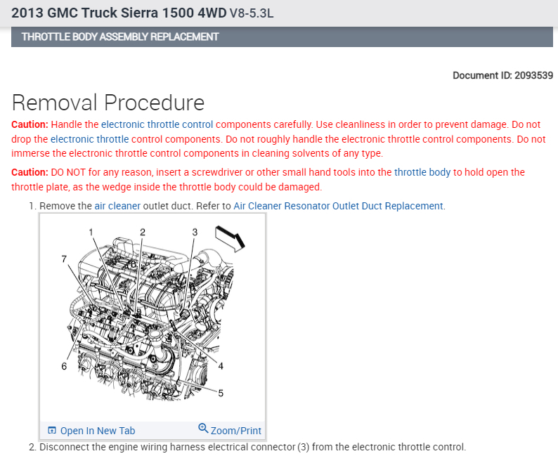

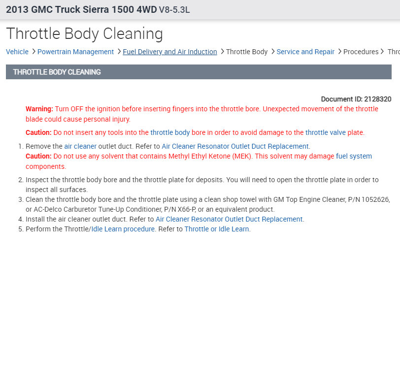

One of the most common causes for these trucks to go to limp mode is having a dirty throttle actuator.
Dirty or a malfunctioning actuator will be unable to send correct data to the ECM. That will make the ECM trigger the limp mode or low power mode.
https://www.2carpros.com/articles/reduced-power-limp-mode
So, cleaning out the throttle actuator is a good place to start.
