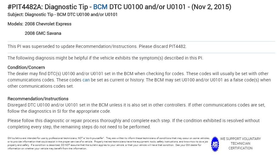

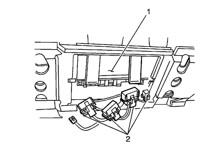

U101 is the code that's coming up.
Feb 27, 2020 at 11:40 PM
Okay, this is for the body control module. This module will control all the issues that are current.
Most likely you will be replacing it. It is a module that must be programmed.
