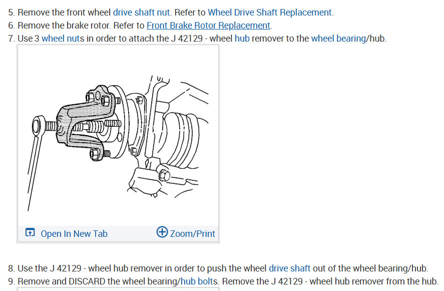

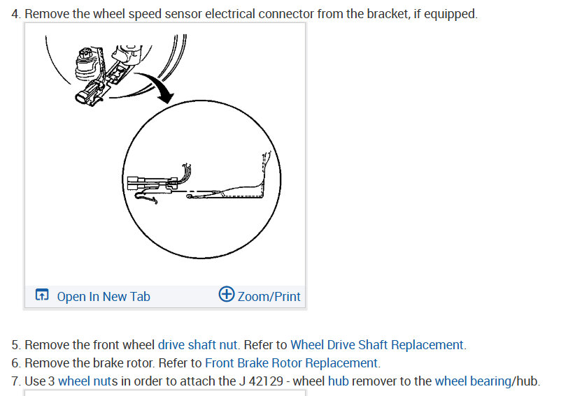

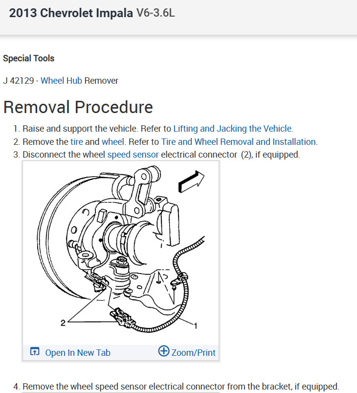

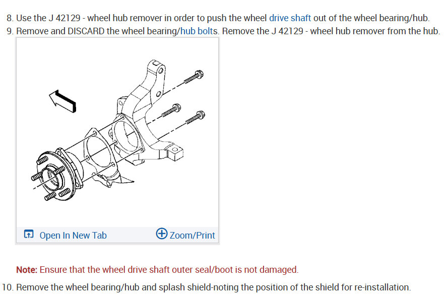

It sounds like you have a bad bearing hub or a wheel speed sensor, it is best to get a scan done to see which wheel is having the issue, also does the car make a humming noise while driving? This is a sign a bearing hub is going bad. Here is a guide so you can see what needs to be done:
https://www.youtube.com/watch?v=Pb6nXV-iamI
The sensor is inside the bearing hub FYI, here is how to change it out. Check out the images (below). Please let us know what happens.

Yes, the instructions on how to replace the wheel speed sensor are in the first post, you will need to replace the hub which the sensor is inside of. Let me know if you need help.
